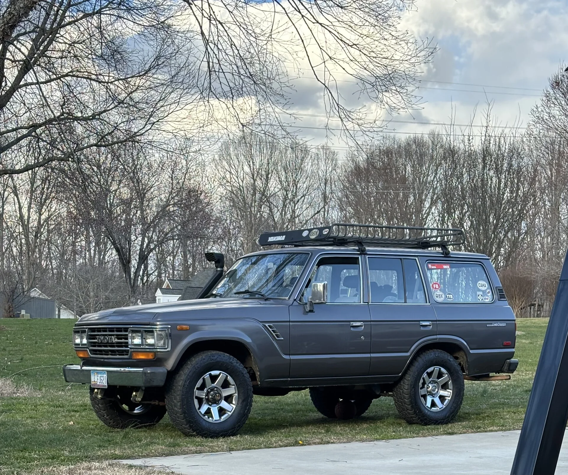

Been doing some research lately and could not find much info or pics of guys putting updated aluminum factory wheels on cruisers specifically 60/62 series. So I found the style I liked and went with them and turned out great in my opinion. I did have to use a 1inch wheel spacer up front to clear the tie rod at full lock left. Not an huge fan of spacers but with what I use the cruiser for primarily it will be fine. Everything worked out great. What’s everyone’s thoughts on them good or bad.
Depending on brand of spacers you will be fine. I wheel all over the USA with some on my 80. Puts more stress on wheel bearings and other stuff but nothing too bad.
I have run spacers on the 45 for last 10+ years. Not ideal but check torque at next rotation or two and go enjoy the ride.
Some say blue loctite. I did not use and have still had no issues.
