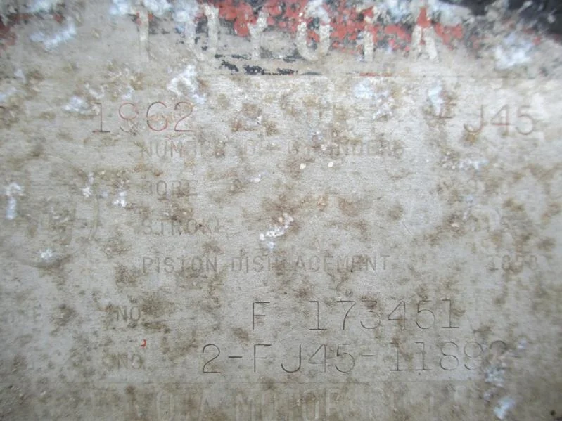

1. Vin tag: 1962 FJ45
Engine number: F 173451
Frame number: 2 - FJ45 - 11892

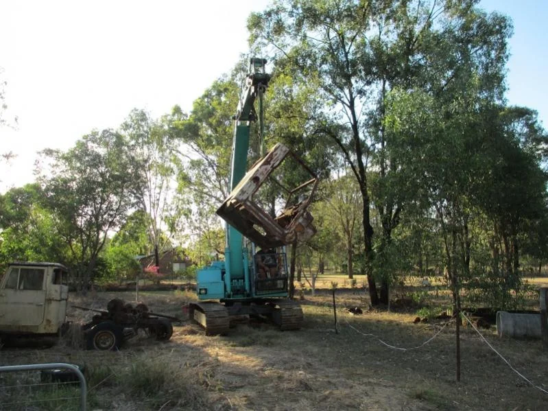

2. How it was loaded onto my trailer - pretty damn heavy with that good thick steel tub. I wish I could have saved the other 45 there too but it was a done deal. Still lots of good parts I could have used for this one. :frown:

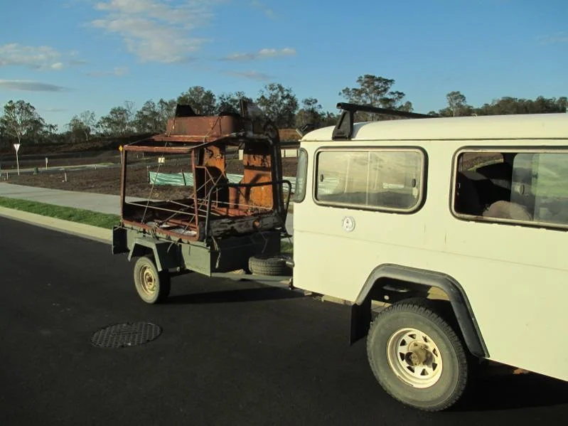

3. Ready to roll for the trip home.

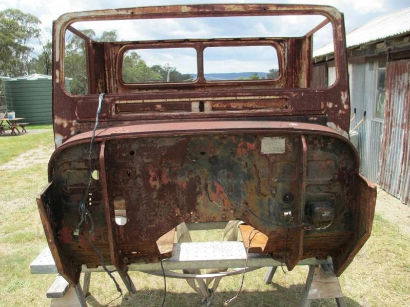

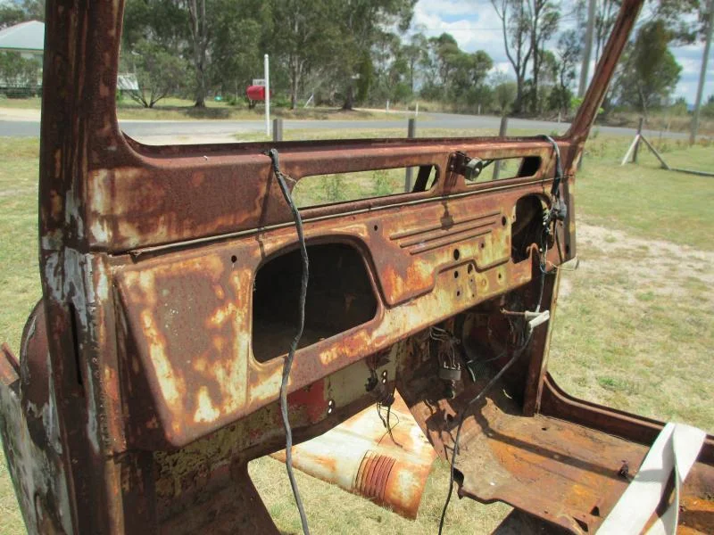

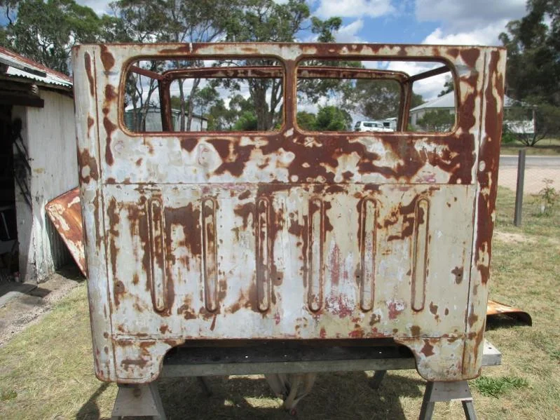

Some shots of the cab itself. I'm loving the split rear window. :cool:
Note the one piece windscreen and cowl with no bracket or hinge.

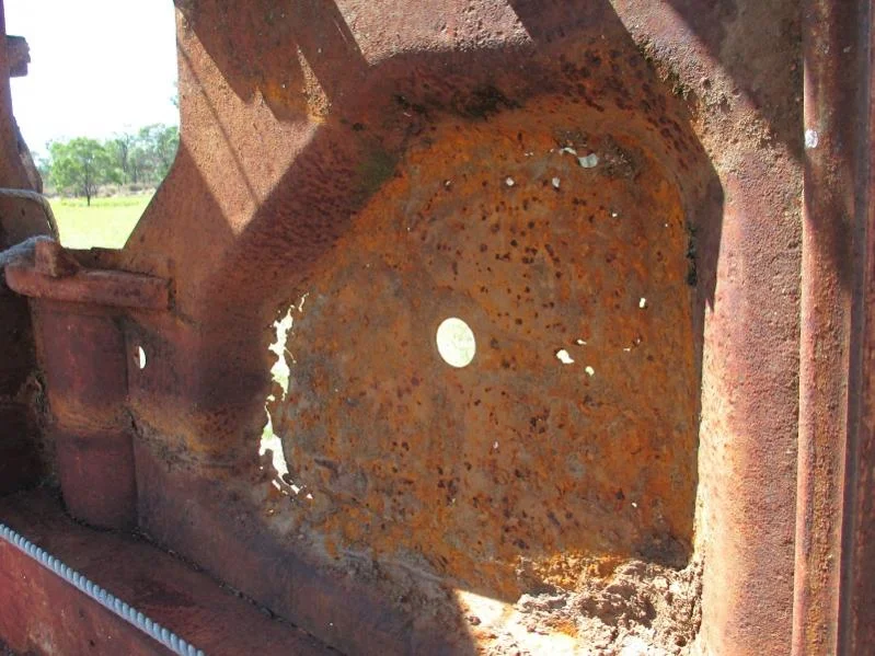

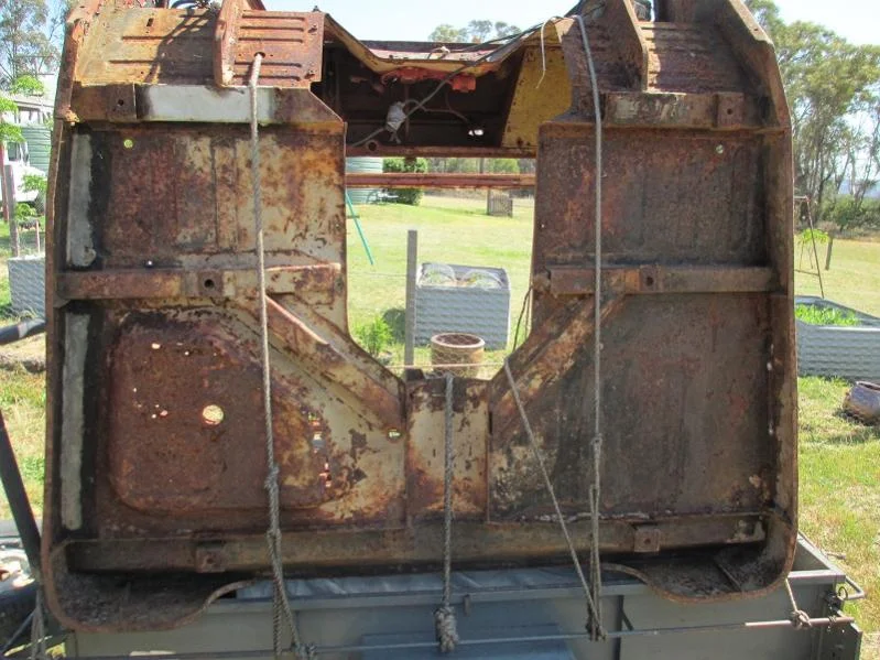

Underside of cab. This will be the most problematic part. The worst of it is the drivers side floorpan. Sitting on the dirt did her no favours. :crybaby:

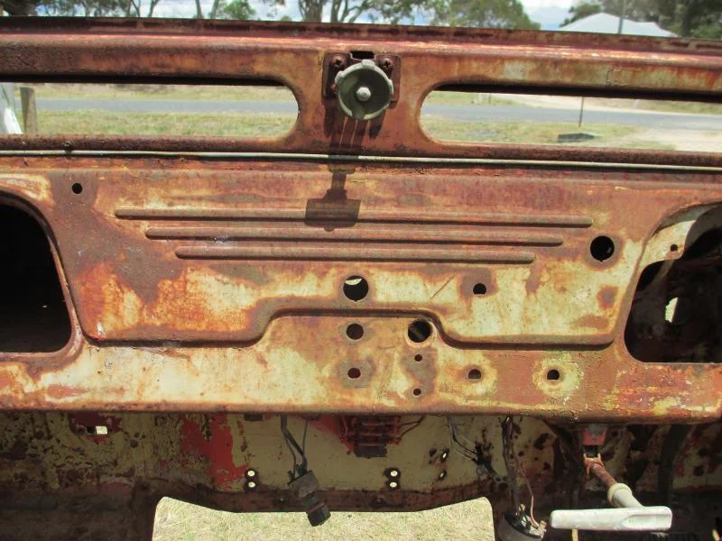

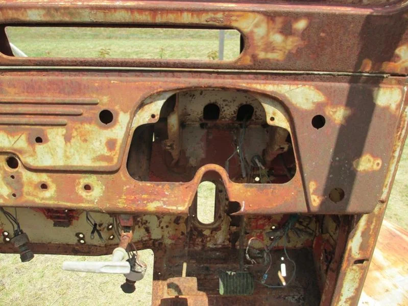

Dash: Uncut and in good shape. :)
I just need to figure out what goes in what hole....

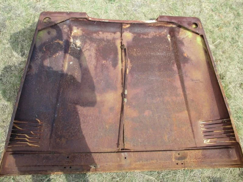

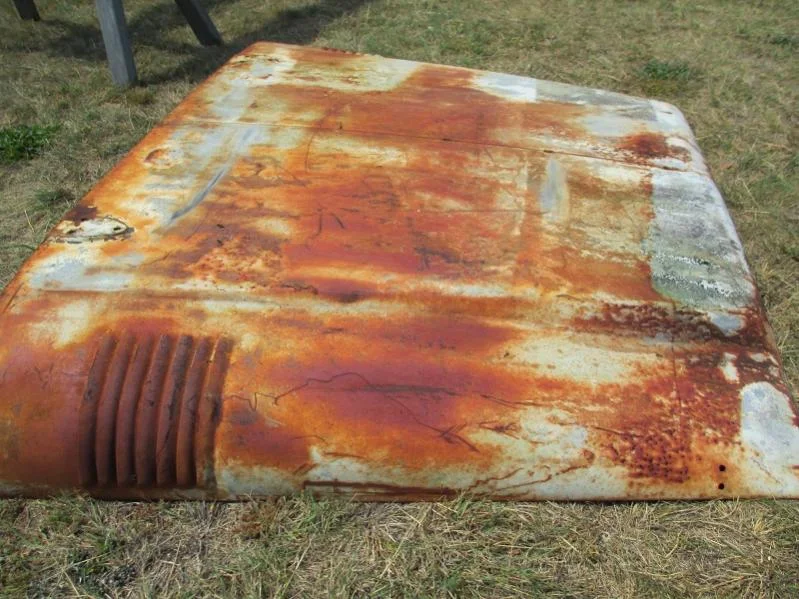

Bonnet/hood: In good straight shape with surface rust.
Note the lack of mounting holes for windscreen stop rubbers and latches. The windscreen doesn't fold down on this one.

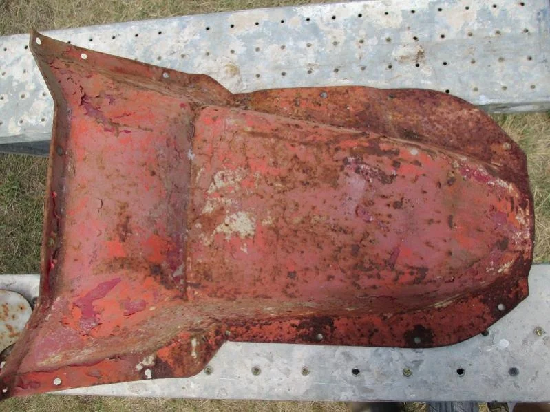

1. Tunnel cover. Note the lack of a cut out makes this truck a three on the tree.

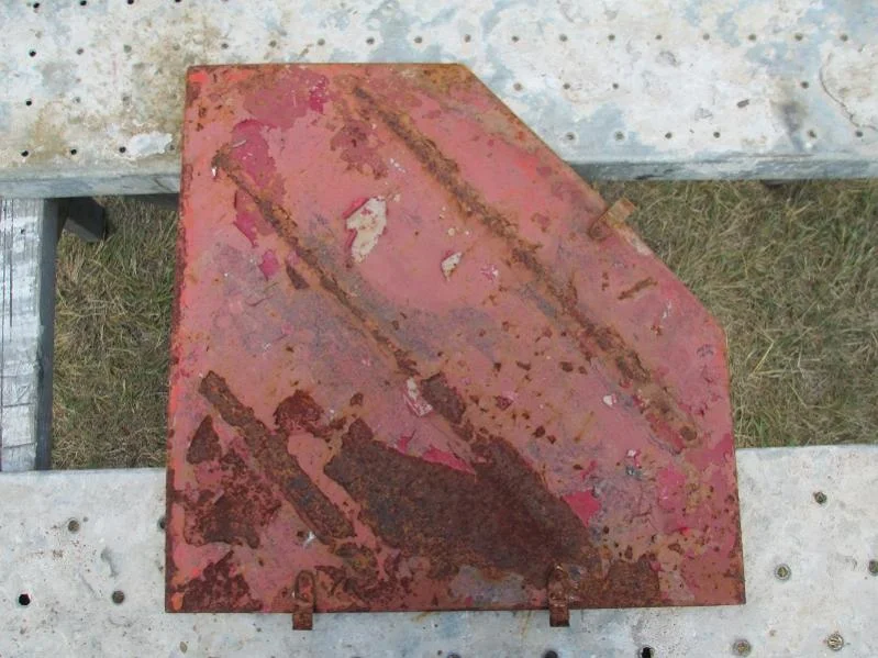

2. Underseat tool box lid.

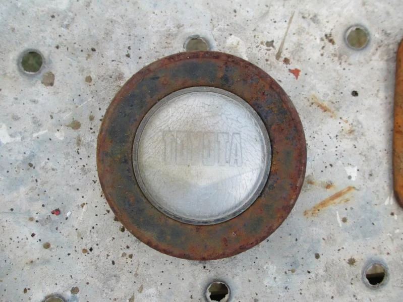

3. Steering wheel centre. There is no wheel but at least I now know which wheel is correct!

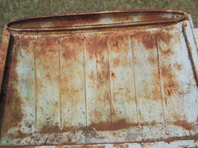

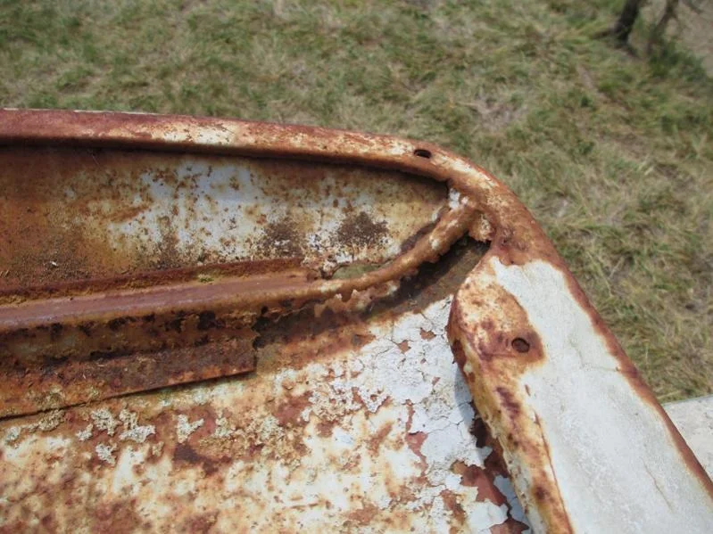

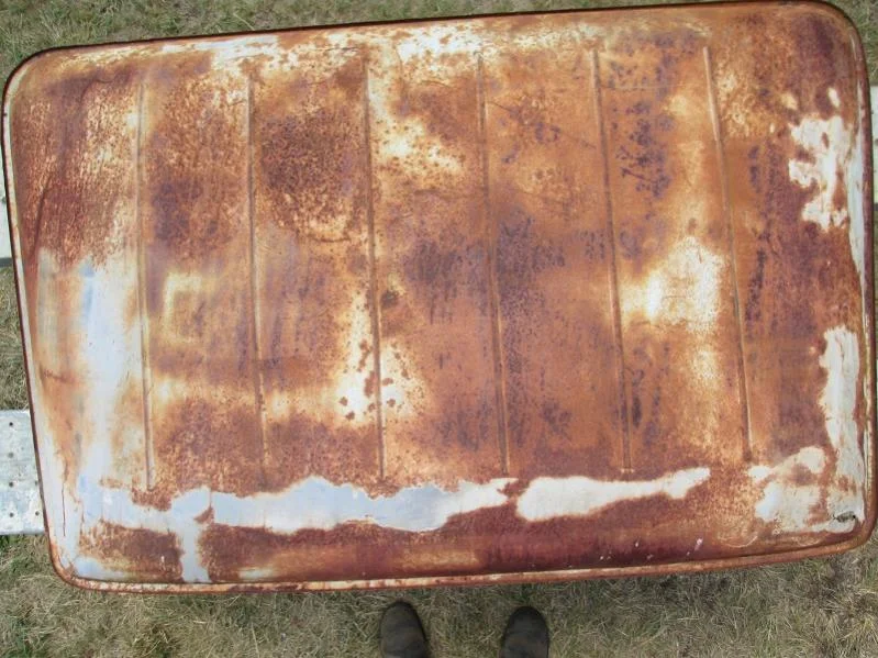

Roof/lid: Not bad condition. 3rd pic shows the worst part.

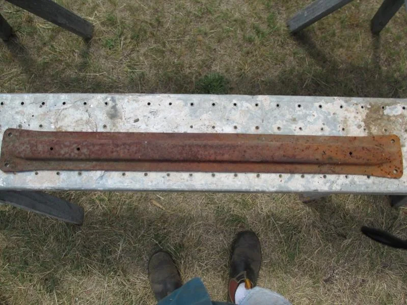

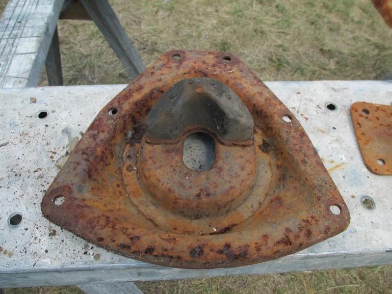

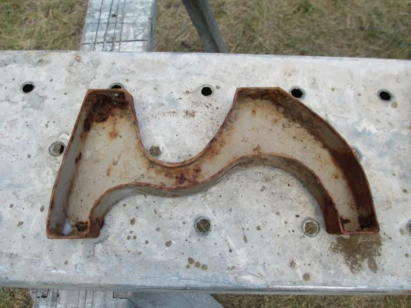

Some mystery items: Any ideas?
that is pretty cool......top mystery appears to be a rear frame spanner, second is a behind the dash bracket for the e-brake pull, don't recognize the 3rd one?

Thanks. 3rd one may not even belong???

the last picture is where the steering colum goes through on the floor

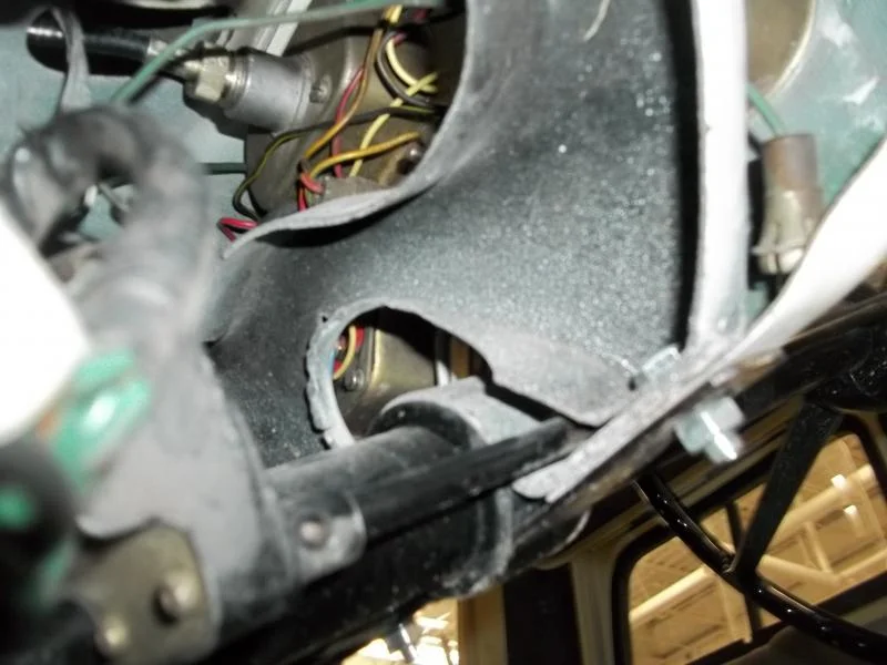

Nice cab,please double check the windshield hinge area, could someone have done some welding and filling? Seccond part is the steering collumn support mount, 3rd is not a firewall mont for the collumn.
I am sure about the windscreen hinge area. It is welded but it is factory. I have seen three or four other 62 era FJ45s on the web with this same feature.
Spot on with the column support! It all fits.
Not for that truck, anyway.
Part #2
This pic shows that bracket perfectly. I also have that little hoop part that fits snug over the top of the column so now I know about that one too. :)
