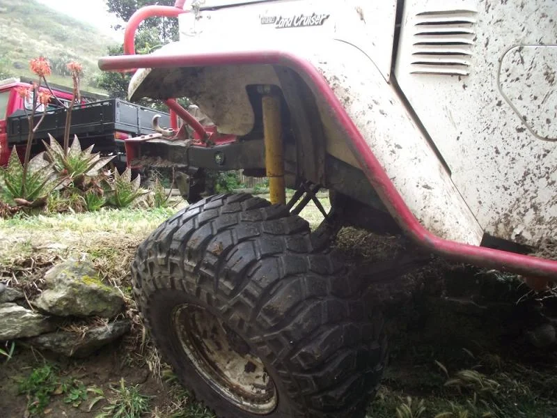

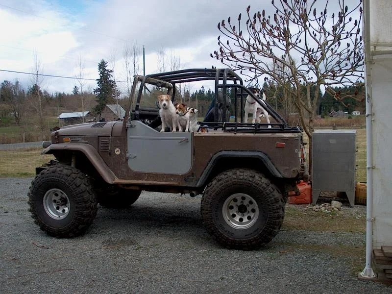

I put 60 series springs on the rear of my 40, they are about 4" longer. It effectively moved the axle back about 2". For looks, it seems better to me as I always thought the rear tire too close to the body, (and I run 38.5" TSL/SX's on SOA.) even with SUA set-up. I left the front spring hanger stock, but I punched out the rivets on the rear and just flipped the hanger around, lined up the holes and welded it back on. I have nice shackle angle at the rear and a much better ride/flex.
I don't have any close up pics, just this one of the pack waiting to go for a walk.

Did you manage to take a few measurements of centre of wheel/centre of opening before and after the spring swap? I take it with the size of your rubber you have trimmed the tub substantially? The wheel definately looks centered in your wheel opening!

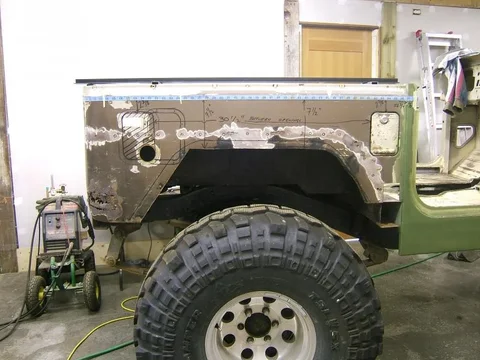

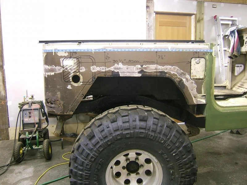

The leading edge of the wheel opening is stock. Those are the Bushwacker flares. I cut 1" along the top, and it goes to about 2" off the rear of the wheel well opening. Really not that much of removal of metal.
I am really happy with the axle position.
I have a photo from the restoration here showing the cut without the flares. Now the black sharpie pen line is the outline of the bushwacker flare that I removed.
As you can see the front edge is stock quite a ways up, and then I made a fairly crude straight cut for the flares. If you notice, the fender flare line is just below the exposed spot welds. I guess one day I should do a thread on this whole thing. I cut the front edge of the rear fender off to get at the spar, I wanted to see inside it for rust, but that whole piece was stock in shape.

Still was 1 1/2" of material left above the tire. It looks a lot larger of an opening than it was.
If you see, I wrote the measurements on the tub, you can copy them and mark it on yours for comparison.

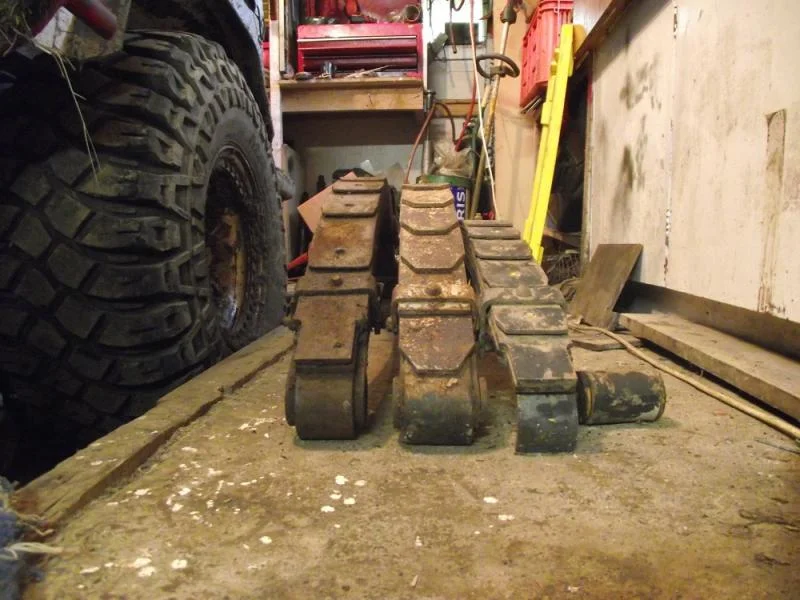

I don't know what the extra length worked out according to some spec's I found on the net my 70 series springs should have been 15mm longer than stock 40 series springs, you can see the difference in the 3 different sets of front springs I've used
1st pic, left= 70 series old man emu, middle= lovell, right= 40 series old man emu,
2nd pic, top= 40 series old man emu, middle= lovell, bottom= 70 series old man emu

Looks like the Lovells springs are re-arched 40 series springs - you certainly lost a lot of length "eye to eye" in order to get the height increase!
The 70 series springs look like the perfect option if you want extra height without sacrificing spring length!
From the photos it looks like the "unloaded" 70 series springs are about 1.5" to 2" higher than the standard 40 series springs. Do you know how much lift you got from the 70 series compared to stock?
I'm starting to think this would be the best option for the front! it'd be good to know what the shackle eye to pin and pin to fixed eye distances are! Did you take out any leaves from the 70s packs when you installed them?
