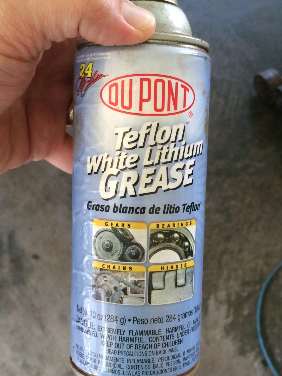

I squirted this stuff between the friction points in the leaves. It has really cut down the clunking noises that the OME's make when they shift around.
If you lift the whole front and let the axle droop, the leaves separate for easy lube access.
