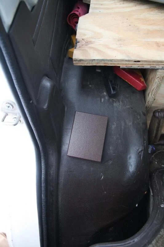

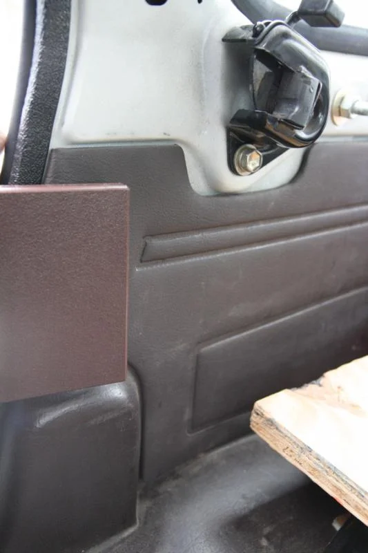

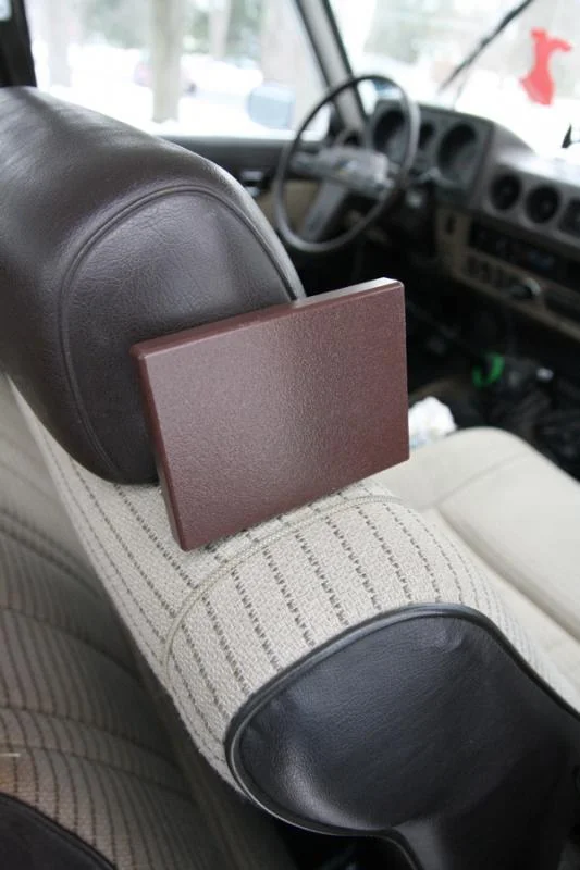

Finally have a couple of new things for everyone to check out, for everyone who was asking about the possibility of some brown plastic, I was able to get some photos of the plastic sample in comparison to the OE brown vinyl.
(thanks to Johnny for bringing his truck by, messy as it was:cool:)

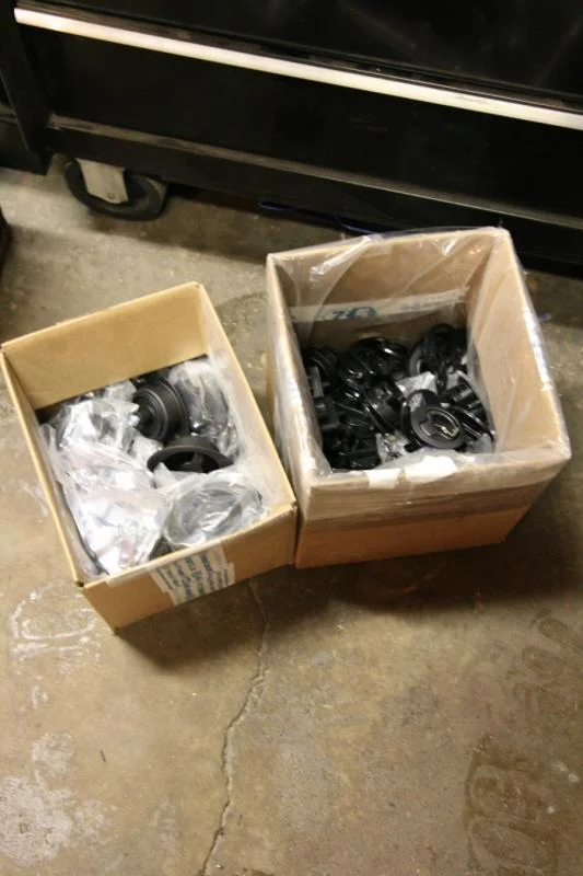

Anyway, look at the mess you guys have got me into:
These boxes of hardware cost more than my cruiser.

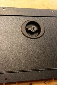

I've been sorting out the latches and what will work. I have the locking and non-locking cams here and have been putting them in lids.
Unfortunately a straight swap between the plastic push to close latches and the cam latches is not possible.
The hole size is different between the two latches, the hole could be made larger to accommodate the cam latches, but unfortunately as I lay out the new latches, the mount hole is actually in a different location, further into the lid, so the hole from the push to close latches would not be incorporated into the new hole.
To put a set of cam latches into an existing lid, I would need the plastic part of the lid removed and sent back to me so I can copy it and make a new lid the same size with the appropriate mount holes. I could then send the new plastic back with the new latches installed. The problem with that scenario is that the new plastic, the new latches and the shipping would cost close to what a set of the SS latches cost.
The SS latches do fit directly into the original mount holes, and are very slick, but the actual lock mechanism is very basic.
In your case Hector, I was looking at just providing you with a separate lock cylinder to mount in your lid since security was your concern, now that the latches you have are an issue, it changes the options quite a bit.
This photo should make more sense of it, the marker line is the hole for the original latch, the template has the hole for the cam latch, you can see how much further back the cam hole is.
