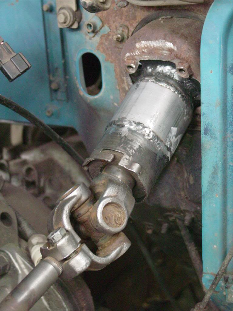

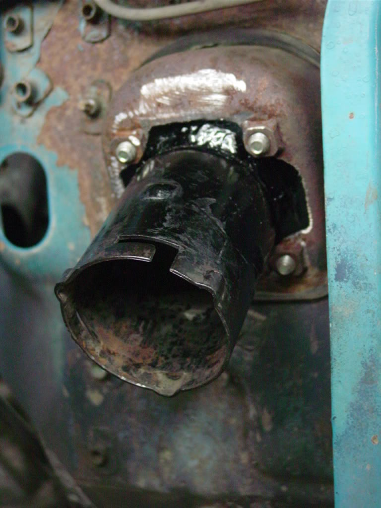

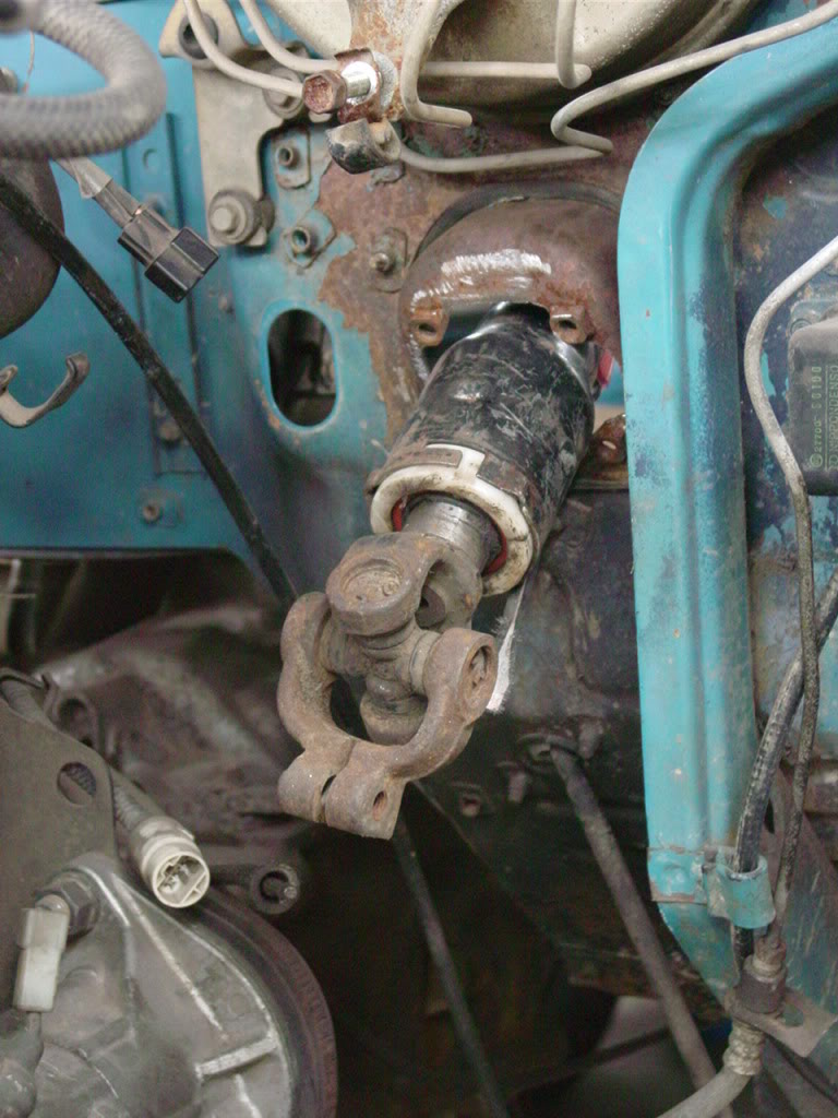

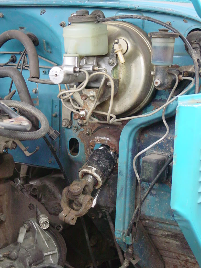

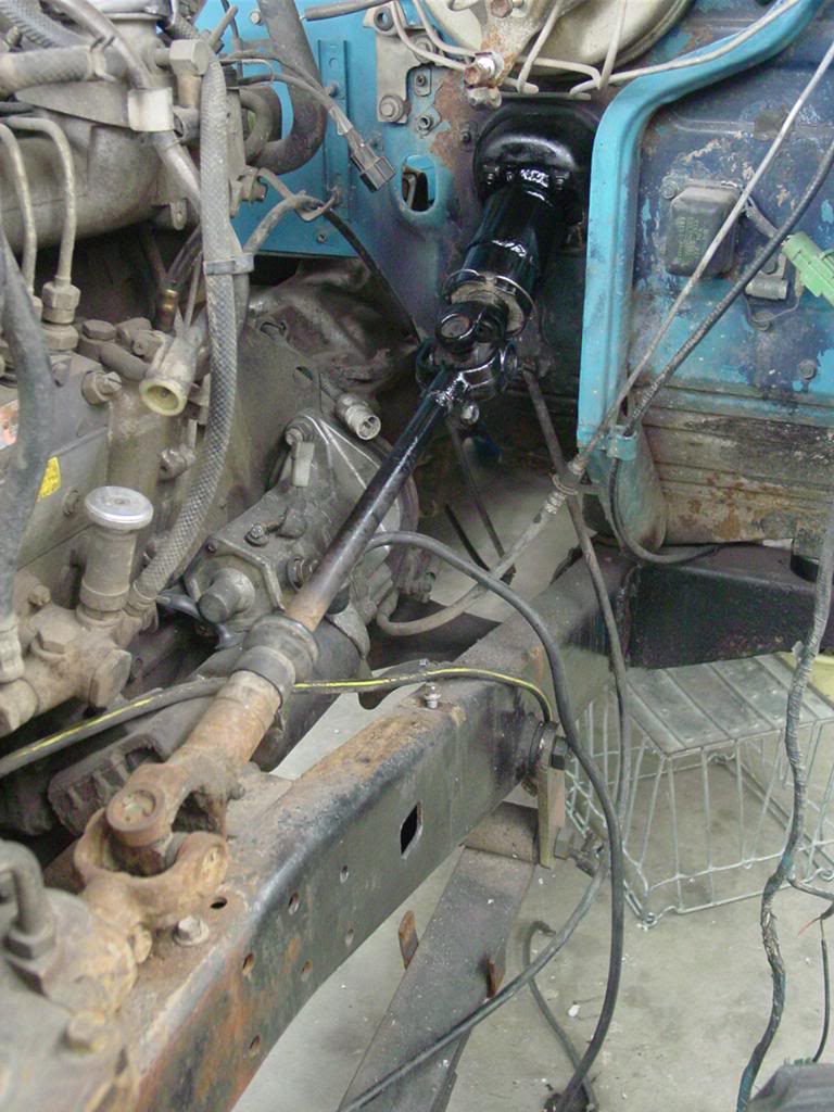

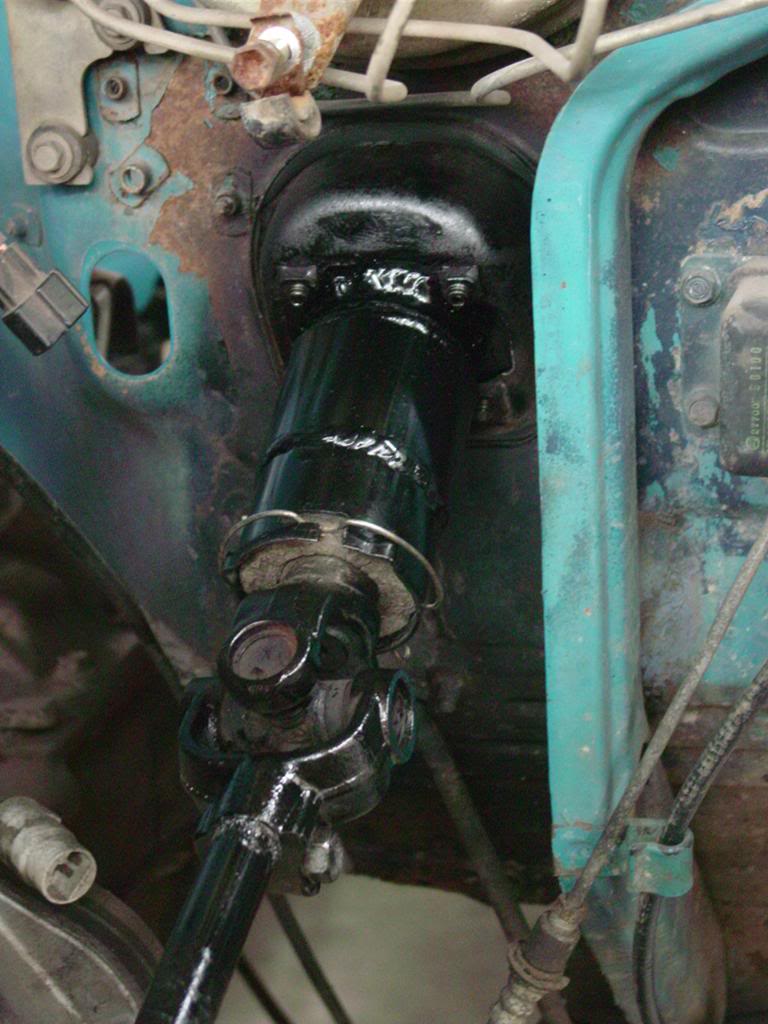

the "pocket" that gets bolted to the fire wall had to get the inside enlarged so the end of the steering column could get through.. the final hole ended up being cut around all 4 welded nuts in the pocket and resembled a cross.. this was so not only could i get the end of the steering column shaft through the hole but the u-joint from the column.. everything just squeeks through..
here is a little closer pic..

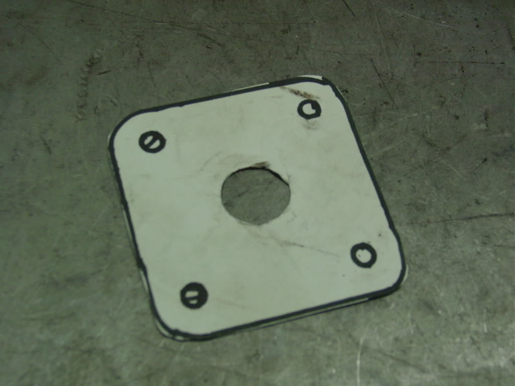

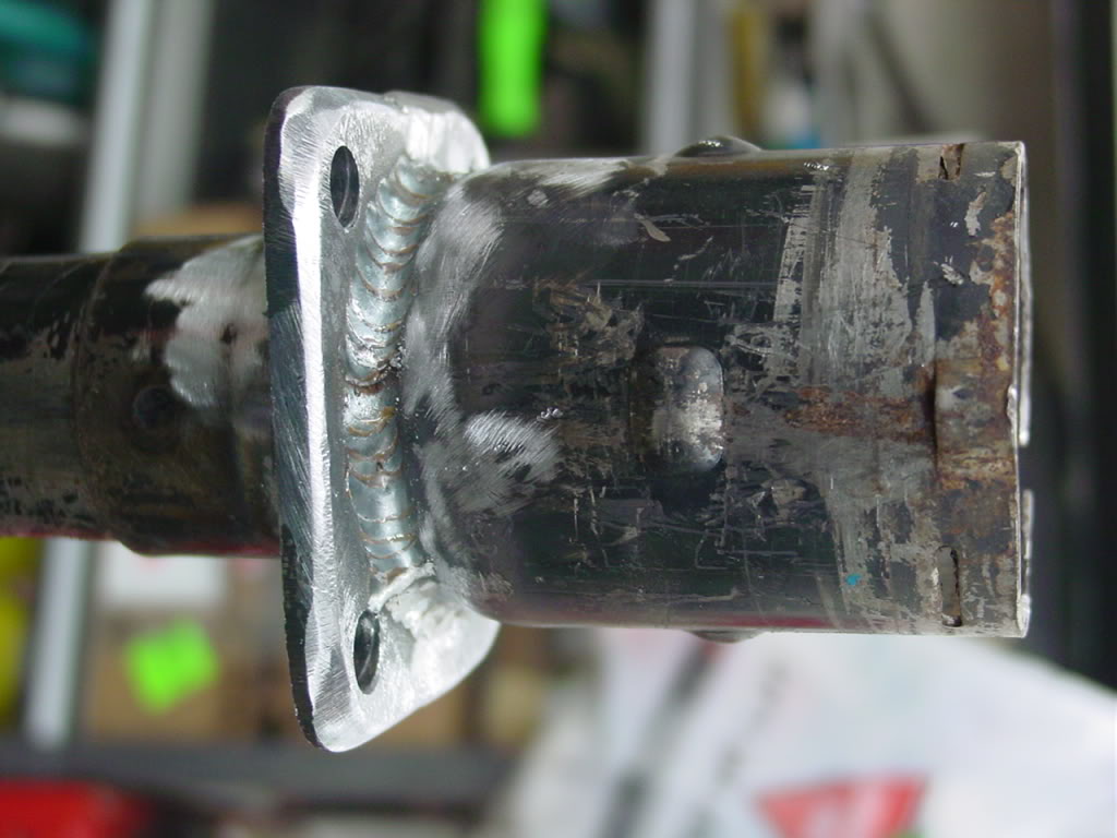

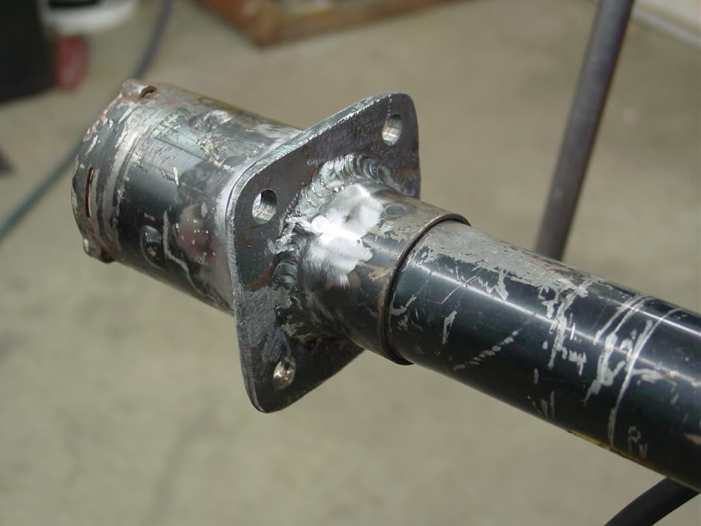

this is the template that i made using the base from the original steering column.. this will be the plate that gets welded to the end of the 60 series column..

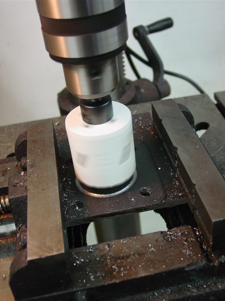

this is the plate being built.. the 4 holes i think were drilled to 3/8's and the center hole was 2 inches..

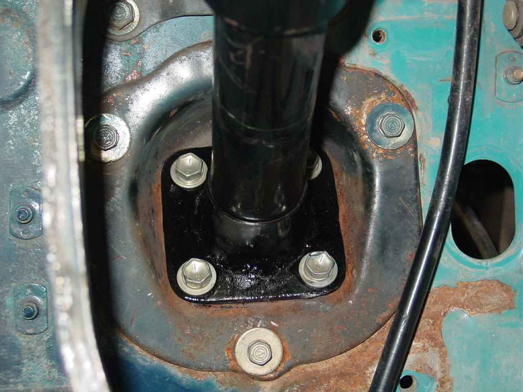

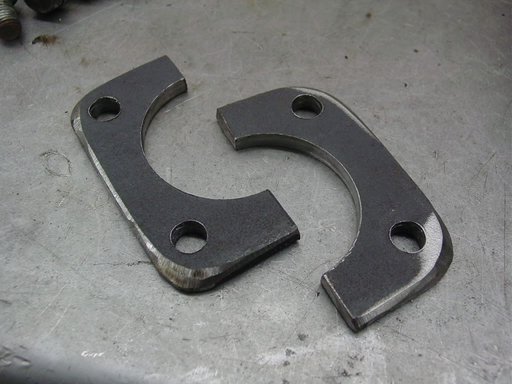

this is the final product built.. i had to cut it in half so i could get it around the steering column end.. from here i put the 60 series column to where it looked like it would work and installed the two halves around the column shaft in the firewall pocket..

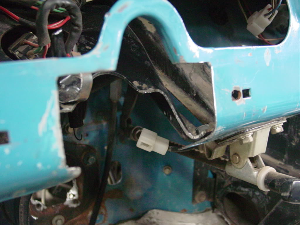

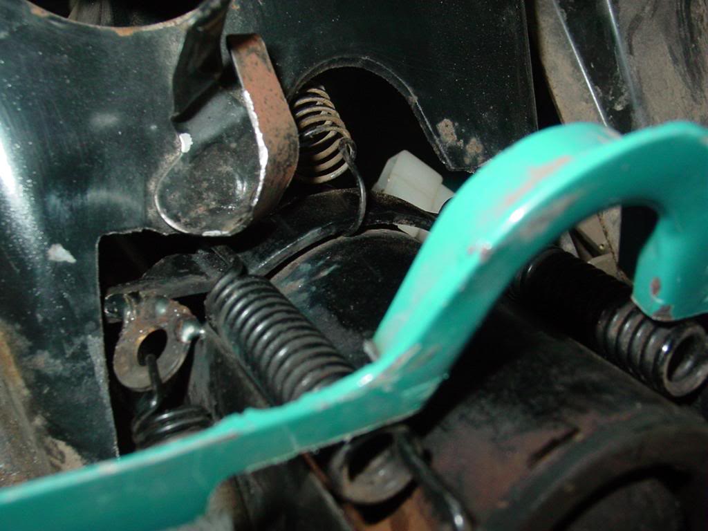

i will have to get a pic of what the steering column looked like before.. where the springs for the tilt column mechanism hook up, the whole area had a lot of excess metal that flared out making it tough to put into the stock colomn location in the firewall.. a lot of trimming was done to make this work and then that cross brace was rewelded.. this is a very much needed step to make this work.. this cross piece will also serve as a mount for the brake pedal return spring.. the original mounting hole was cut off when i enlarged the column mounting bracket..

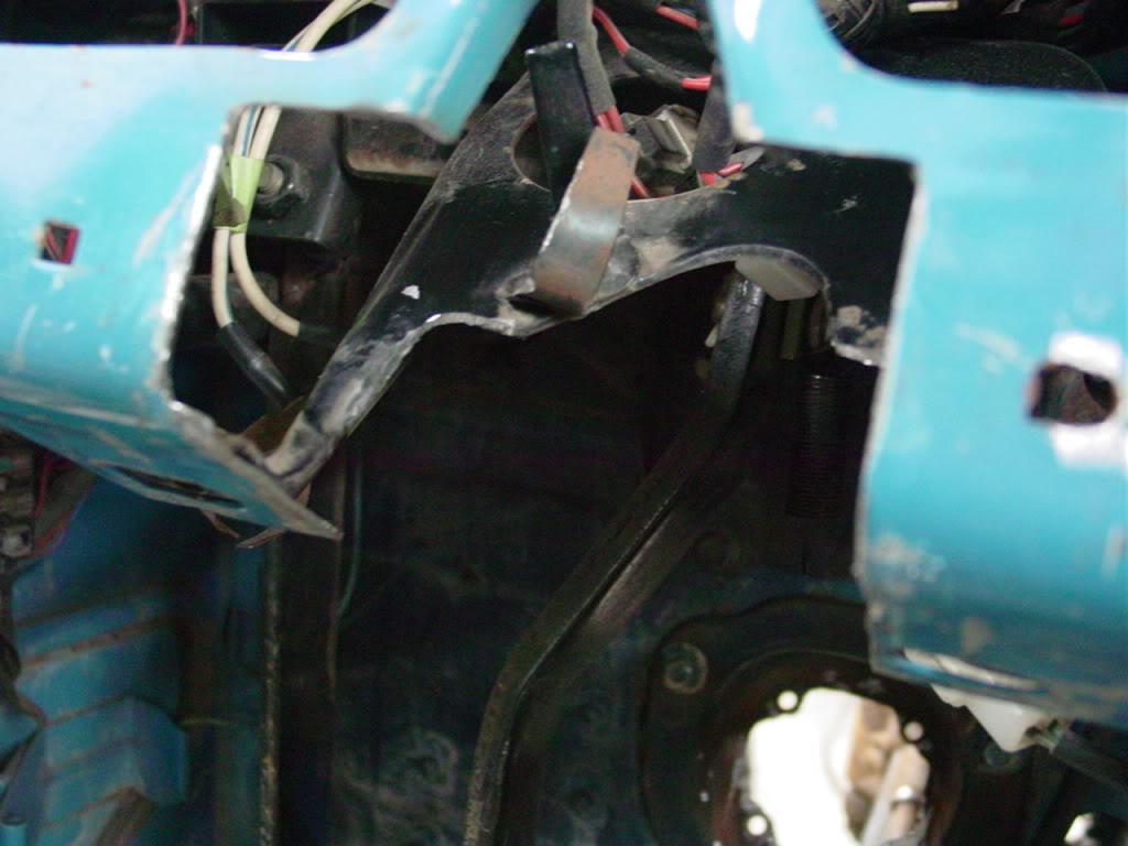

you can see how much i had to cut out of the column support based on the shiny grinded metal.. i wasnt pleased with how low the column was sitting under the dash so i cut and trimmed in small doses till i was able to get it up enough to where it was in the stock columns location.. sorry, no before photos..

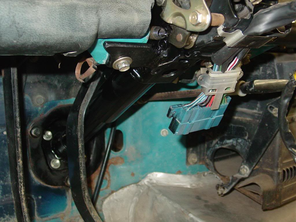

and here it is bolted up in its home.. i still have to sand blast and paint all the associated parts but i am still just test fitting everything at this point..
and one more from the inside.. although it doesnt look like much, its been a pain in the butt to get to this point.. i think that column has been in and out of the truck over 40 times..

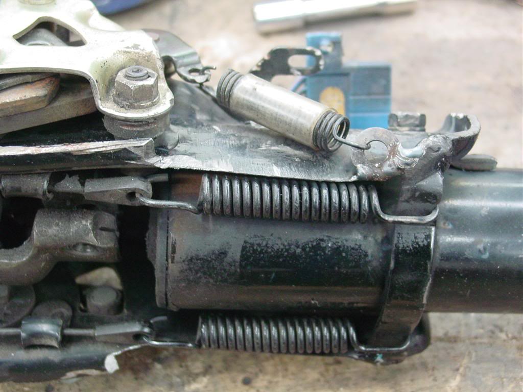

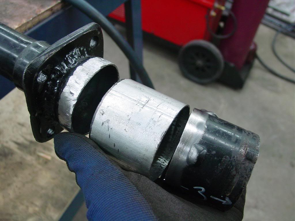

here is the piece of tubing that i used to extend the front nose of the steering column. i needed the column to be 1.5 inches longer
here it is all in place for yet another test fit.. i was quite happy to be at this point..

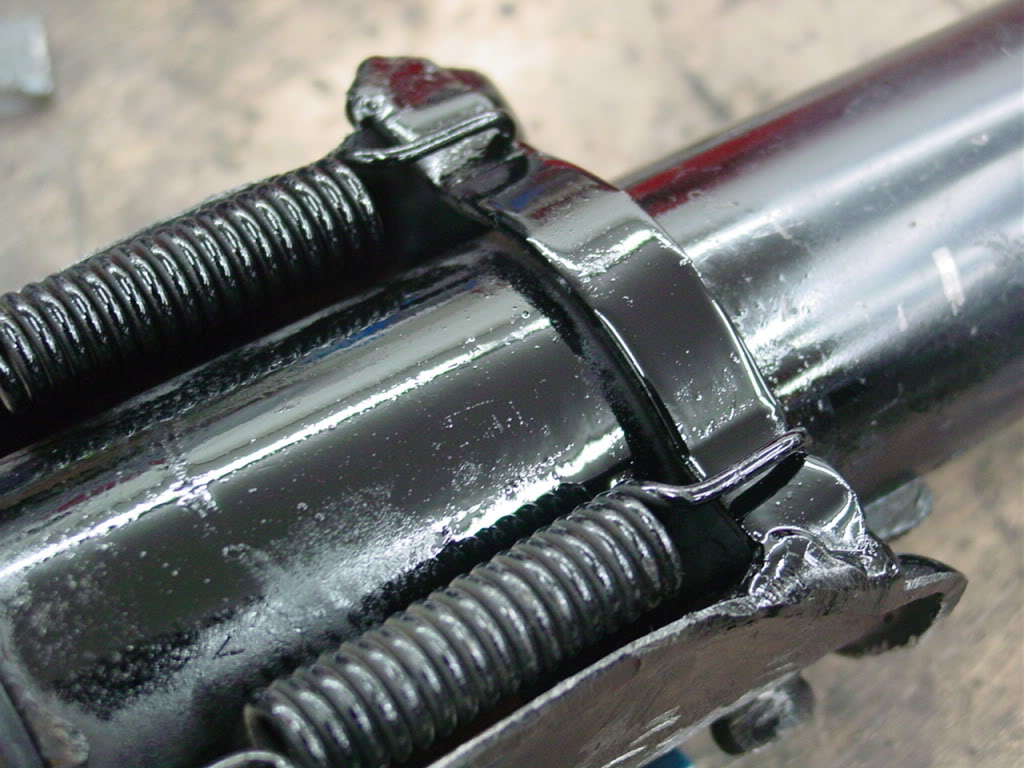

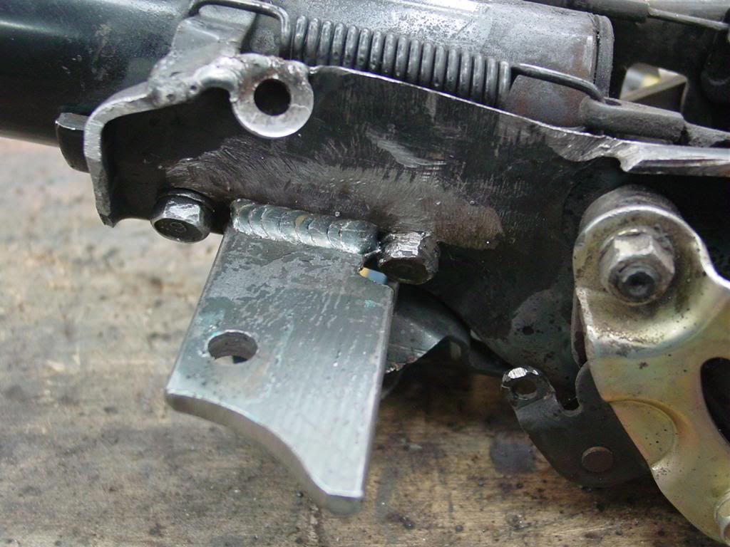

here is a small 1/4 inch washer that i welded to the top of the column so the spring for the tilt lever would have something to hook onto..

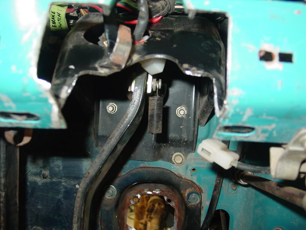

this is another test fit with the column in the dash.. you can see how tight everything is.. the other spring peeking through towards the back is the brake pedal return spring.. it will now get hooked onto here..

the steering box is from a bj60 as is the entire rolling chasis..

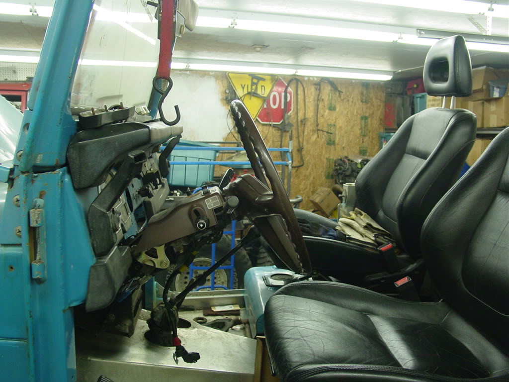

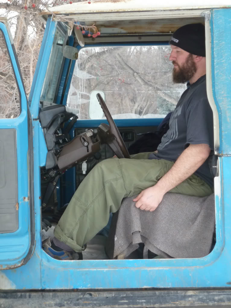

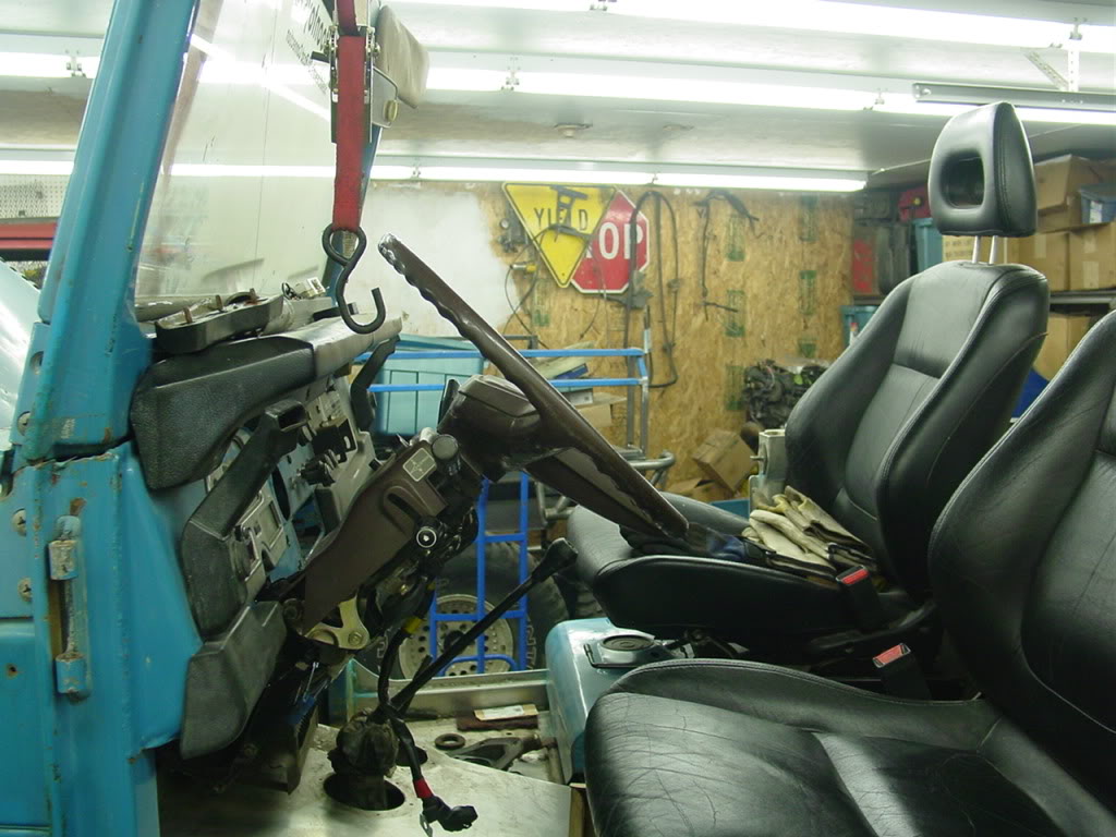

Sit in that thing and have someone take a pic and post up, I'm interested in the clearance between the bottom of the column and your knee, as one would enter and exit....
You may have some advantage there with aftermarket seats and seat situated rearward, but it it were all stock I'm sure it would be too tight for most 6' & taller folks.......
Whats the dash look like with it all done now.
here is a couple of pics of me with the steering wheel both up and down so you get an idea of cab room.. my seats are acura integra leather and they are sitting on home made seat brackets.. i am 5'8" ..
