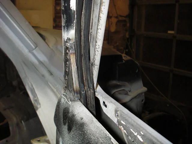

update! Got a few hours in on the cruiser today, a bit detailwork, grinding and stuff, but also found a solution on a problem that really have been giving me headaches! That little stupid rubber gizmo holding the windowchannel in the front door. Asd I wrote earlier, I have replaced the front part of the frame, but since rust in that corner seems to be a recurring problem I wanted to try something else. And I found aq solution that goes well with my widened windowframe.
The channel inside the door was to short for my plans, but I had the leftovers from the rear doors, it is not an exact match, but the rubber weatherstrips fit, and it does the same, just both inside the rear door, and exposed. This also explains the difference in profile.
You can see this in picture 1.
Next step was to move the mounting bracket from the old (rusty) channel to the new one, this you can see in 2 and 3.

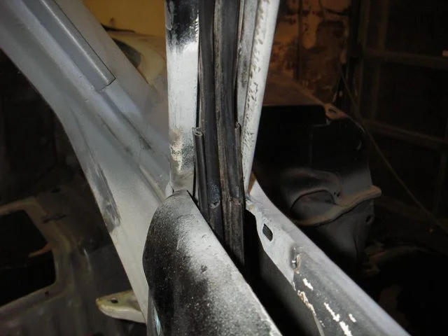

Next, a testfit! and, it might not be that easy to se, but the new (rustfree) channel line perfectly up with the frame!
For support on the inside I welded on a triangle. so to fit the channel it is just a matter of sliding it up in place and secure it at the bottom, just like factory!

A shot of the channel installed. I plan to use the rubberchannel from the backdoor to lengthen the one made for the door. This way I get the same rubberprofile all the way. It should be possible to glue them together with cyanoacrylate, I have tried gluing rubber with it before, and I could not rib it apart, if my life had depended on it!
