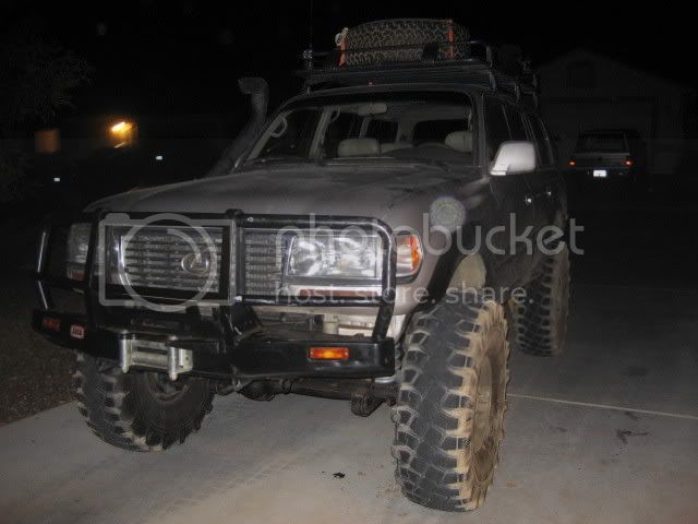

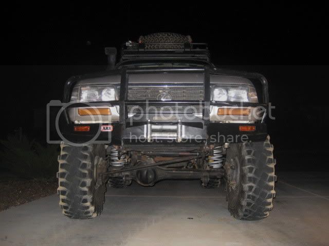

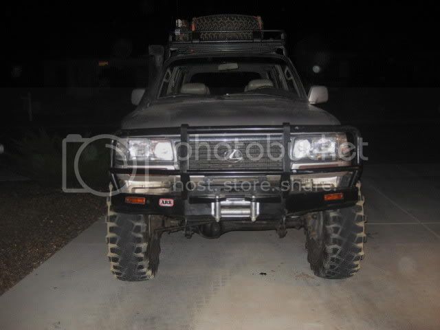

Ok, so I went to check it out.....
Looks like it fits to me....
Hummm Looks good. Now if you get some bigger tires you should be set.;)
Good deal, having seen 60 & 80 series ARB's off of the truck, I would have bet they wouldn't be interchangeable. Doesn't even look too bad!
Is it just the angle of the pictures or is there a sizeable gap between the ARB and the body of the LX?
On my LX I can't see the AC dryer and other stuff back in there and that bottom bar sits between the headlights and the parking lamp.
Regardless, nice score :D

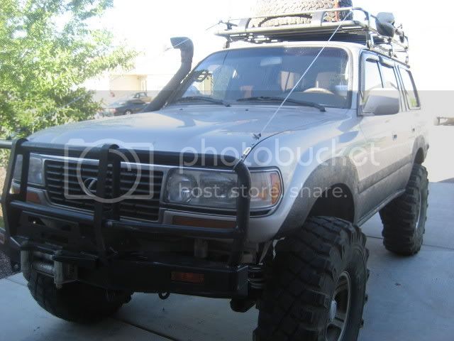

Here is an 80 series ARB bumper installed for comparison purposes...Looks like the design is just slightly different
It doesn't have the snow plow blade hanging off the bottom either. Still a deluxe score.
