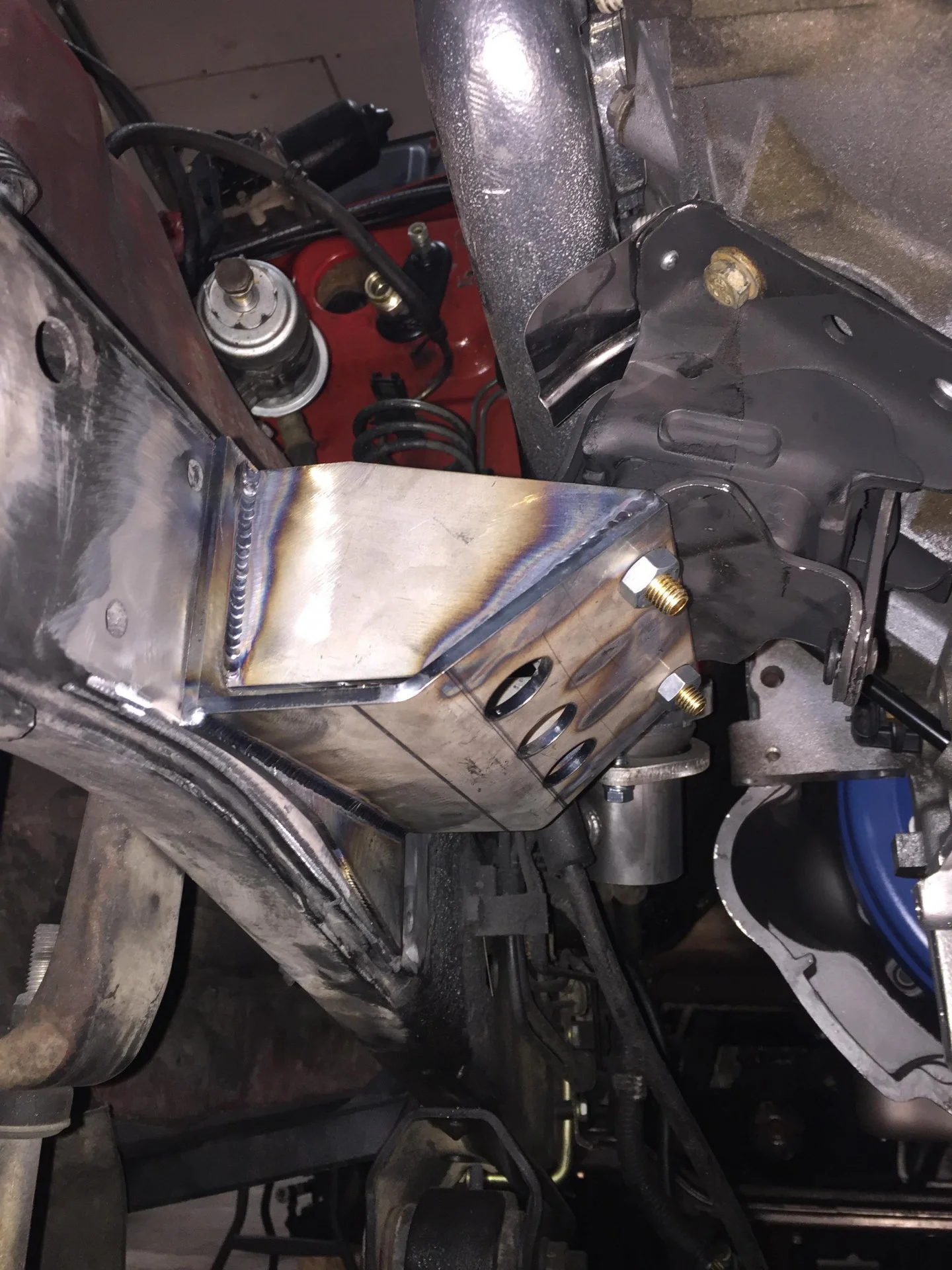

Hi, I've mentioned my products in a few threads but haven't ever made a standalone thread - now that a few other venders have threads in the tech section I guess I will join in. We have a few installs lined up so I figured I could get some tech notes and install pics put up in one place. I developed all these to make our in-house and DIY'ers projects easier, trying to take some of the guesswork out of the equation.

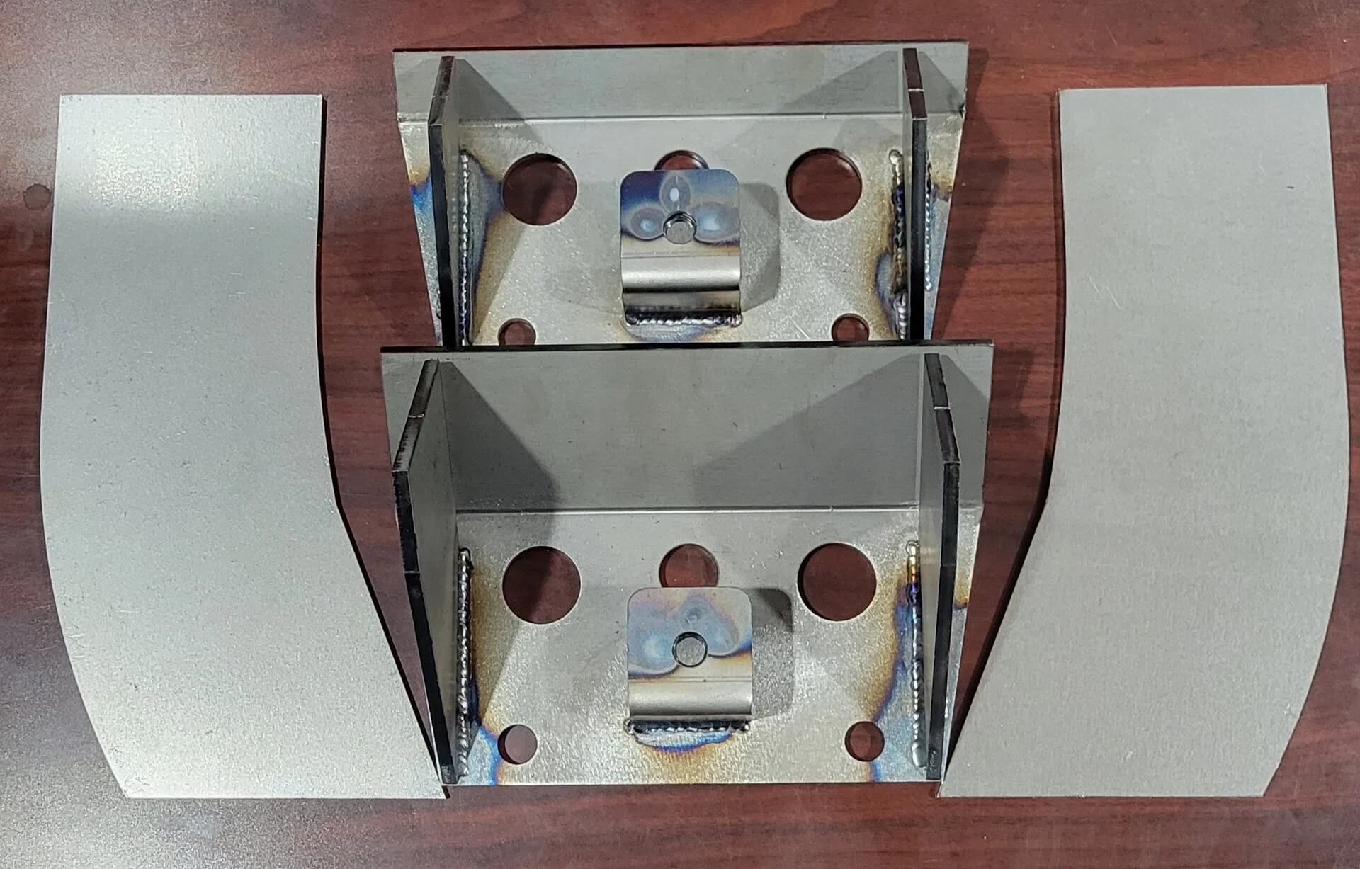

My big seller is my motor mount kit, I developed these about two years ago for 60 and 80 series and have sold around 65-70 sets so far. They use the GM truck mount designed for these engines. They are super strong and super clean. They come with the side gussets and middle tab pre-welded by yours truly. I chose not to do any sort of indexing to existing frame holes as there is some variation depending on transmission choice (For example the engine will sit a little more forwards with a Mark's adapter/H42/H55f vs. when using a 4l60 in a FJ62 and with the stock auto crossmember). They naturally line up the engine to the original 2F/3FE centerline and you just have to line up the top of the bracket with the top of the frame. Super easy.
I have them priced as inexpensively as a I can at $260/shipped and are almost always in stock or being restocked.

Matt are these an open top? Like a bucket to hold mud and crap right against the frame?
There is a 1/2” gap at the bottom of each side for plenty of drainage.
