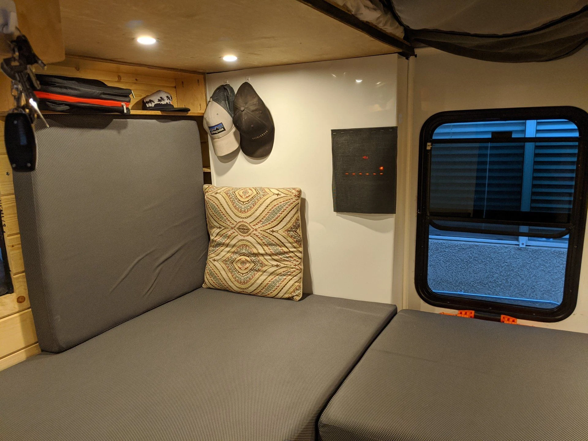

We are waiting on a quote from Neff upholstery in Riverside. http://www.neffsupholstery.com/
I priced out the foam online and it's about $240 for just the foam in the sizes I want.

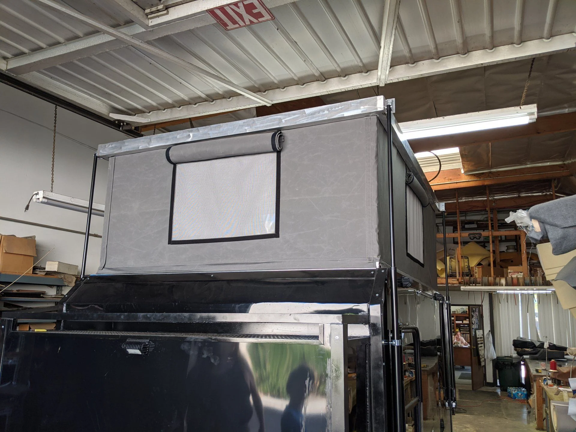

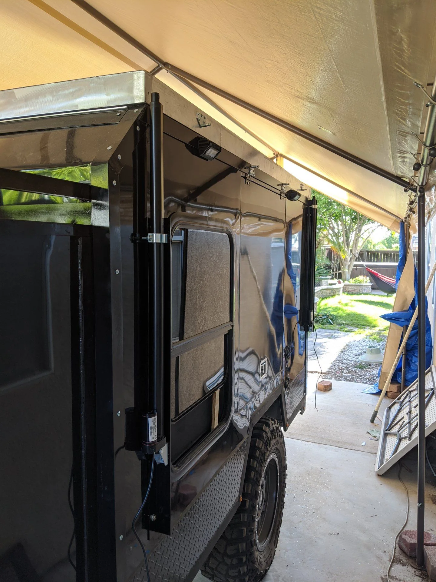

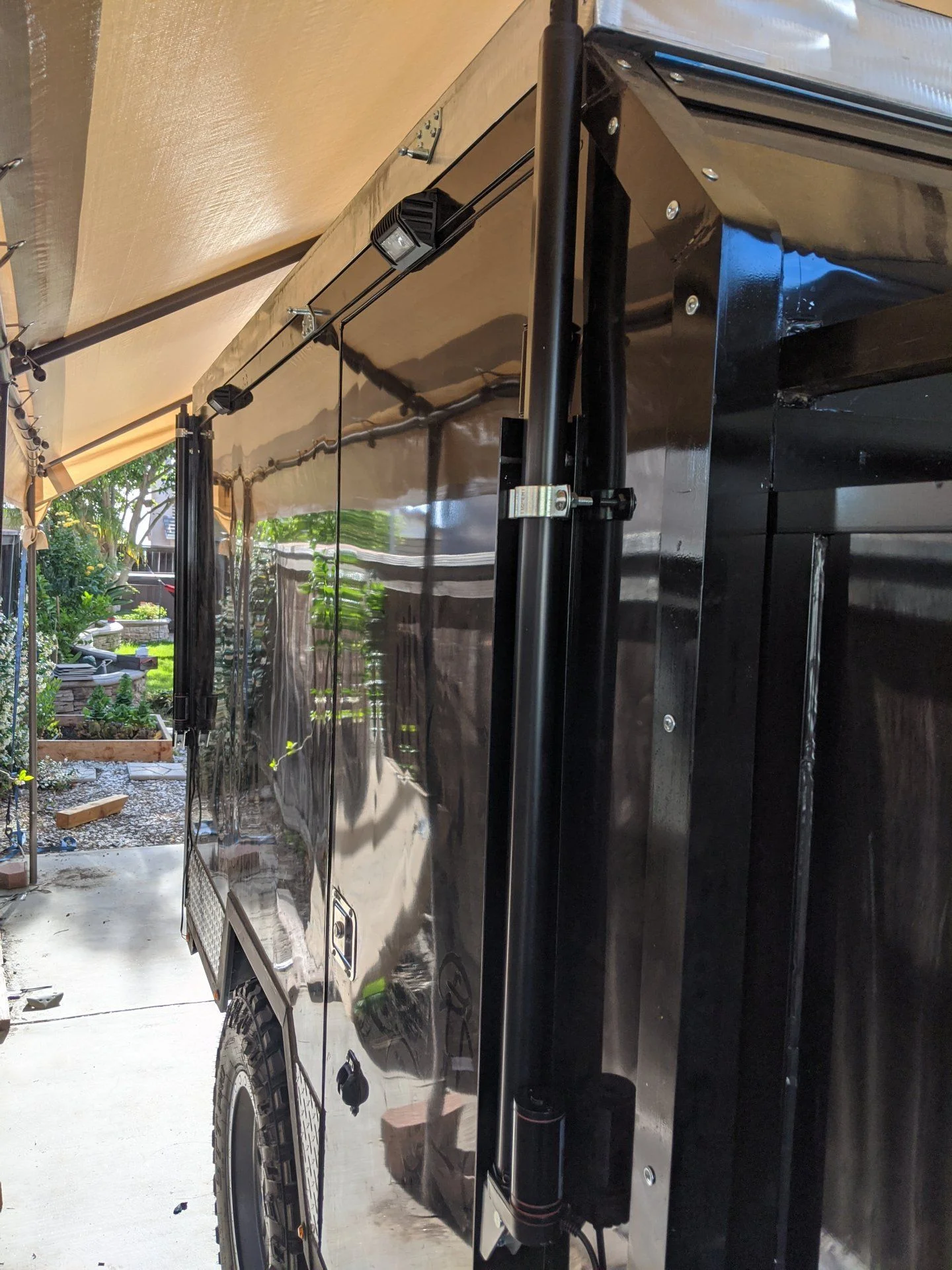

Actuators are mounted. Tested them yesterday, and they work great!! Getting mounts welded on the roof on Friday. Then the last thing is to get the canvas tent made. So close.

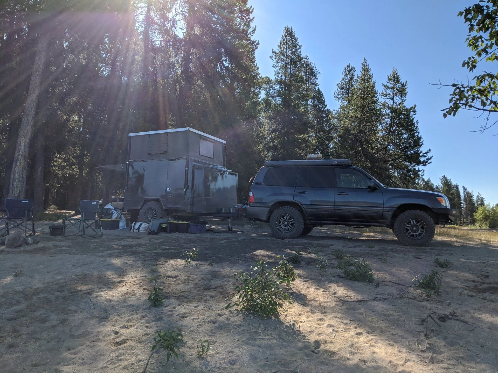

Definitely started my list for round 2. Total weight with water and gear was 2,504lbs. It has a 42gal tank, plus about 200lbs in gear. Dry weight is probably around 1900-2000lbs

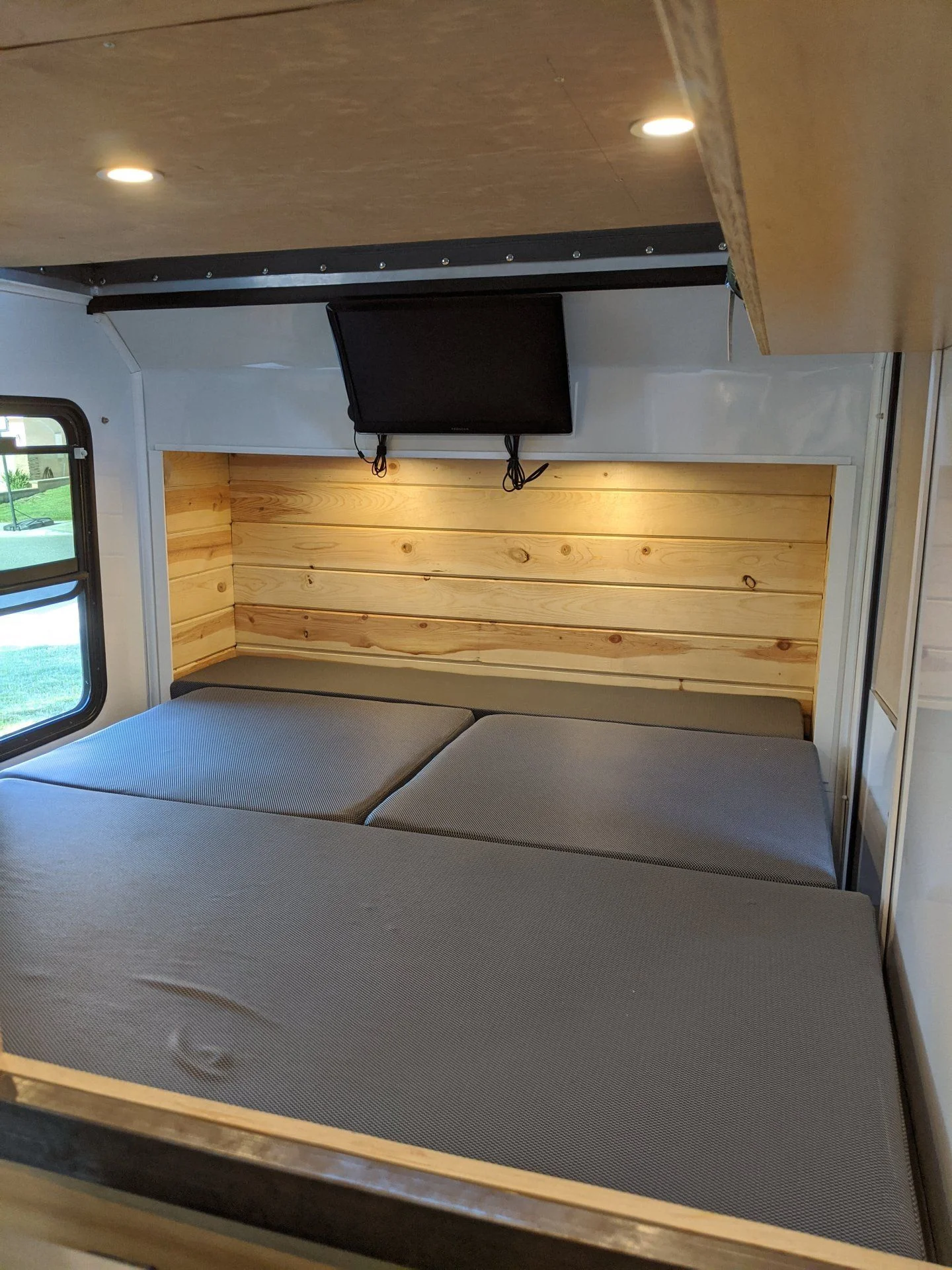

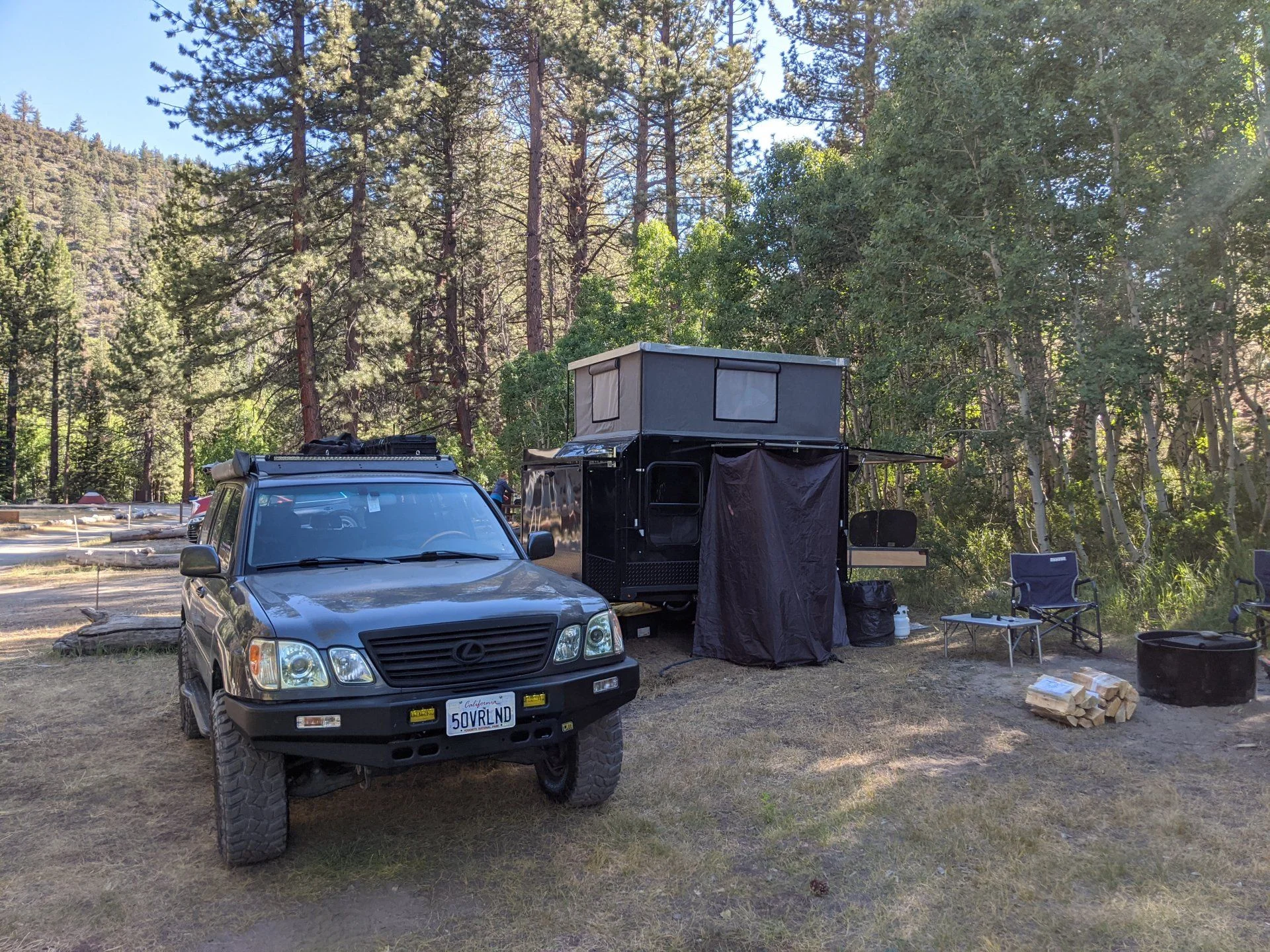

5-6 total. Its a full size bed up top and a queen/king on bottom. Queen in width, king in length.
