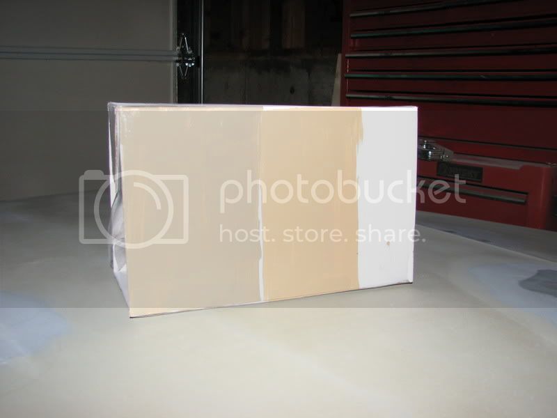

Color: I selected the Rustoleum Professional "Sand" Color, but, like others, decided it looked a little too peach colored, so I decided to experiment with mixing in "Smoke Grey" a different color of the same type paint.
Here is the results of mixing 3 parts "sand"
to 1 part "smoke grey"

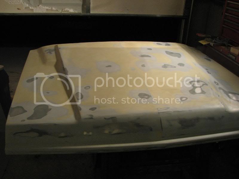

this is a photo of my Hood with the sanding almost complete. The box on top has two color sample painted on it. The right side is the "sand". The left side is the Mixture.
I am excited to see how it goes on. I'll be finishing the sanding and starting the first coats in the next few days.

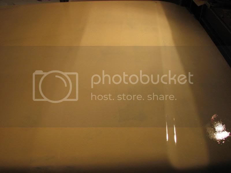

Here's the first coat . It went on just like all the posting on the internet said, but man! there were alot of bubbles! I got rid of them by blowing on them, and eventually figured out the correct roller speed (slow!) to keep them from forming.
In this shot below, you can see some of the sanded areas still visible under the first coat. All the walk throughs for the roller method, say you don't need primer over the bare metal. Hope so!
Heres the second coat on the hood, I just finished it up this morning. Hopefully I can wetsand and get another coat on tonight.

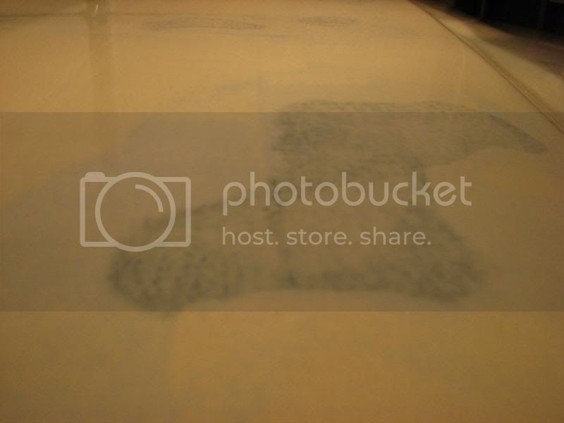

Third coat - You can still see the primer but it's getting better each coat.
the wetsanding helped smooth the oarnge peel areas
I have 4-5 more coats to go, Im really starting to feel good about it!

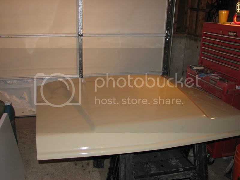

I read a little futher on the Mopar $50 paint job thread the last few days.
Im changing my gameplan for the sanding between coats.
I have 6 coats down now and i am wet sanding with 1000 grit for this next coat.
then i will wet sand with 1000 again lightly , and maybe a little bit with 1500, then on to buffing out the shine! Almost done!

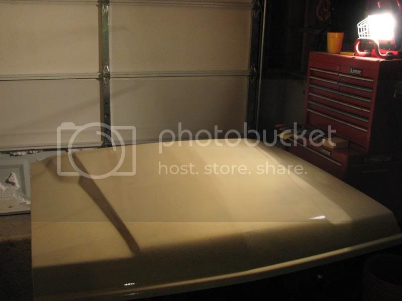

Final coat on the Hood.
So, do i want to finely sand now with 2000, and then buff, or should i just buff it after the paint dries???
It looks damn good after the paint is dry - right before i go to sand it, except it's impossible to keep little flecks of stuff out of it.
