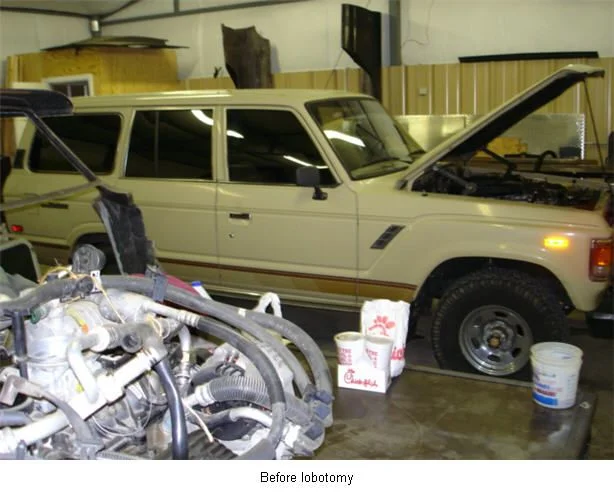

Well today is it.... we are going to start with the I-6 removal.
update 15 Dec:

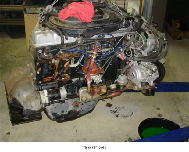

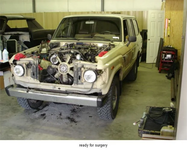

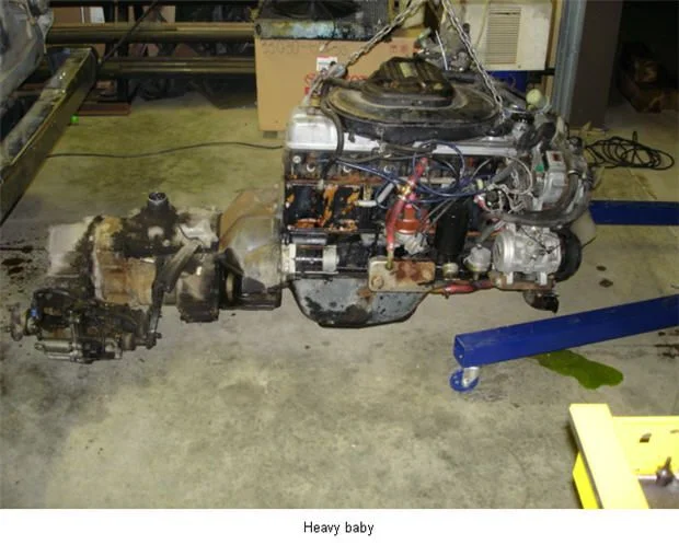

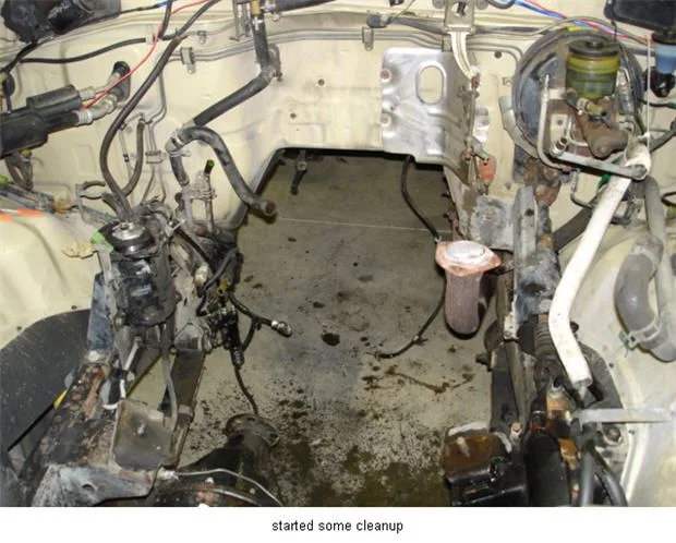

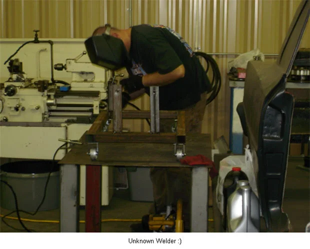

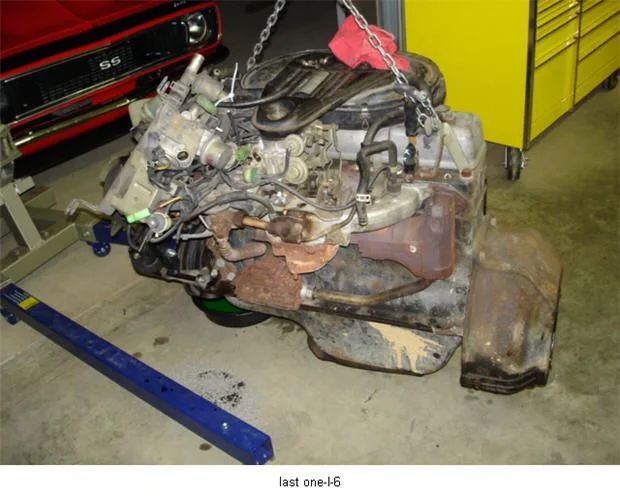

Started on truck this AM. Removed grill and most everything on the front. disconnected & marked wiring I need to reference. Tried to leave most everything connected to the engine that we could...All the emission crap, all the vaccum line, all the accessories & belts. ubotlted front and rear driveshafts, drained fluid from trans and transfer case, unhooked likage on trans case, removed trans shifter and boot, removed skid plate, removed crossmember and unboled trans mount. Removed engine, trans and transfer case together. My buddy Les under the truck with a jack and me on the engine lift. Dissconnected all the other crap to numerous to mention. Did not have any bolts break or strip. I ended breaking one of the little plastic valves on the LH firewall and the vale that's mouted on top of the fuel tank vent canister. Othe than that no breakage as far as I know. Got engine out, made a dolley to move the engie around (Les made it, I watched & helped). Only one "war wound" and that was me with a screw up with a lockblade knife.

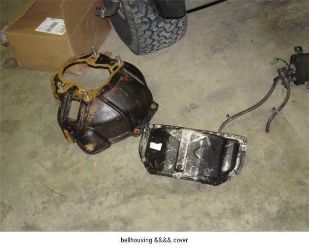

more pics - 30 Dec

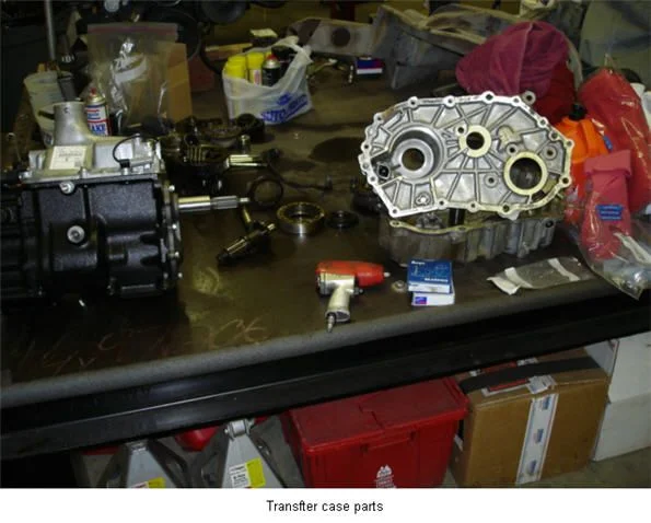

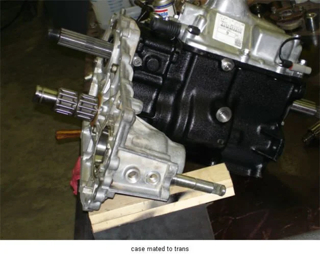

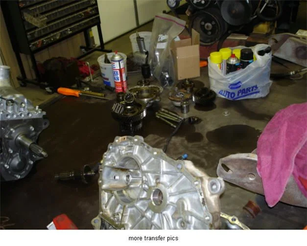

More pics today. We removed some more hardlines and various msic parts under the hood we won't need. Also made good progress on rebuilding the transfer case. (really appreciate the pictures of the oiler and hole to plug) from the forum "guys". Removed and broke the GM OEM heater hose fitting (piece of #$%^&). Took some time with a chisel and tap to fix that, were were lucky the threads were not really screwed up (5.7 V-8). In process of removing the steering gear (its a lifetime autozone unit / ATP). It made it almost a year and started leaking again.. Part is way to expensive to leak / fail that soon. Discovered we need a new hood release cable. Still need to order hardline and hose to plumb fuel tank and engine for fuel injection. Decided to remove the OEM toyota P/S cooler and I'll run either a GM OEM unit or something from summit. Still need to mate the trans with the engine and finish the bellhousing setup. May make some progress on this tomorrow. Suprised I've only had one bolt strip and that was one of the LH inner fender well. More pics. If anyone needs to see someting in the process send me a PM and I'll take a picture or two for you.

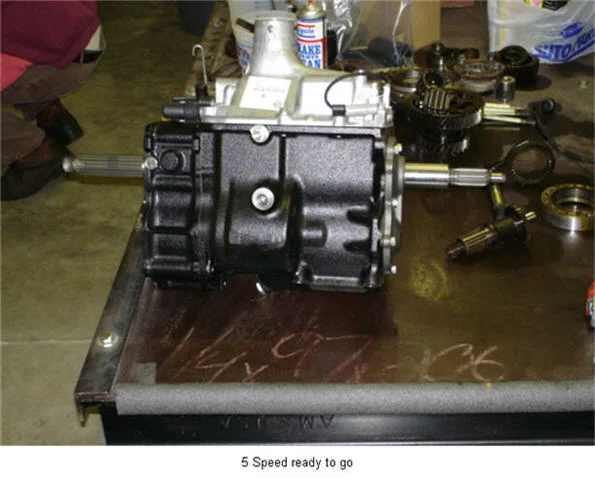

Last group of pics this evening. I will soon post some of this stuff on the for sale forum for those who may have a need. We've not been able to work on this as much as we've would have liked. Holidays and "real work" seem to have gotten in the way a little, but thats ok. I'm hoping we'll have it running by end of month Jan-08. I expect the install with the long setup on the trans and everything is going to be a little ackward, but not much we can do. The fuel injection fittings I listed previously are the correct ones. I belive that AZ FI also has some fittings that will work too, that are less expensive. We may be able to remove the OEM frame mounted motor mounts tomorrow. So far so good. I appreciate all the comments and advice / help / pics from others on the thread and others related to this swap. Its made it a good bit eaiser. One note...summit does carry a plug that espically designed to plug the EGR port on the LH side of the intake for those who may be able to run without EGR plubming.

On our transfter case reubild we are having problems getting what I belive is the high / low linkage shaft to install correctly. We are unable to move item # 64 once we mate the case toether. See attached picuture reference part # 64.
Any tricks to getting this aligned correctly as you match the case halfs together?
I assume this should have some movement in order to shift from high to low, so far we've not had much luck with getting this right.
Any tips?
