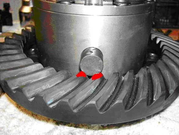

What kind of grinding do you have to do on the semi-float? For 4.88's do you have to do grinding as well?
you have to grind teeth down on the ring gear to be able to reinstall the center pin in the differential. 5.29s need a lot of grinding to make the clearance. you also need to grind 4.88s, just not as much.
Didn't now that! I'll wait for your pics when you put the aussie in. I plan on going 5.29s with 35s in the future... probably distant future though.
grinding for xpin
Grinding for the crosspin is only on c/clip rear as the case w/ fj80. Not applicable to fullfloat fzj80. This type of grinding is commonplace with installs of low gear ratios in many c-clip rearends. I have done this numerous times, and have sold hundreds of gears that have been ground for x/pin and have yet to see one fail if ground properly.
here is a more extreme case, a pic of a LC 5.29 gear that has been clearenced for removal/install of a detroit locker (the centerblock is larger than std x/pin) This was done nearly 10 years ago and still in use!
The other pic is of where you would grind for a std dia. x/pin
