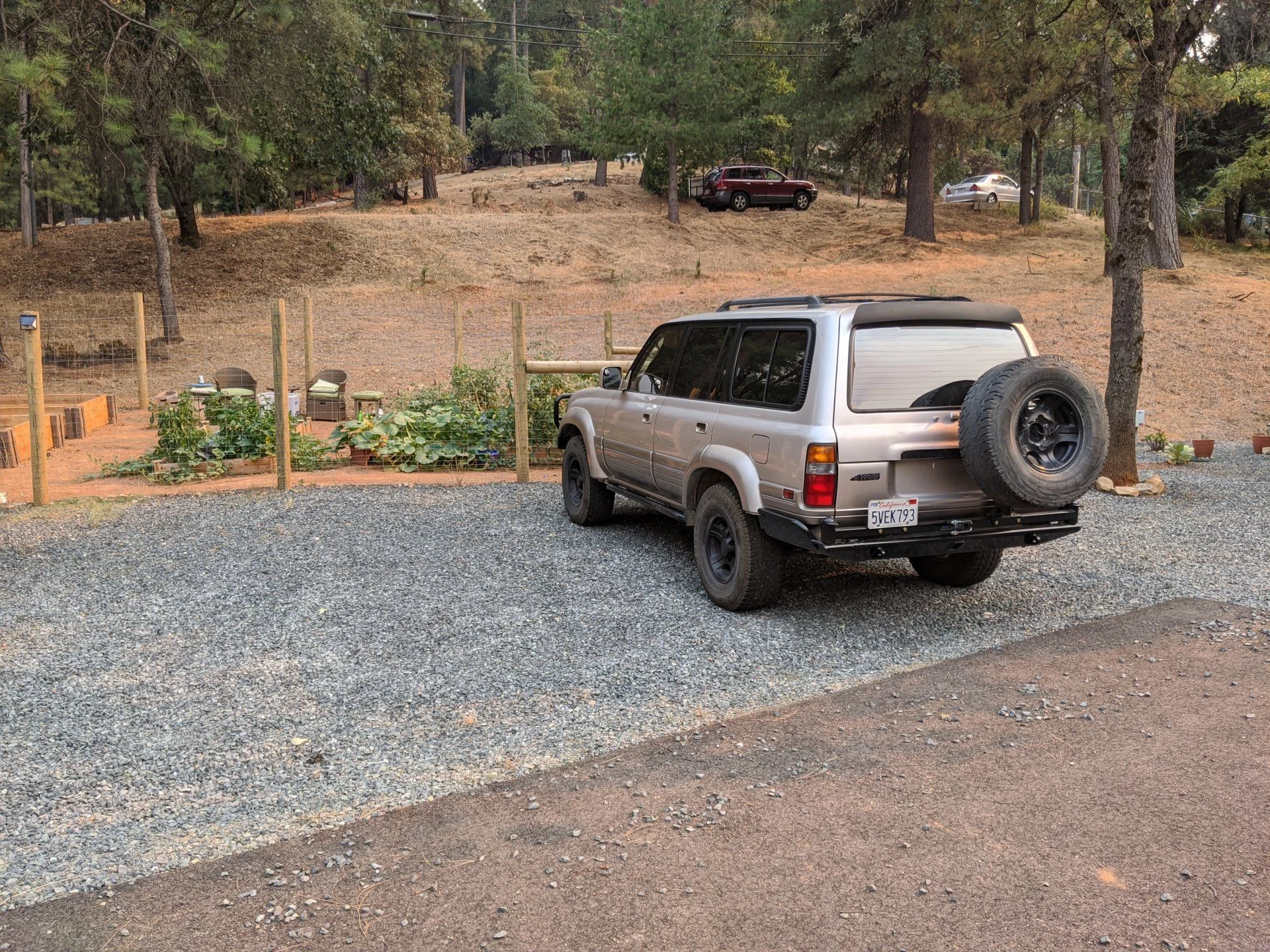

After installing the bumper with tire on the driver side and a full tank of gas, I only have a ¼" difference. The driver rear sits ¼" lower than the passenger.
Which is not a big deal...
It's also important to note, I have the Heavy springs.
I had mine put on the passenger side because the weight of a full tank of gas and the tire on the left side and me on the left side , seemed to much ... And as it turns out it really doesn't matter which side you get , because there are identical holes drilled on each swing out arm that you can pick which side you want to install the tire carrier ... And also the fact that when it's shipped to you , the tire arm isn't welded to either side , it's a bolt on that you bolt on !
I was lucky enough to get that rear bumper for their cash price of $1850 , I stead of the $ $2200 price cause 4x4 labs is about 8 miles from me !
Ahh very true if you get a dual swing out you can swap sides, I have a single so I could swap it with the ladder/fuel/drop down table but then the weight would be further away from the single pivot when open..
Installing the gas strut was an absolute bear! Are used a long woodworking clam and clamped it in and slipped it up into place! Not easy at all
how do you get the gas strut on? haha
As long as the strut posts are some what close to the correct locations on the bumper and the swingouts, you should be able to put one end of the strut on the swingout/bumper and attach the other end as you close it. Worked for me anyways.
I gotta give this thread credit for helping guide me and Jimmy @CenTXFJ60 on building this thing.. the lack of instructions from 4x4labs is pretty irritating but they said they are working on including instructions for future customers. Definitely spent hours zooming in on photos here.. so thanks turned out pretty damn good.
