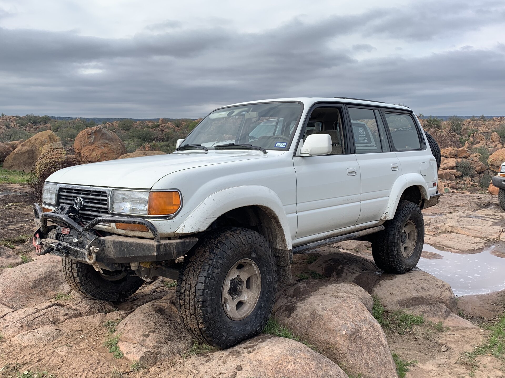

I have a labs front and rear, for looks I like Slee's front better, I think he has the best looking front bumpers for an 80. I just went 4x4 for the clearance.
If you go with the labs bumper, weld it yourself if can weld. Mine was not symmetrical when put together and created a few issues for me.

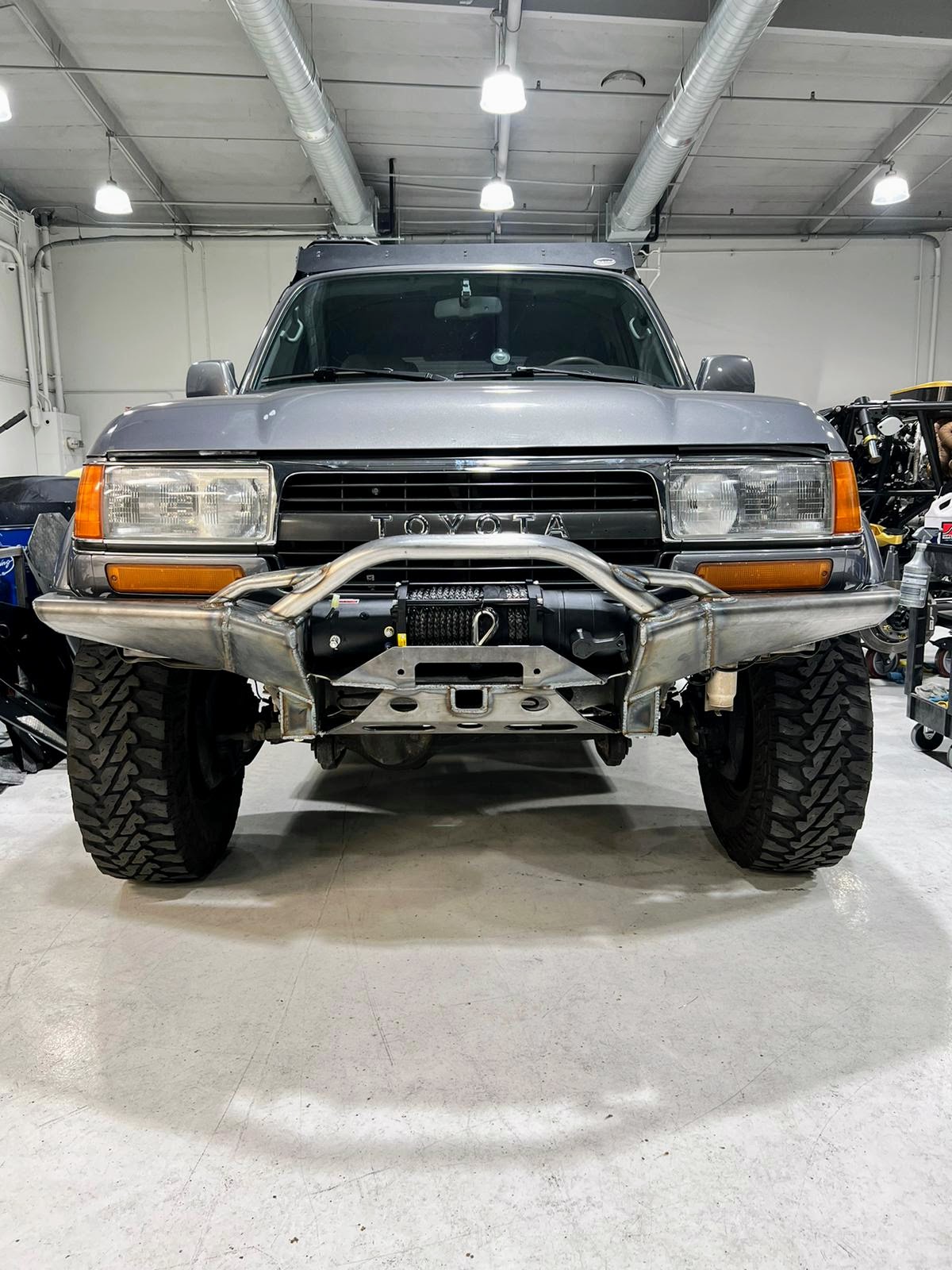

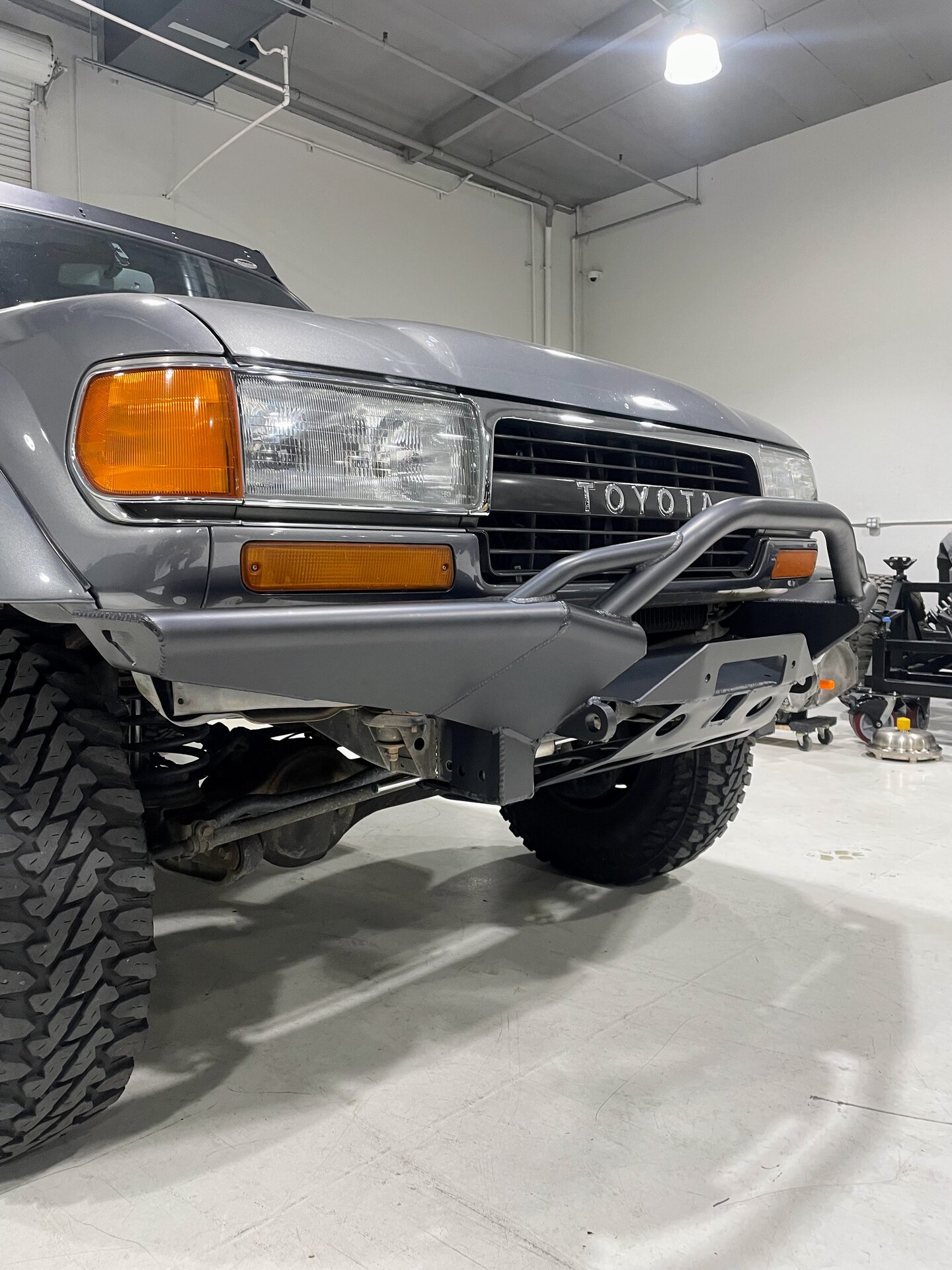

I am in the process of adding a shelf for my new LP9s. I wanted the lights to sit behind the bar for additional protection. I also relocated my winch controller to the area where the anti lock brake system used to reside. I had to notch the bottom plate of the bumper for my new power steering cooler and then designed a new skid designed to protect the cooler since it hangs down about 1/2" below the bumper. Just got it back from Send Cut Send.

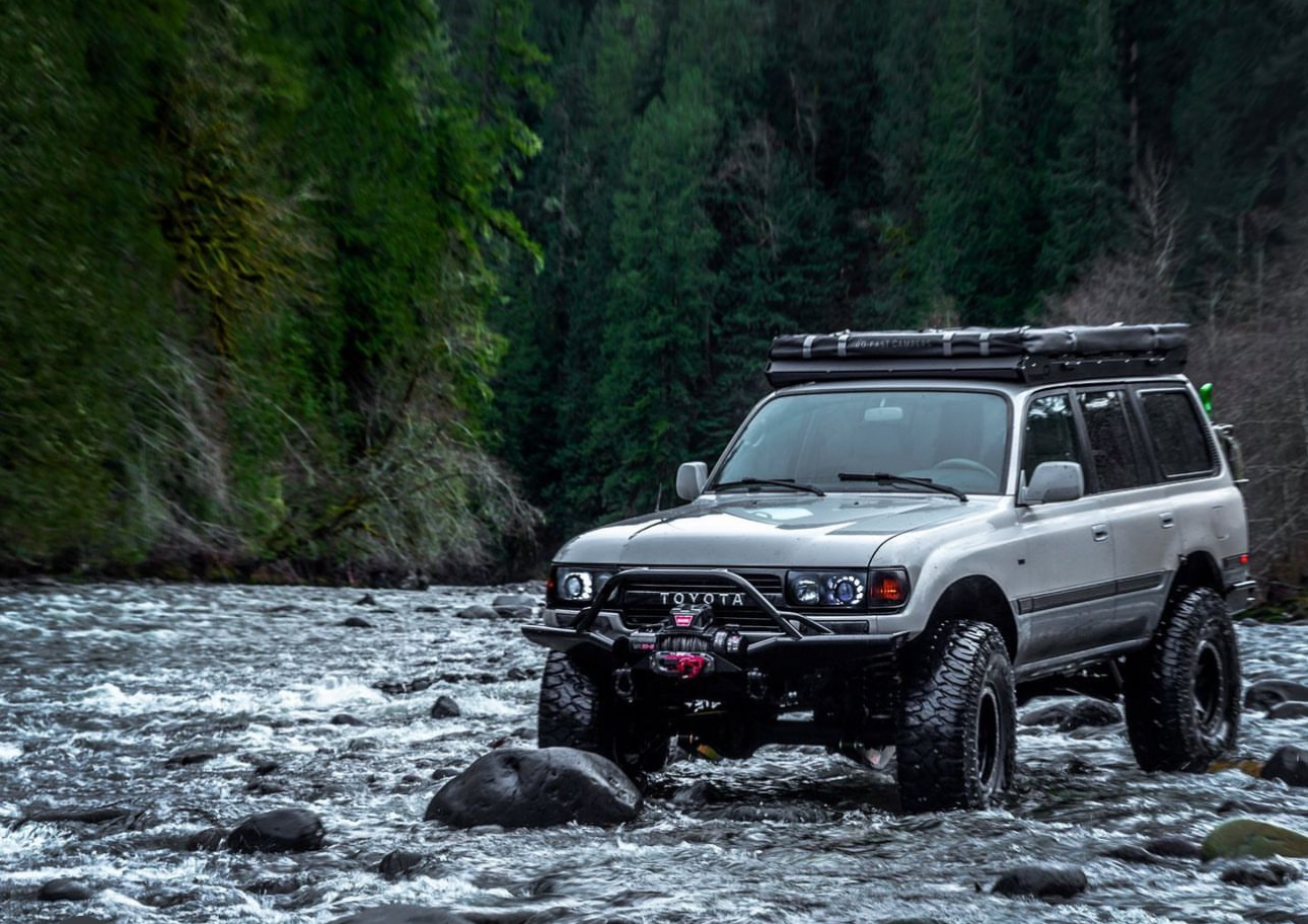

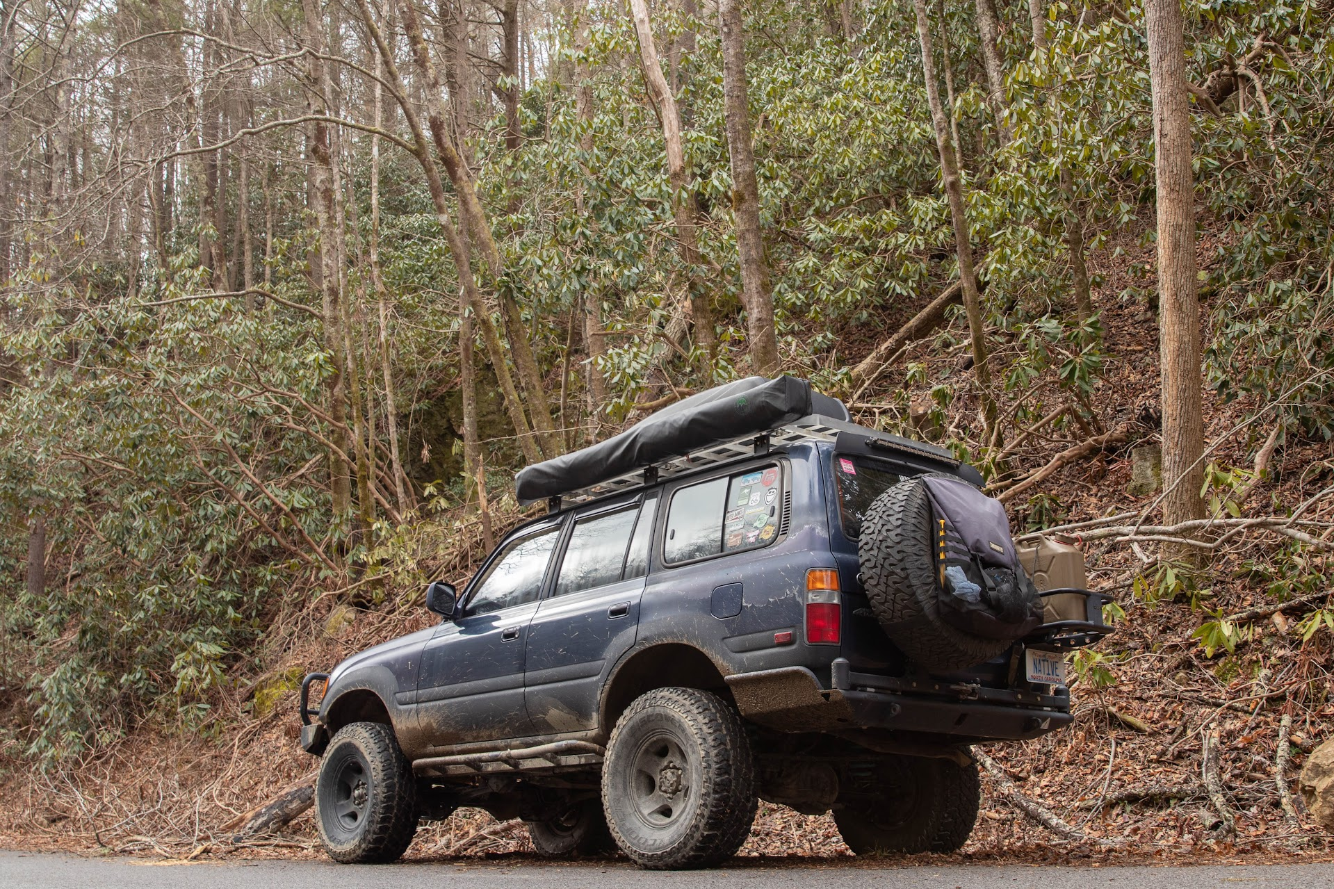

ARB front

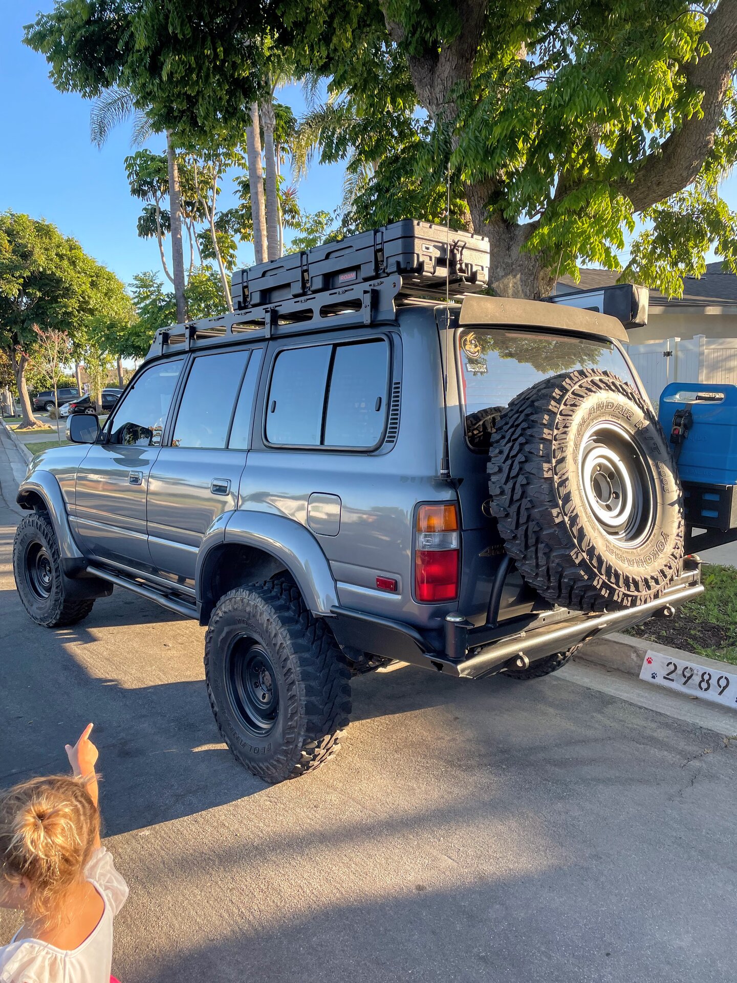

4x4 Labs rear
I know the ARB is not the strongest but I love the additional protection of the lights and grill. I love the 4x4Labs bumper for being so simple and robust but I wish it had a better latching mechanism.

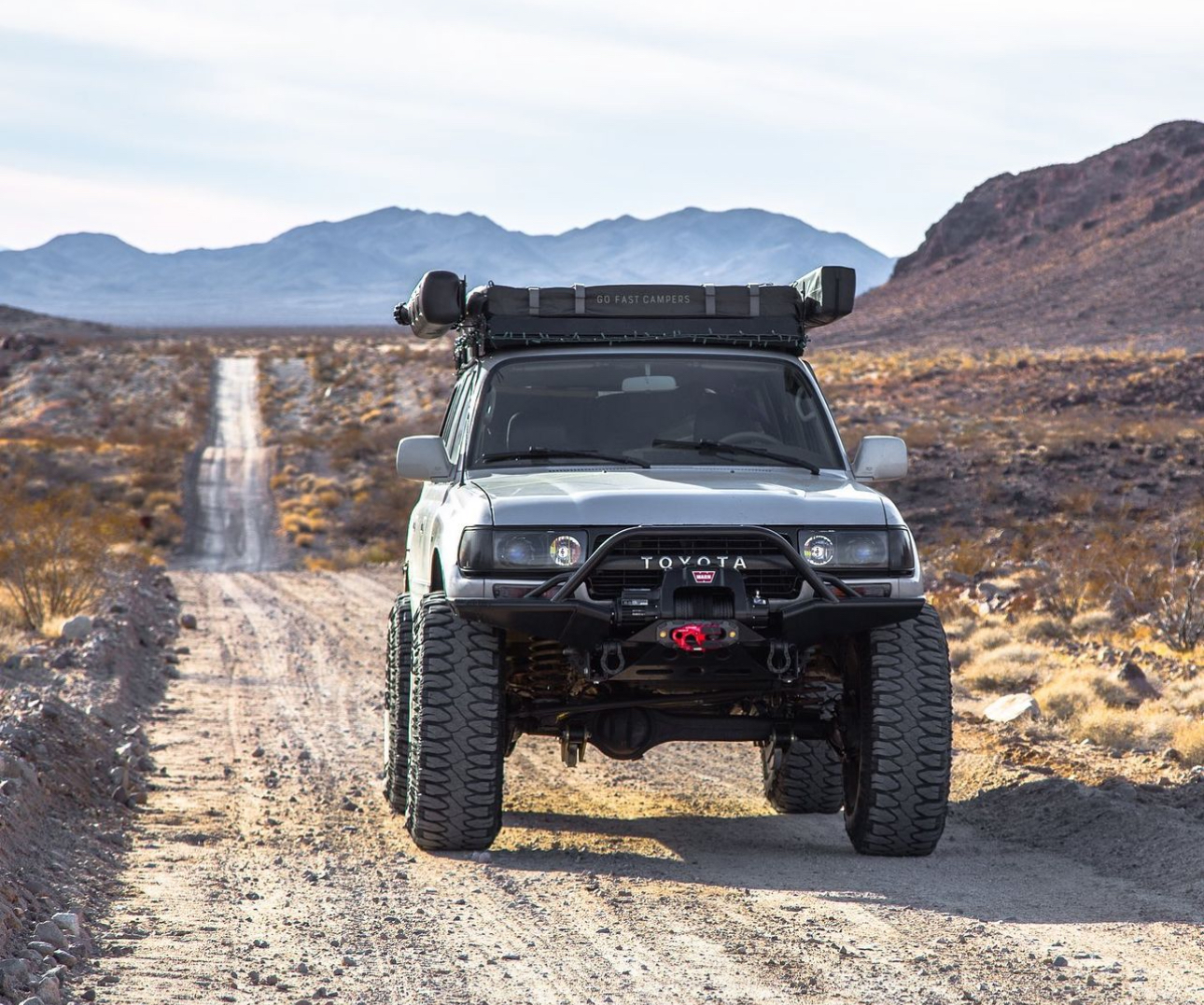

Also….. opinions on the high stinger variant of Luke’s bumper? I kinda dig it even though I probably won’t be running big lights upfront. Here’s a pic from Instagram of @formidable_land_cruiser ‘s rig. Big fan. Check his set up out. Thinking about going with the high stinger .

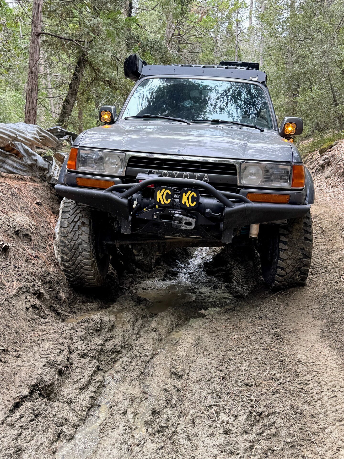

Off top pic but who made the ditch light brackets?
Yodateq - same co who made the tailgate latch mounts too. A-pillars are a bitch to run wiring through, but I have bright fronts, ditch lights, and KC Cyclones below as puddle lights which turn on when I unlock the car (aftermarket keyless entry) which has been awesome.
