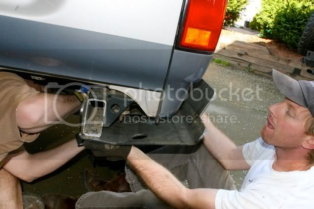

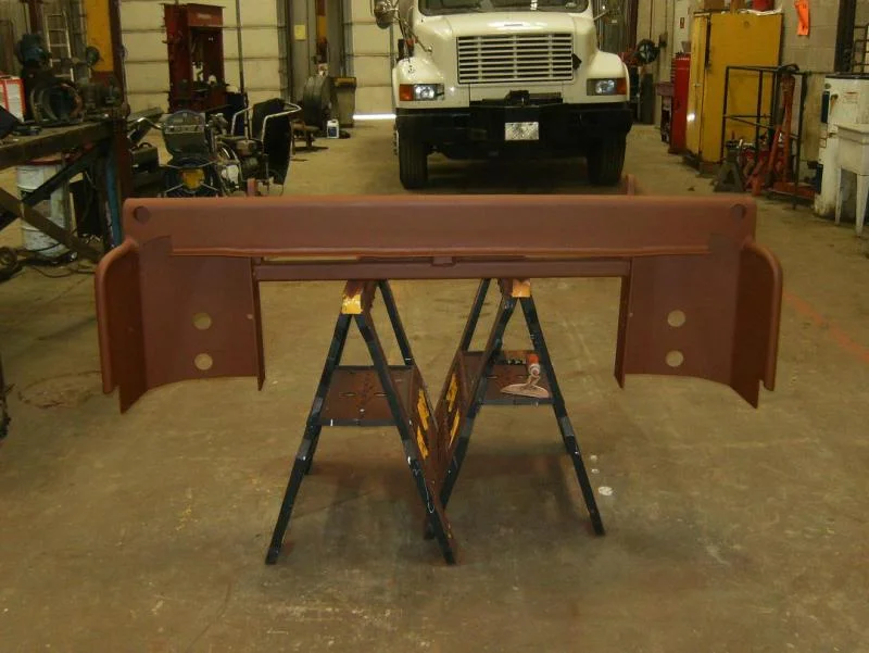

Today, we got an early start on building Joe's 4X4 Labs bumper for his 80 this morning. Greg and Ramon built his yesterday so Greg came over to guide us through the process. Joe showed up with his stock bumper pulled so all we had to do was start cutting and prep the new pieces to put it all together.
I'm very impressed with this "kit" and ultimately, the complete bumper. I wish they made something like this for the FJC.

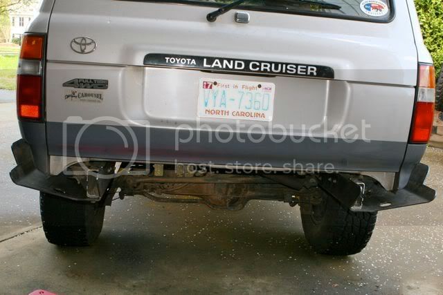

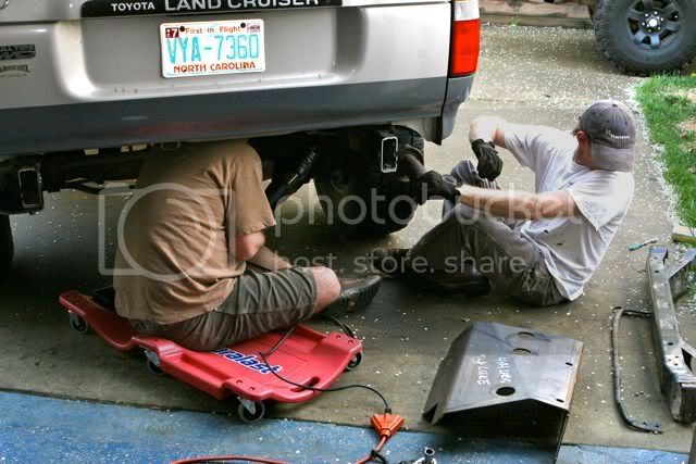

The first thing is taking the first step of no return, cutting of the stock bumper. Thanks to Greg's guidance from doing it the day before, getting busy with the sawzall and cutoff wheel made pretty quick work once we got a fresh blade on the sawzall. On a side note, Greg discovered the value in the Dewalt blades for such work. WAY different in cutting ability through the frame rails, like night and day. Spend the extra to get the Dewalt blades.
When we got to this point, we had to jab at Joe, asking if he was sure this was the bumper for the rear and not the front.

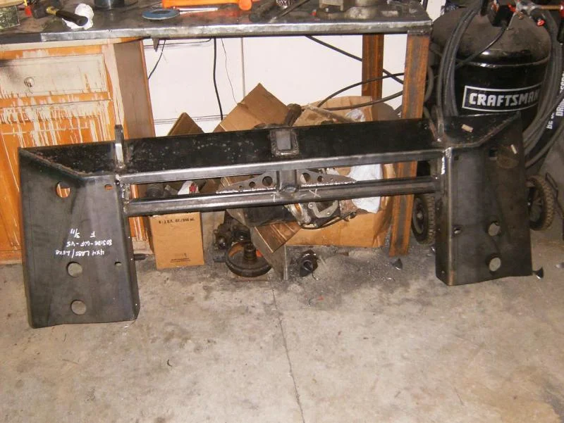

What we have to start with, hopefully, it will become something substantial in a while...

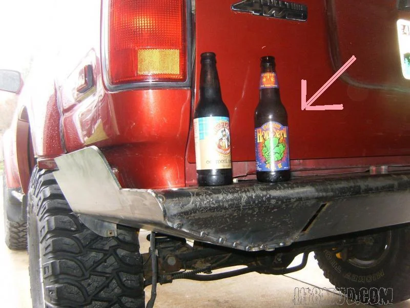

First cut...
Trimmed to the right length...
The scrap pile begins...

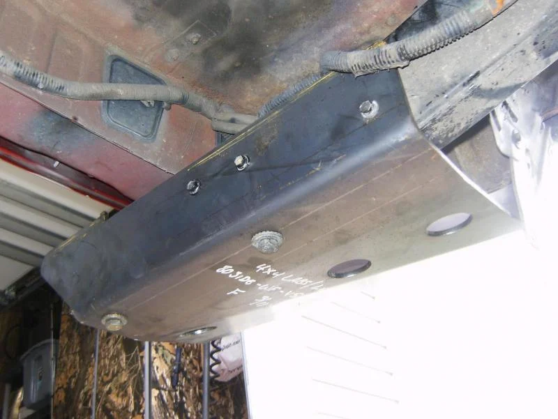

First piece goes on...
Clearing the exhaust for side two, Greg is taking cover from all the dust coming from exhaust...
Now, for side two...
Its starting to take some shape...

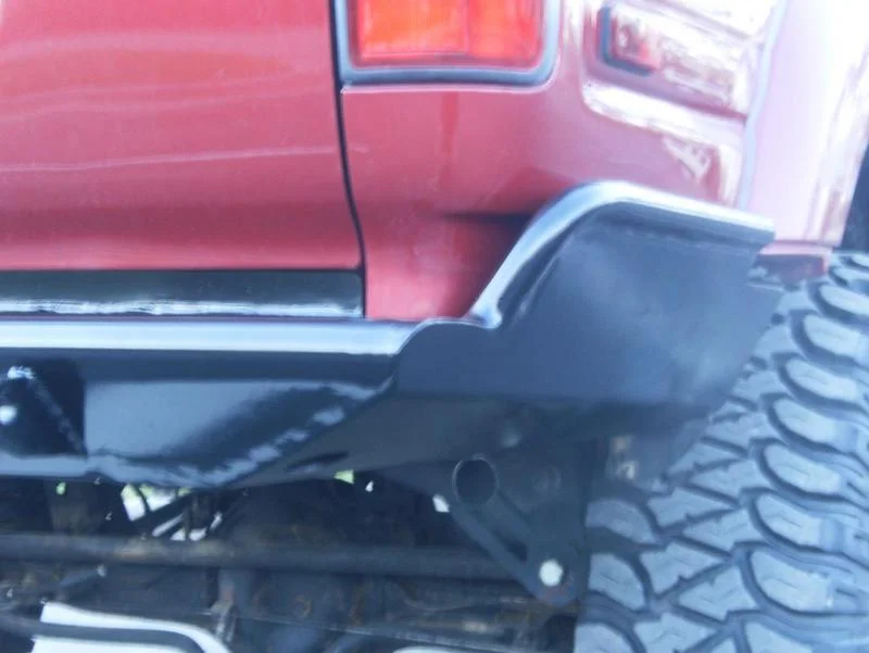

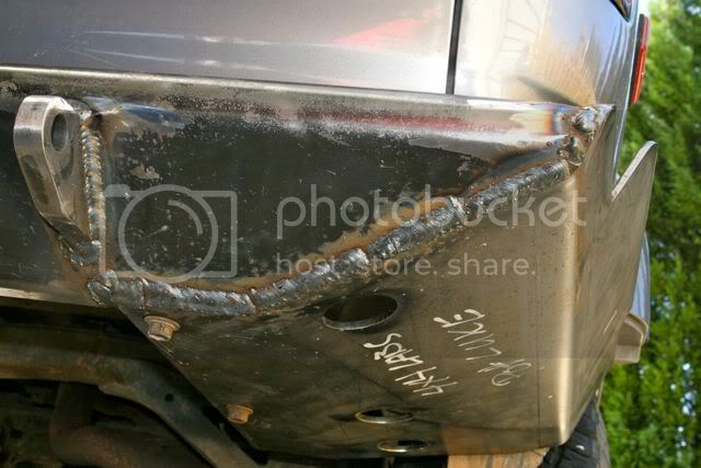

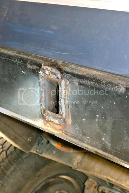

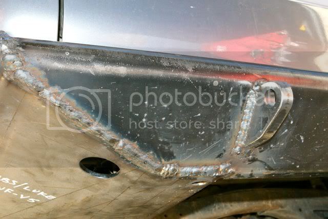

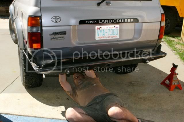

Skip ahead to the install after all the grinding, welding and grinding (did I mention we did some grinding?)...

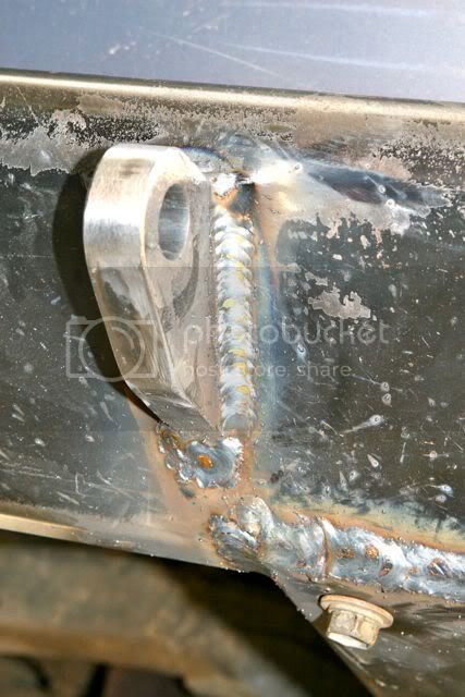

I know that Joe took some more pics as did Greg with his build yesterday. Again, I'm very impressed with the outcome. This bumper is a TANK, well thought out and now custom fit to Joe's rig. Joe has some grinding to do before its read for paint. I went a bit "heavy" with the welds, wanting to be sure to get full penetration and not have an issues.
The recovery points are particularly beefy and could probably be used to pick the rig up with, as in suspended in air.

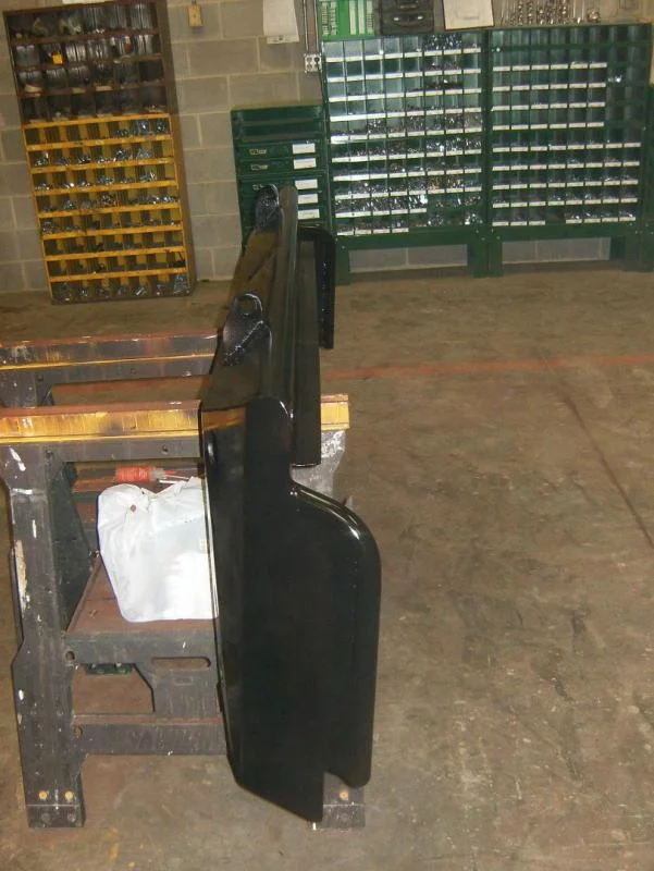

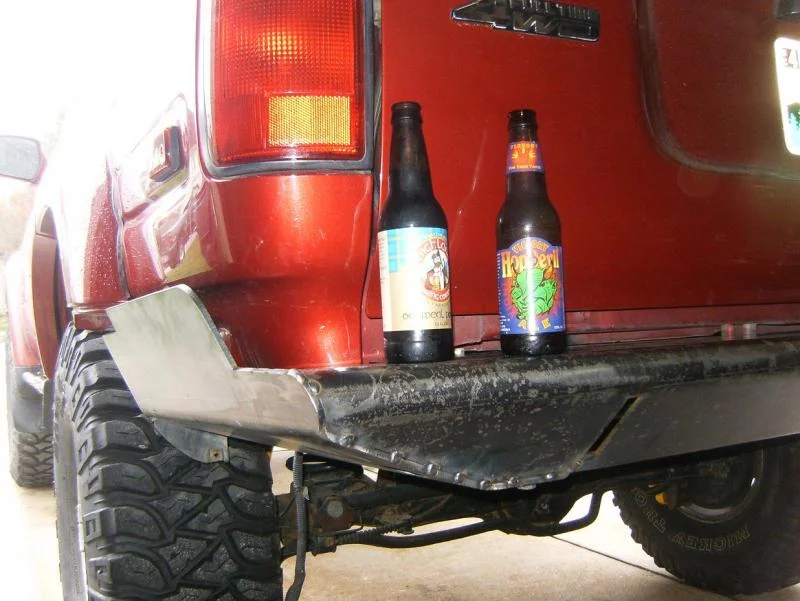

Finished Bumper before Grinding
As mentioned I have about 30 photos of the build so if you are interested in the bumper and have some questions let me know. Luke has really thought the whole process out and build a great bumper kit.

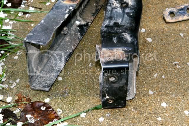

What size is that frame rail? If you're tossing it out, I wonder if I could use it to repair my rust in the rear....
I'd have someone check the dimensions to see if it will work. In Joe's case, we took it off in sections but we still have one left to do (Mike's). In the next one, it could be cut off to make as much room as necessary to help fill the piece you need...

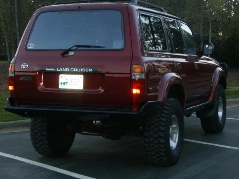

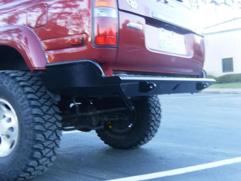

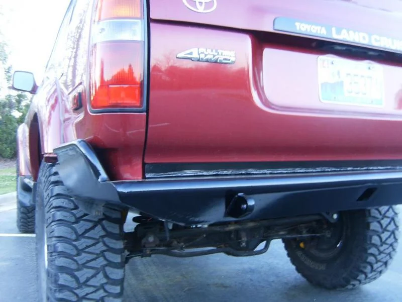

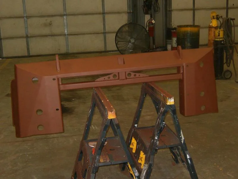

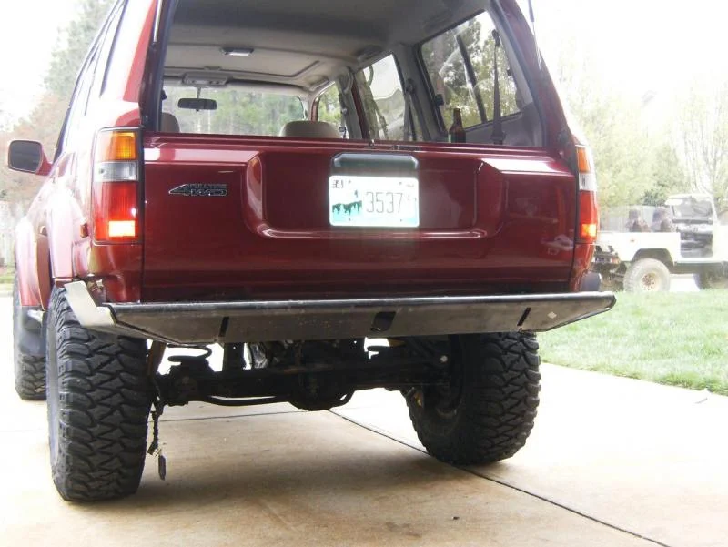

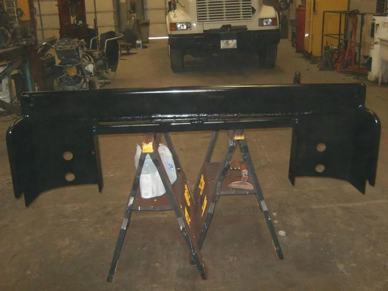

UPDATED PHOTOS-2/3's Complete
Okay so I spent a majority of the weekend grinding, priming, and painting. and finally have reached the 2/3rd's stage of completion. Only part left now is going to be designing and completeing the tire carrier portion I have in mind. I am very happy with the build and the completed bumper so far, I added a lip on the center section as to fill the gap between the center channel and the bottom of the bumper.
Let me know your thoughts so far.
Looks ready for Raleigh traffic! Really, that's a completely different look....can't wait for the tire carrier.
