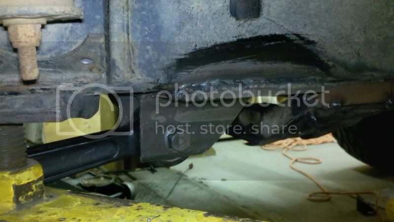

i got the frame braces welded on and the engine mount reinforcement plates on. I got one side of the coil buckets widened and welded up and need to weld it to the frame then on to the other side. I've decided that I'm going to mount the fj80 box at an angle like it is on the stock fj80 frame, this will allow me to get it closer to the coil bucket tower and have the drag link a little closer to parallel with the pan hard bar.

Plate welded on

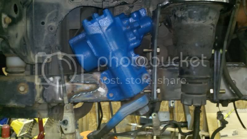

approximate location of the steering box...yes its still blue from a friend of mine painted it for his build and ended up not using it..I'll get around to stripping it and painting it black...or maybe yellow to match the springs...

plenty of penetration

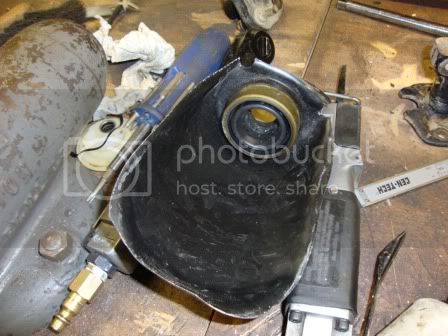

Stock steering double joint has locator balls in it, i ground those off so they wouldn't interfere when it goes straighter
still working on making this still seal up

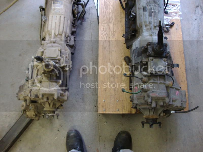

1998 4runner limited trans and tcase on left, 1996 t100 trans and manual tcase on right

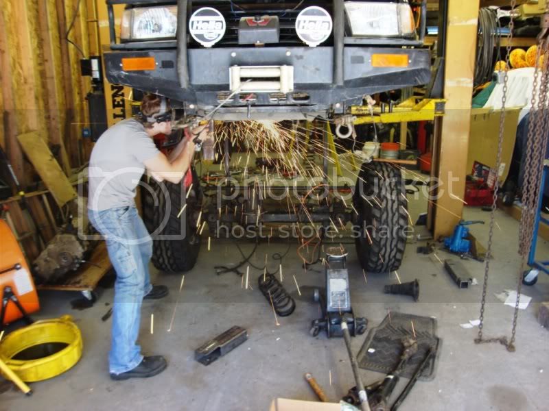

me at work grinding...damn i hate grinding

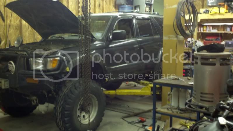

a little bit high for my liking, this is with 4" lift coils in the back and just held level up front, Frame height 26-1/2", My design is for 23-1/2" to 24" so i'm going with stock height lc springs just possibly heavy duty

Got a couple things done this weekend. I got the steering box 3/4's of the way mounted... i need to grind off some of the extra material i put on top of the frame rail for the 4th bolt to go. I am going with the steering box on a slight angle...not quite as pronounced as the pictures above though. I felt this way the best way to keep the drag link closer to the panhard bar and maintain a good angle of the drag link, approx 6 degrees. with the steering box flat on the frame rail it brought the drag link up to 8 degrees and with it on the course angle it was about 4 degrees. more on this in a minute
