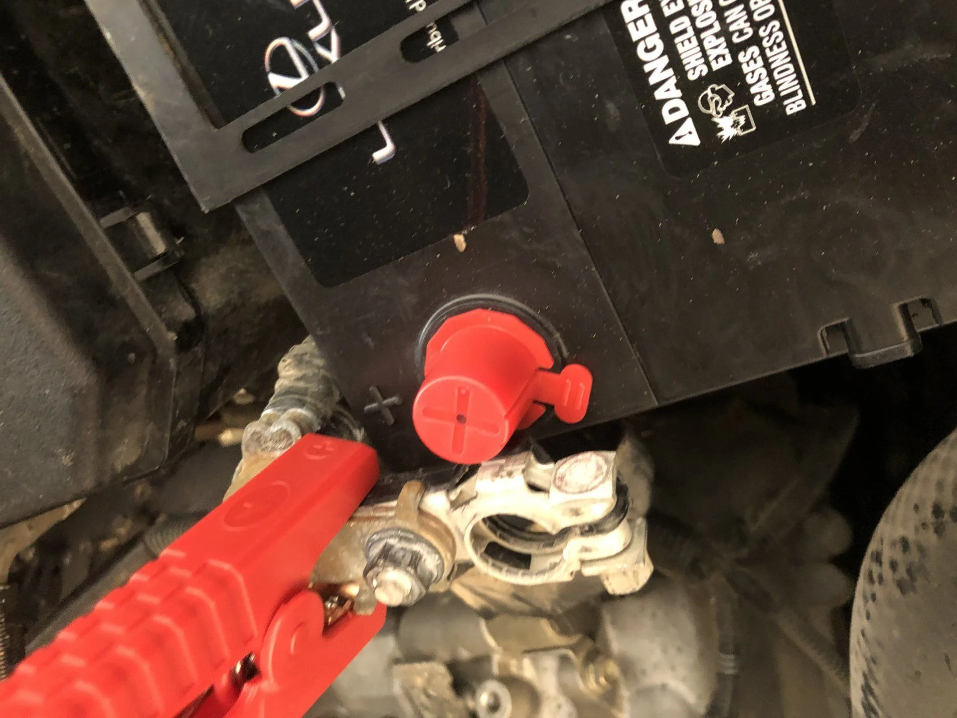

Tried this little experiment today. Ive been wondering if my amazon lithium jumper was really a good BU. This morning my lex battery died. After the lithium jumper stuttered a bit on the first attempt, second got me going... and thinking. Will this thing work half dead? What about no battery? I picked up a new battery from lexus but didn't hook it up. I just hooked the lithium jumper to the cables. I didn't recharge the lithium jumper first, so it was half dead when I started.
First attempt no clicks. After pushing the “force start” button though it fired up and died right away. Third attempt fired right up and purred.
Thought that might help if anyone was on the fence about using one as your BU offraod.

I wasn't really thinking of a situation where I would need to use it without the battery, I just wanted to stress test it in case I went out 2-3 days and left the lights on until it was double dead.
I though you had a dual batteries? How did your fridge kill the starting batt?
I do have dual batteries, but they're getting tired and I think I need to switch my battery cables.

Apparently, some Lithium jumpers have a very high voltage output and can damage some vehicles. I would tend to leave the old, dead battery inline to act as a buffer.
But, very interesting to know that this jumper could fully start the engine alone!
