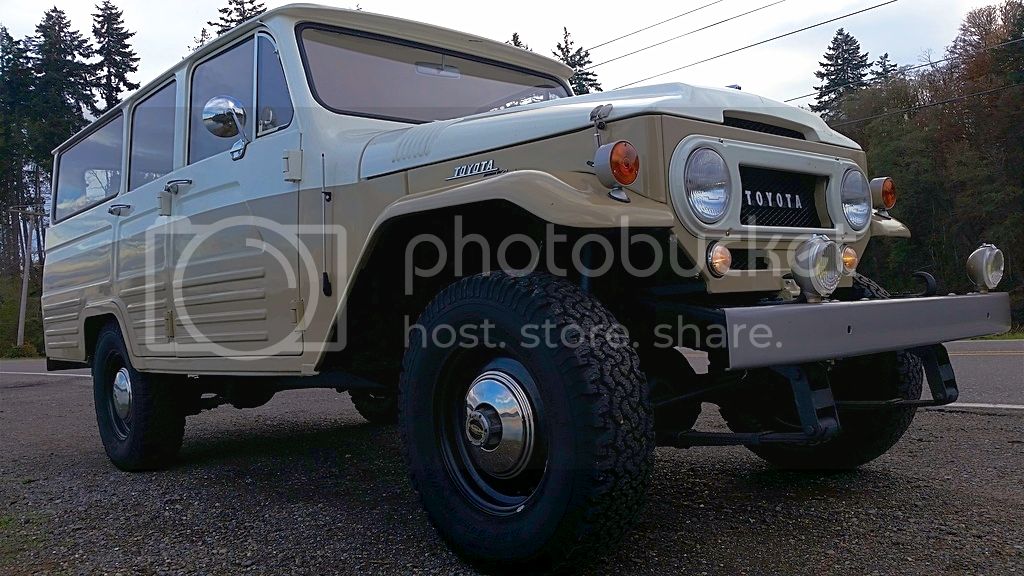

Kinda torn on what to do with my 45LV.....I always figured I would do an OME suspension on it, just like all my others, but with the new wheels and caps.....I am kinda digging the low look.
other issue is I have some tall aftermarket shackles on it(with what I am sure are the original springs) which has messed with caster, I need 4 deg shims to make it handle correct(steering is amazingly tight) but the caster makes you really have to pay attention. So If I do shims, i need longer U-bolts, then I might as well replace all the old bushings. Then will need to get rid of the driverside lean. Also would not mind another inch of lift. Labor wise I bet I am better off with all new OME. BTW, it has OME shocks and stabilizer on it now(so don;t need those)
So by the time I am done messing with all of this...it may make more since to do a whole new suspension. Which also means new taller tires, and seeing how 33x9.5's really look the best on the 45LV's....and they are long gone(but I have 10 or more with good life left) it really means I am looking at 33x10.5's
I dont see me changing the motor, the original 1F runs super well(besides needing some valve seals)
Brakes are all new drum all the way around.
what do you guys think?

What a great looking wagon! I sure do love the 45LV. If you don't mind a comment from a 55 hack, I'd raise it a tad, all new stuff with a better ride and a better look. The lean will be gone and the wider tire might look better with a lift. Either way, she sure looks good!
How do you use it? Are you just bored and what a change? The ass end looks really low. Mine sits alittle higher in the rear and my 33 x 1050's rub the back edge of the wheel well while out wheeling. It's even worse when I have my camping gear back there.
Hey Landpimp...this is actually a Wyoming DirtWhore. As you know, I did a frame off on my LV. I did use the OME with fj60 axles and started with the 33 x 9.5. I then had to change to 10.5s later. That rig of yours looks so good, you can do whichever. I do prefer a slight lift that doesnt look lifted...I think the OME does that. Always enjoy seeing your stuff!
Yeah, she sits too low

Use....going to use it more for work , mostly just around our small town and rural back roads. for years I was kinda afraid to drive it was so clean, changed my mood this year and it's time to use it more, if my beater 45lpb can make me money in RE the 45LV will do the same and better. cruisers are kinda my trademark in local RE.

If you don't heavily wheel it, then stick with what you have.... Maybe new shocks with extended shackles in the rear and some 31 AT's would be the perfect compromise.
Zero plans to wheel it, sorry to say. but might end up with my old Jimmywagon back one of theses day.....and that can be wheeled.
Shocks are OME, put them on when I got it, painted black to look stock
Rear already has the same extended shackles as front. the stock Springs are very flat
I think by the time I try to work(and try to improve) with what I have, in the end I bet I wished I just did OME....both money, time and ride....I'l be ahead.

I dont think you will be disappointed. I always kept things stock, but have come to the conclusion that some things are being considered by collectors as "better than stock" and not discounted for not being original....OME is one of them. I dont think mine lifted it 3".
Look I'm only from Australia, so my opinion probably doesn't count for much, but I saw go an inch or two and run 32's or 33's, but skinnies.
stock pretty much always gets my vote. but is only a set of springs; keep the originals and do whatever you want tis easy to reverse.
Leave stock they are very rare.
