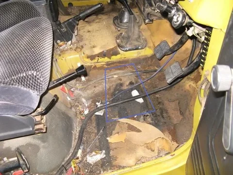

I don't know though, because my troopy has a distinct lump on the RH floor pan - I think to clear the fuel lines for the water separator. Don't know for sure though. Here's a photo of the lump I'm talking about (in blue box):
This lump is not present on the LH side, and I don't know if the 40s have this, but I would love to know.
In any case, you should be able to cut around this lump, leaving it in place, and welding the new floor around it.

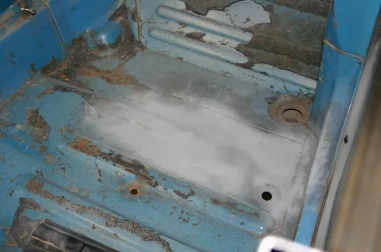

Here's a LHD US-Spec 1979 FJ-40. It also has that hump.
That is all stock, except the rib that I shortened (it's been primed gray). I would just order a right hand floor pan for a 79+ 40 series. They are looking the same to me.
