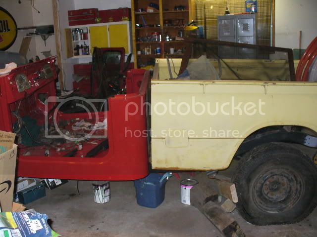

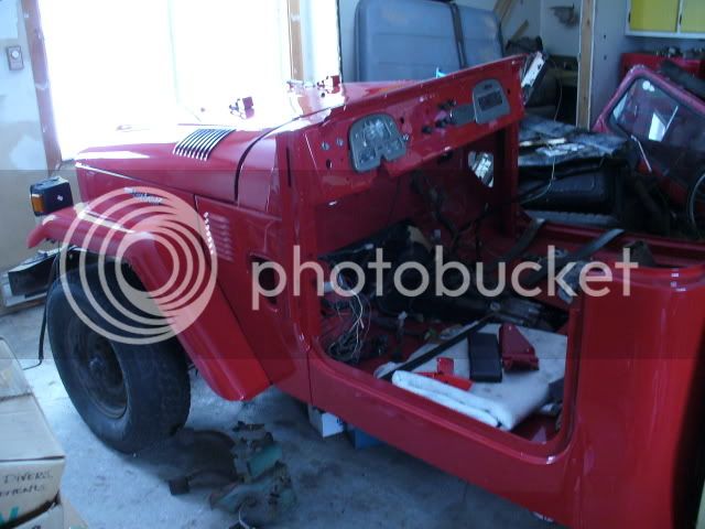

At this time the project look like this.
The bigest challenge will be the bed.
You can see the build up here. http://quebec4x4.com/forum/showthread.php?t=13696&page=5

And even if my fj is not an fj45 do you think it worth something?
Is it a chopped 40 cab and stretched frame? Reguardless, it looks like a 45 to me. A nicely built tray-back/flat bet might bring more than a bed from a different model but it really depends on the buyer. Nice work.
It a fj40 and yes it's stretch frame about 3' .
The box was the initial project i buy the Stout for the bed ,before the fj40 base. Before i start the project i only saw one fj45 it was Robb Ruthledge truck front cover for the top truck !
So i got some parts from everywhere .
And the i found Aqualu but the frame was aleready chop and stretch .
So the bed they sell can't fit for the wheel base...
I know that! The bed is from a diferent model (better then the ford courier i saw lol!) No serious it came from a toyota, a rare model ...
Will try the flat bed idea if it's look too odd .
Thnx..Marcf.
