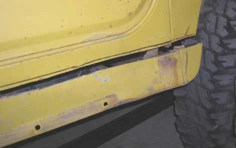

Here are the photos of mine, i cut about 1/4" below the floorboards due to the rounded corners on the square tubing, i still have not put on the square tubing.. I ended up getting some 2" Square for the sliders.. im going to weld them to the body..
more to come once i get it finished!

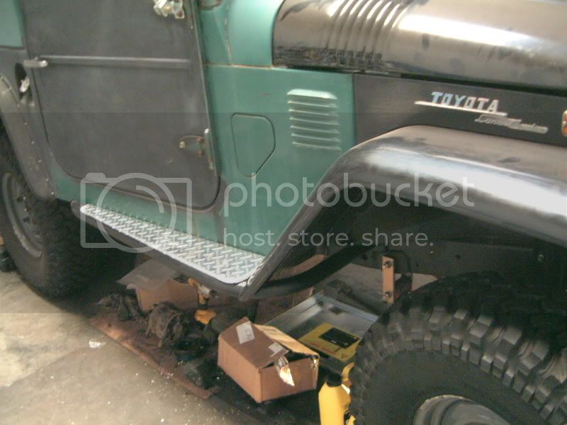

I removed 1 1/2 from the bottom and an additional 1/2 where the tubing goes into the frame.
Since the tubing is 2" in diameter, the ground clearance is close to original.
Sometimes I think I should have removed 2" from the bottom, but you know what they say -
It's always easier to remove it then...
manny
