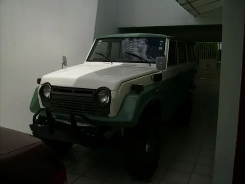

hi here is a pic of the location of the 40 mirrior on a 55
1975 version adquired in Costa Rica

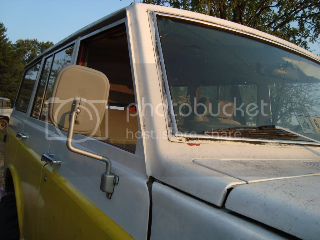

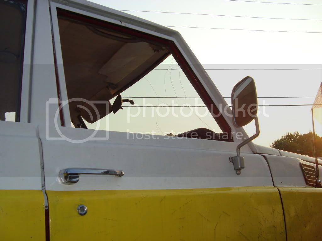

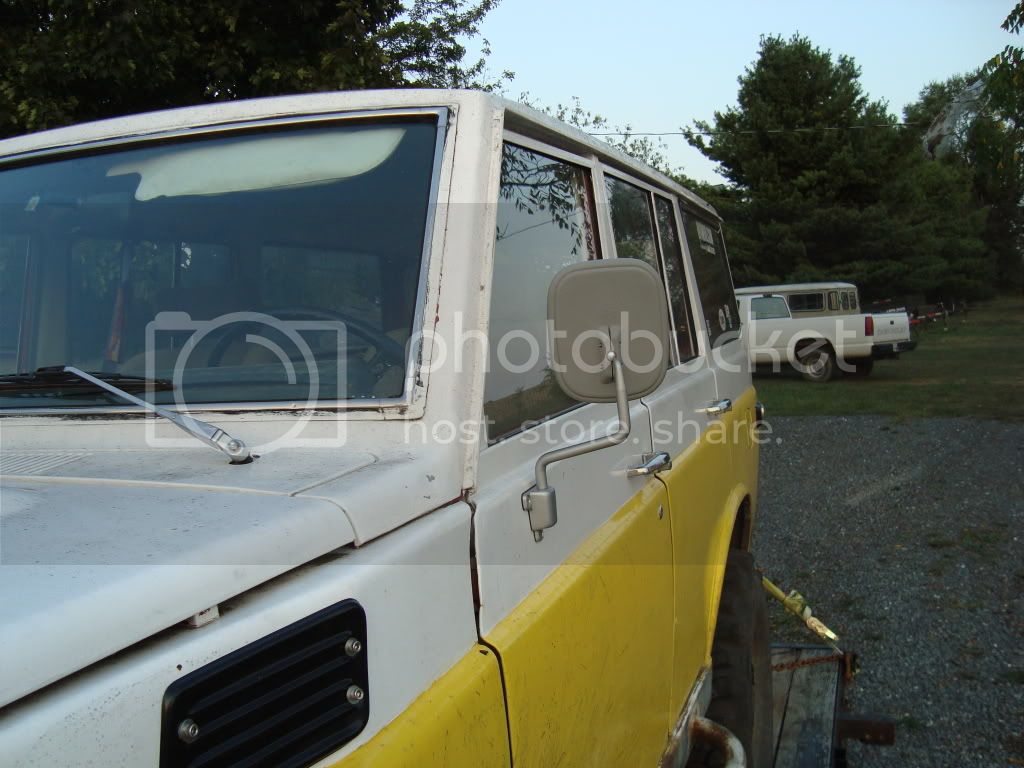

One of the last mods that I did was put the 40 mirrors on my 55. I had them for a while, but finally got around to putting them on the day the pig was being picked up.
:confused:
I like 'em.
Are the two upper holes the same distance apart as the originals, or did you have to drill new ones? It would sure be nice to pull the mirrors in on narrow trails.
interesting about the 55 56 thing... But do the 40 mirrors bolt right onto the 55 door using the two exsisting bolt holes on top and adding one for the third hole on the 40 mirror, or is it a complete cut and weld job? What are the centers distance of the two top bolt holes on the 40 mirrors?

THANK YOU , Old FJ40! Way to save a thread! Looks like the blot might end up in the factory backing plate maybe. Just a drill and I wonder if I can get to a nut w/ the window up and the door panel removed. Now I just need a set of useable fj40 mirrors!
Nice tid-bit, Hicruise55!. I looked into my door today, and it looks like if I were to use the factory hole closest to the rear of the front doors, and drill the new hole closer to the front of the door, it will still be in the backing plate inside of the door. Pretty sure that I can get a wrench on the nut on the inside of the door w/ the window up and door panel off. This is probably one of the simplest/ most usefull mods I've seen for the pig. Good job guys!
