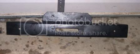

Here's mine. I got it from a fellow Mudder and did some work to it. The gussets are welded on.
BEFORE
AFTER
BEFORE
LD thats exactly like the bumper I had told you that I have. If you would like it (or anybody else) PM me I am cleaning house.
