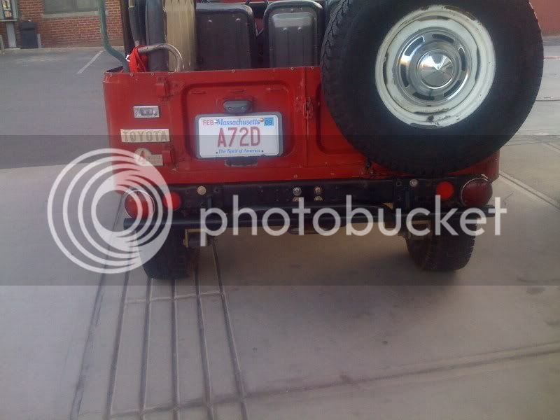

I know we are taking front bumpers, but I just added this...I need to add some grip tape so the kiddies won't slip climbing in and out.
Ohh...and don't worry, I have since added the remaining bolts, too.
