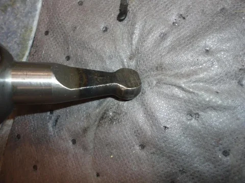

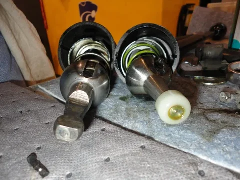

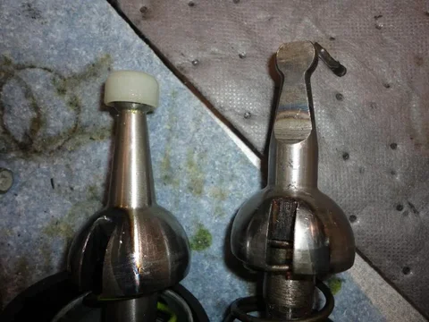

Here's some pics of my transmissions that might help someone more savvy than I to diagnose this problem.
Here are the shift levers for both the H42 and H55. The H55 has the circular teflon cap. The H42 has the machined flats on the sides.
Notice the bright wear mark on the H42's lever?

Does anyone see a smoking gun? I think this is likely a cover plate/shifter issue rather than a major gear problem.

Thanks for you pictures! I think I have found my problem. Did the bottom half of mine break off? Or where some like that? Anybody got a shifter??
Broke off or worn clean!? But the better question is, where is the rest of it? Id drain that tranny asap. What goes in must come out (hopefully without bits of gears in the process!)
Wondering if I can weld it up and then grind it down to the correct size? I'm fairly good at welding. Anyone have the correct dimensions for a stock shifter end? Or a whole shifter for me for that matter?

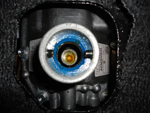

Hey guys so after reading this thread I pulled out the shifter. After inspection I noticed it looks the same as reeevesc spare shifter!
Now I looked inside the the trans and this is what it looks like inside! Is it the rollers that are bad as to why it won't shift into second? Tell me what you think !
So my question is do I need too replace the top end of the trans?
Or do I have a more severe problem like a synchro gear?
The slot for the 1-2 gate (the middle one) is misaligned with the slots for 3-4 and R. Pry it back in line and see if it works better. If it keeps getting out of line, there may be something wrong with the detent balls/springs that hole it centered.
