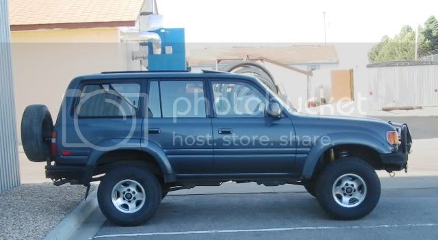

FWIW, I have not noticed any difference in gearing going to the 35's over the 33's. My ride home gains 1,000 feet elevation over about 10 miles from 6,400 to 7,400 feet, and it maintained speed as poorly on 35's as it did on 33's. I didn't notice any difference except maybe that in PWR mode (which I never turn off) it held the revs longer with the 35's, which is better at this elevation.
OD off runs a cool 2,800 RPM @ 70 mph (was 3,000 RPM on the 33's). As I expected from previous experience doing the same thing, the 35's are actually a better match to the stock gears than the 33's were. Where I really feel it is in the brakes. I have the slotted fronts, but she stops like a built rig now...

Looks great Ben. When you get a chance could you measure the rear from hub to flare. With my Slee 4" the rear is about 1 3/4" taller than the front. Just wanted to know the difference.
Darren
Front is 24" from center of hub to bottom of flare
Rear is 24 1/2" center of hut to bottom of flare
And the rear after 4 35" Trxxus in there....24" level and those tires are HEAVY and not fun to lift that high!

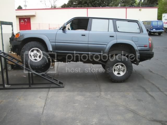

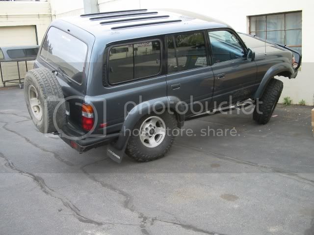

Here's my poser pic...got the rear bumpstops on...some rubbing on the rear mudflap...I'll need to trim! now if only we could get the front to flex more ;p I should start a thread about that...:rolleyes: :flipoff2:
not sure on the ramp what degree it is...but it's definitely above 20*
Personally I like the fact that the front doesn't flex as much. This tends to avoid the "tail wagging the dog" effect. With the rear flexing more and easier than the front it will follow the front and give a better control feeling to the driver.
But to each his own, I built an exhibition setup because it was more about the destination than the ass raping to get there. :doh:
