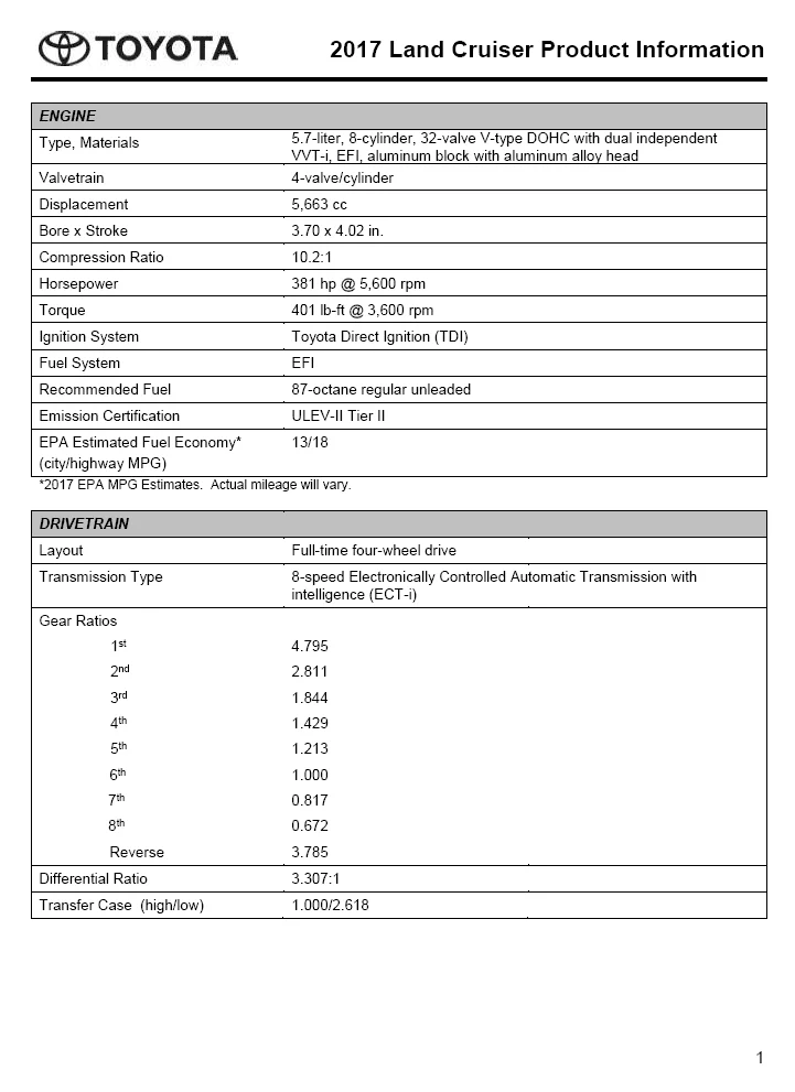

The 4.88's will be 47.6% "lower" (numerically higher) than the stock gear, which is 3.307. This means the engine rpm would be 47.6% higher in all gears. I calculate 2452 rpm at 70 mph in 8th with the 4.88's and stock tires and wheels. But, with the higher profile 75 tires, even on smaller 17" rims, you would be reducing the engine speed by about 7% compared to the stock 285/60-18, assuming the 285/75-17 is 33.8" diameter. So combined, the overall effect would be 37.2% higher engine speed in all gears. I calculate 2281 rpm at 70 mph, vs stock at 1662 rpm. In the non-overdrive 1.00 6th gear, the engine speed would be 3394 rpm at 70 mph, vs 2473 rpm stock.
The lowest overall ratio with the 4.88's in low-range and first is 61.260!! :) I'm pretty sure this is why all the rock-crawler guys like this gear.
So, this set-up would definitely give you more pull for a trailer at highway speeds, but your mileage may suffer...;)

The stock 200 is 3.909 fwiw, 3.307 is lower (numerically) than has every been used on a US spec Cruiser fwiw.
@cruiseroutfit, not to dispute you - I mean no harm, but I'm going on what I have from the Toyota Product Information for my 2017 LC, where from what I understand, the final ratio changed with the new 8-spd transmission in 2016. I didn't think about this with my response before, I don't know what year model @eizenjin91 may have. If it is a pre-2016 200, it would be exactly as you have indicated at 3.909, like the Tundra gear I mentioned before.
Ah, very interesting. I didn't even think to consider the 16/17/18 with the 8 speed. In fact that jives now as there are in fact carrier variances too. Interestingly the 2016 URJ200 we used throughout South America (pulling a trailer at 15-16k feet) didn't feel bad at all. The deeper 1st of the AE80F (4.795) vs the AB60F (3.33) still makes the 16+ a much peppier 1st gear. With that all of your notes are spot on, 3.3->4.88 is a massive jump, massive. 3.3 to 3.9 would be a noticeable and typical jump historically speaking.

To duplicate the final gear of a 2008-2015 with 4.88s, to a 2016+ it would need 4.30s. (because the final drives are different)
I've thought about this a lot as I love my 4.88s with this particular 5.7L and 6 speed, but on my parents 2018, they will probably be getting 4.30s. If they towed a 27 foot airstream or something crazy like that up mountain roads, then I see a need for 4.88s in a 2016+. If they have something much smaller like a Patriot camper and below, then, 4.30s would be the better option, in my opinion.
