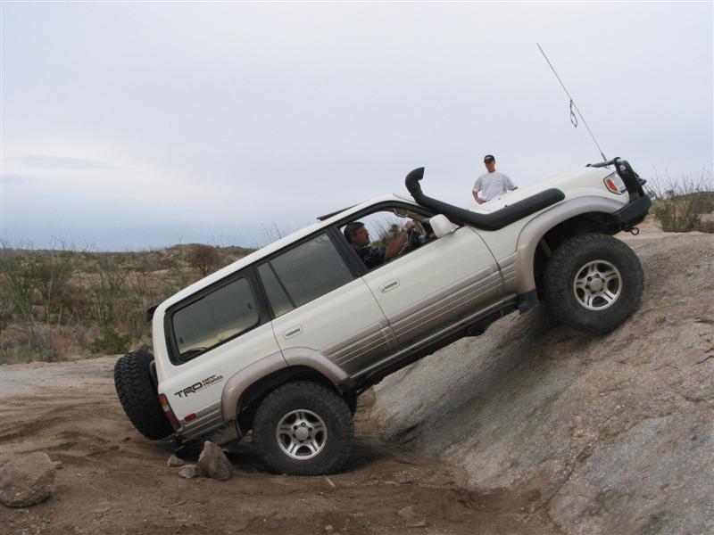

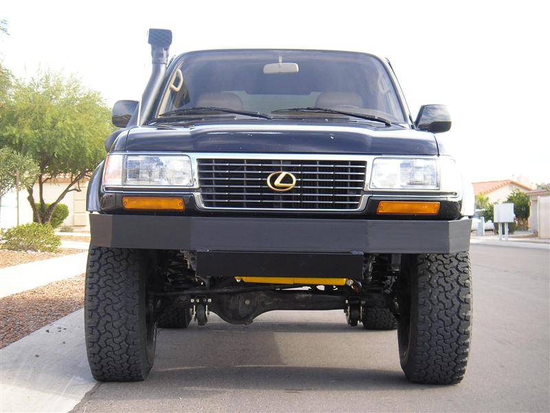

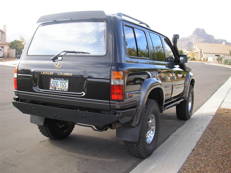

Pic 1: The typical loaded 80...he has to move way down where the rock face isn't near as steep.
Pic 2: A cut 80...BIG difference huh? I can drive head on and at the steepest part.
This helps on almost every obstacle.
Imagine now what a cut 100 will do on the trail? WOW!
Chaouleau Gap. This slickrock isa blast. With the front and rear cut watchers are amazed that I can pull stright up to the rock and climb without a slip. 80's have to move down quite far and my 100.....even farther...the beast!
