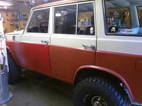

I just completed the 3rd member swap (3:73 to 4:11) on the front on my '79 piggy and now moving to swapping out the rear.
During this work, I noted that the 3rd member appears the same as front vs rear - makes sense from a production standpoint...
I have a pre '76 coarse / 6 spine axle parts from a trade taking up garage space that I thought were of no use to me. However, as I broke down the axle, I noted that the 3rd member end of the axle is 30 / fine spine - maybe useful after all....
So it appears to me that:
1.) I could use 3rd member from any year?
2.) I could use 3rd member in front or rear?
Am I right or wrong here?
Jeff
