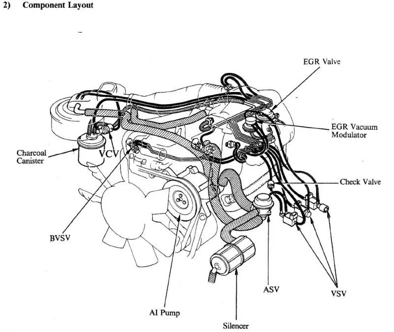

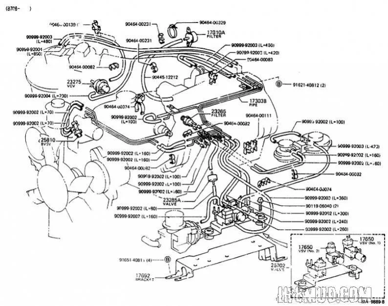

Here are some I have collected in order of good, better, best:
In the FJ60 that filter connects to the distributor cap. It is installed from the inside of the firewall under the glove box.
Interesting! I wonder why they do not show the other dizzy vent lines...

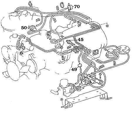

So I marked the diagram up a little to check the individual circuits for continuity, and also to make the changes to my circuits for Evaporative Charcoal Canister.
I also tracked the circuit for Fuel Pressure Regulator. It connects to the gas valve on the intake.
My hope is that this will help future searchers...
How the F does the gas Valve work, and how do you test it?
