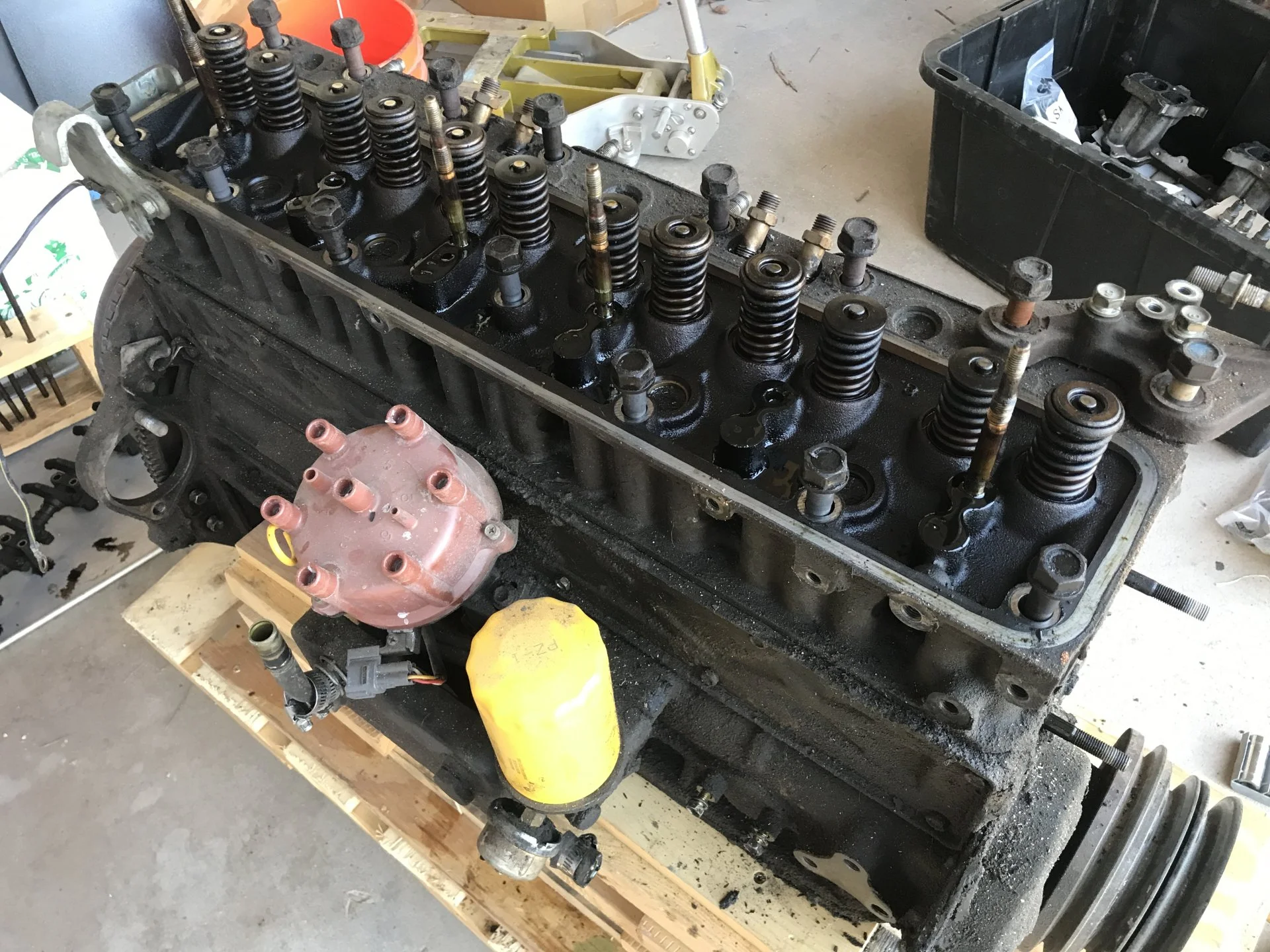

Last year I picked up a used 3FE & trans from a 1989 (same year as mine) that was getting a V8 swap. I took a little leap of faith with the seller... as all he could tell me was that the truck drove into the shop under it's own power, owner just wanted more of it. Engine was complete with ECU, harness, and all of the accessories minus the AC compressor. Reported with something like 220-240k if memory serves me right. I was able to turn the engine through by hand just fine. Pulled the valve cover off and there were no surprises there.
My plan was ... if the donor head/block are serviceable, rebuild completely and marry that with a new H55 & rebuilt xfer case and then drop it all in at once. Currently my engine & trans are running well, although I know of a few minor issues that go along with the 250k on my truck. (My truck thread is here: Builds - HELLO, MY NAME IS CLARK - FJ62 docu-series thread - https://forum.ih8mud.com/threads/hello-my-name-is-clark-fj62-docu-series-thread.1276319/)

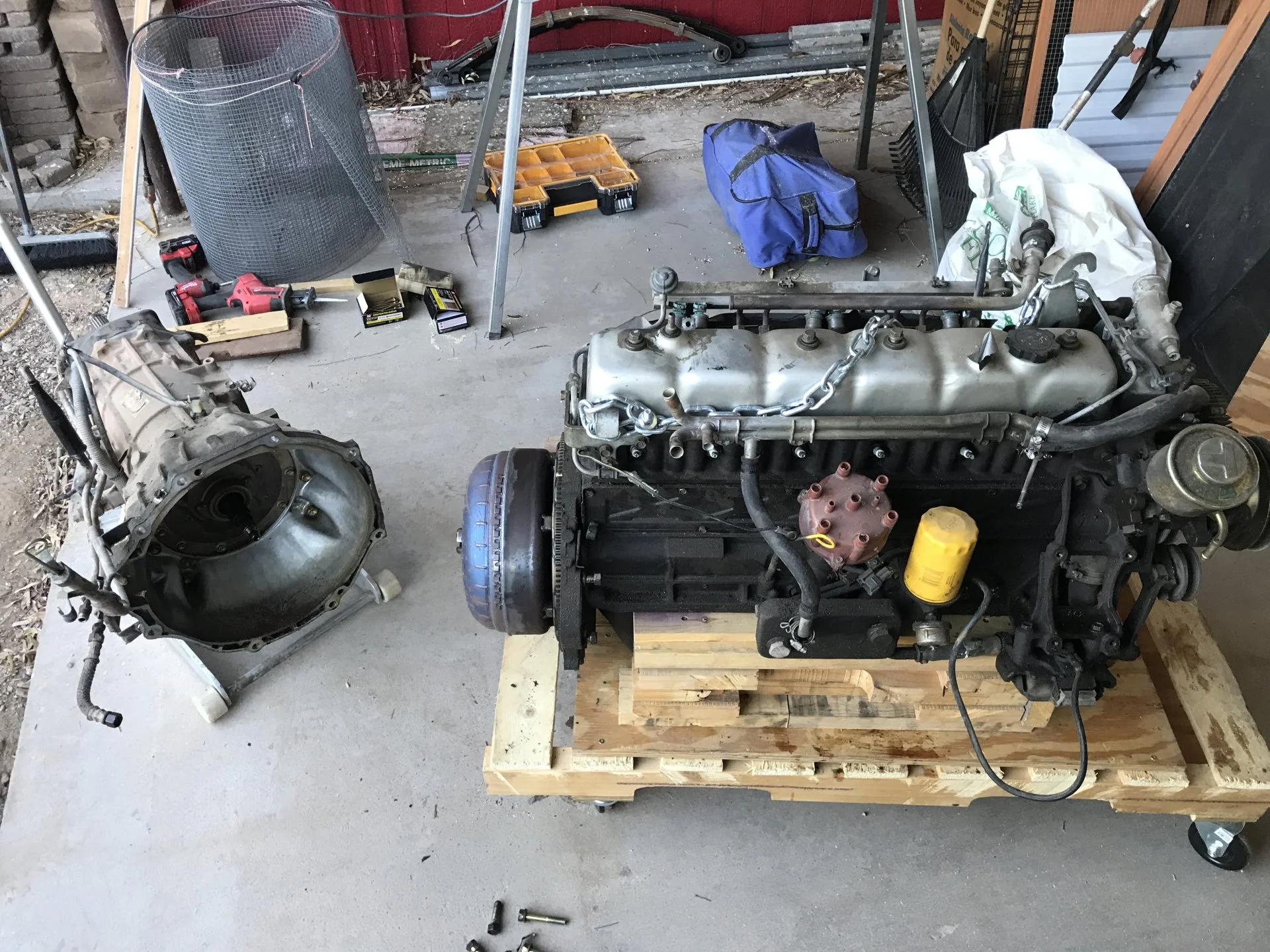

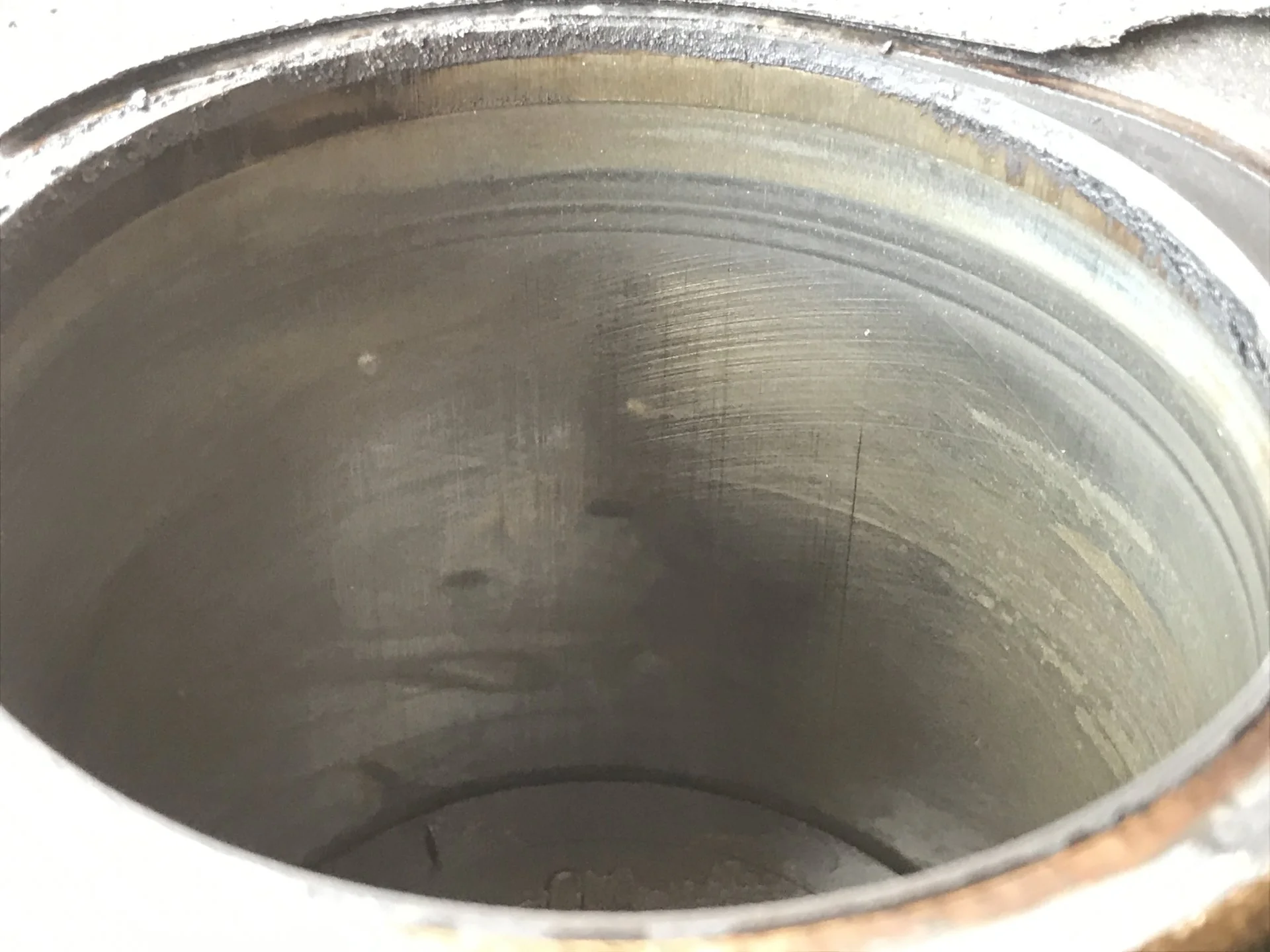

Finally got around to divorcing the transmission yesterday, then started stripping the head/block today and got the head off. Thankfully, no surprises, plugs looked good, head looks ok, I think the cylinders looked pretty good actually, could see the cross hatching still, and no lip on the top.
I've got a local contact for a machine shop that I'm going to reach out to tomorrow and see about getting the head gone through. I'm going to need a heavier duty engine stand because the one I got for my 83 Hilux 3RZ swap just isn't going to cut it. So I'll get to the block after I get the stand sorted out.
If anyone has any advice, words of wisdom, tips on the 3FE rebuild, please share. I'm hoping this can serve as a reference to myself and others in the future. There's a good chance I'll also eventually rebuild the 3FE that's currently in my truck at some point...

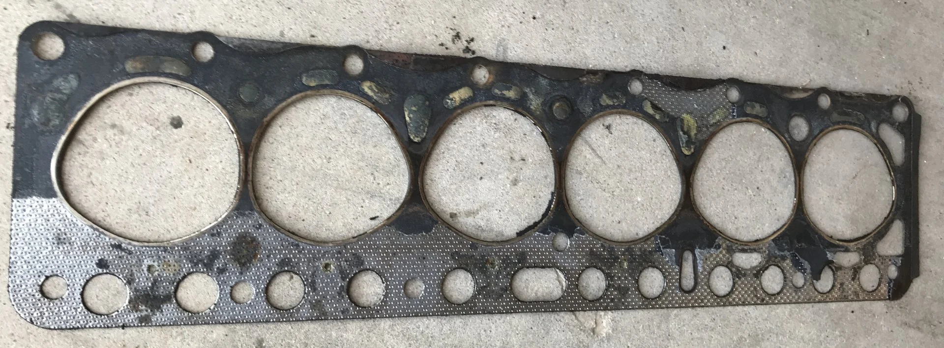

  2. I can't really tell if this engine's been rebuilt before (I suspect not), can anyone identify if the head gasket is OEM?

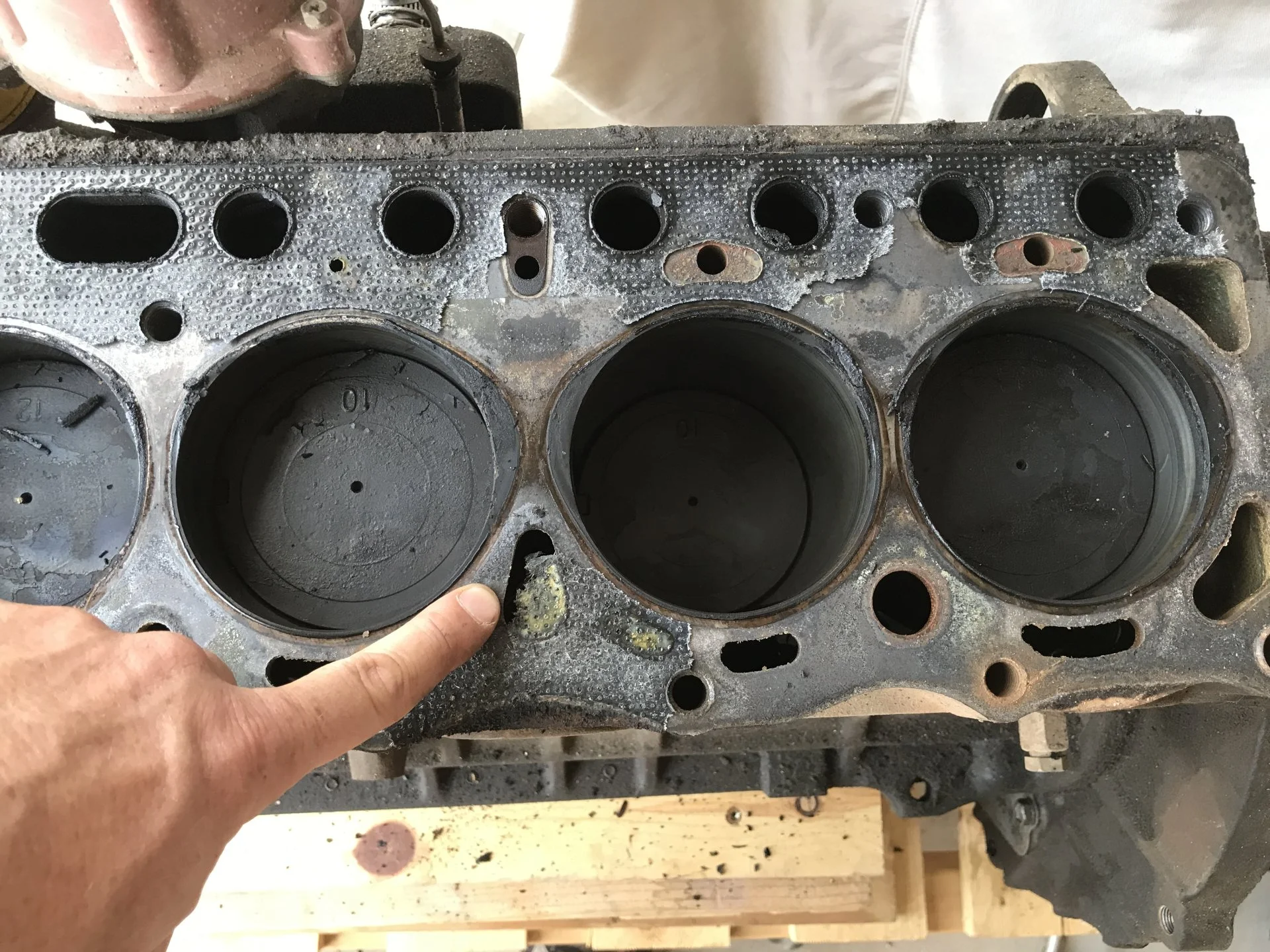

  3. in the 3rd pic I'm pointing to a piece of the HG that appears to be covering a water jacket opening... there were 2 of them covered... is that factory?

Here are my teardown pics from today.

The head looks like it’s never been off before — so head gasket would be original Toyota.
Not every hole in the cylinder head is a coolant passage, so that tear drop opening covered by the gasket is likely normal.

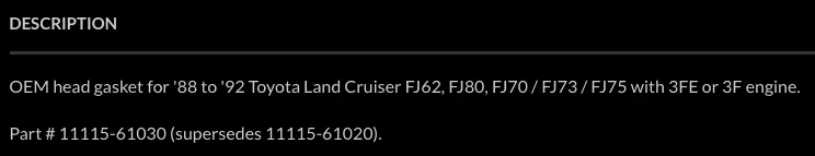

Ok thanks for the info. My understanding was that the 3FE OEM head gasket was NLA... I know a few of the usual suppliers don't have it listed... I'll keep looking into it.
is this the correct part number:
11115-61020
Thanks. Actually a buddy had contacted me last evening and informed me of a few places that sold the 3FE gasket. City Racer being one of them... according to their site the 61020 number is superseded by 61030. And then I found the 11115-61030 part number listed in a few other places as well. Guess I jumped the gun on the HG question =)

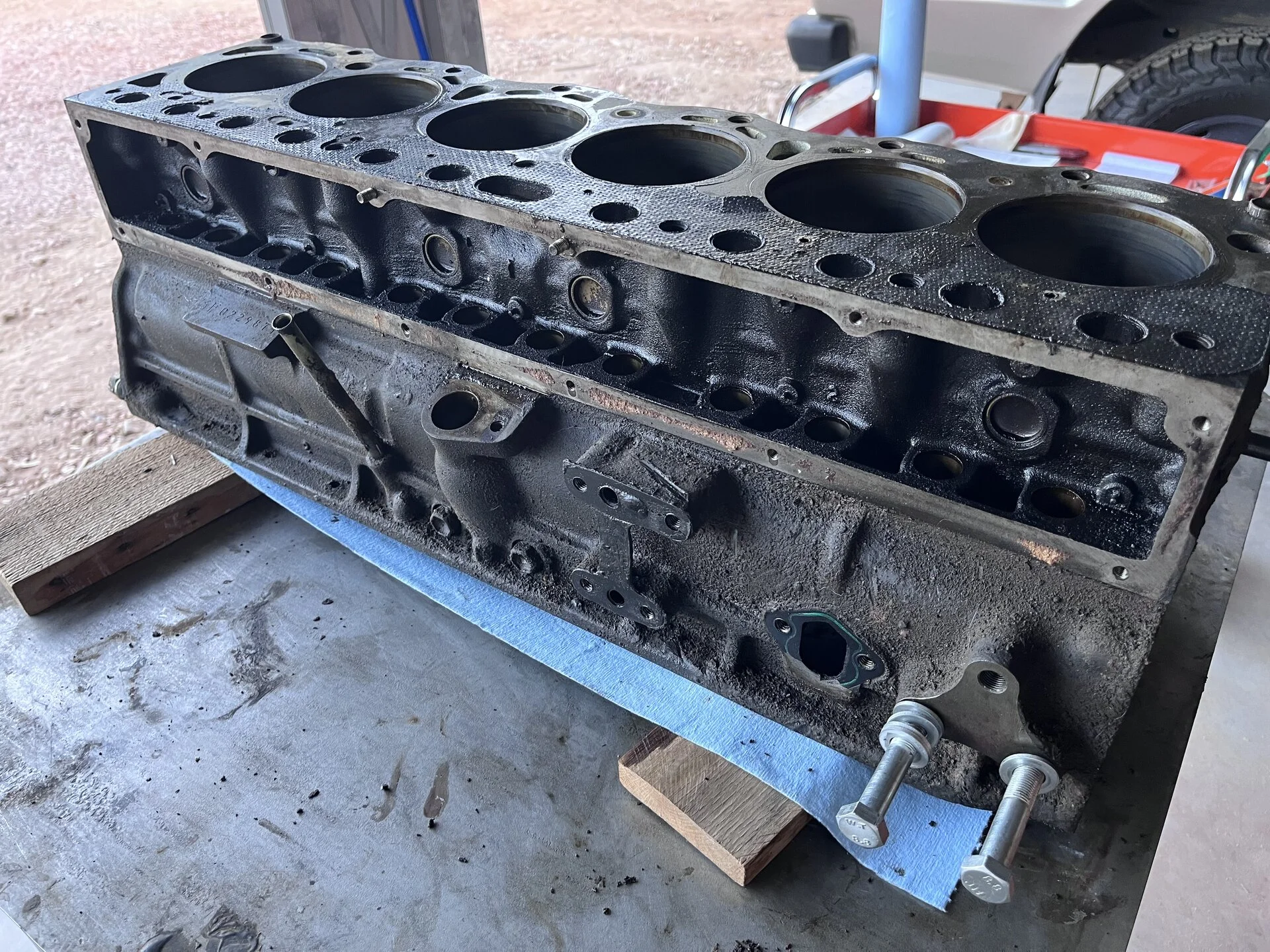

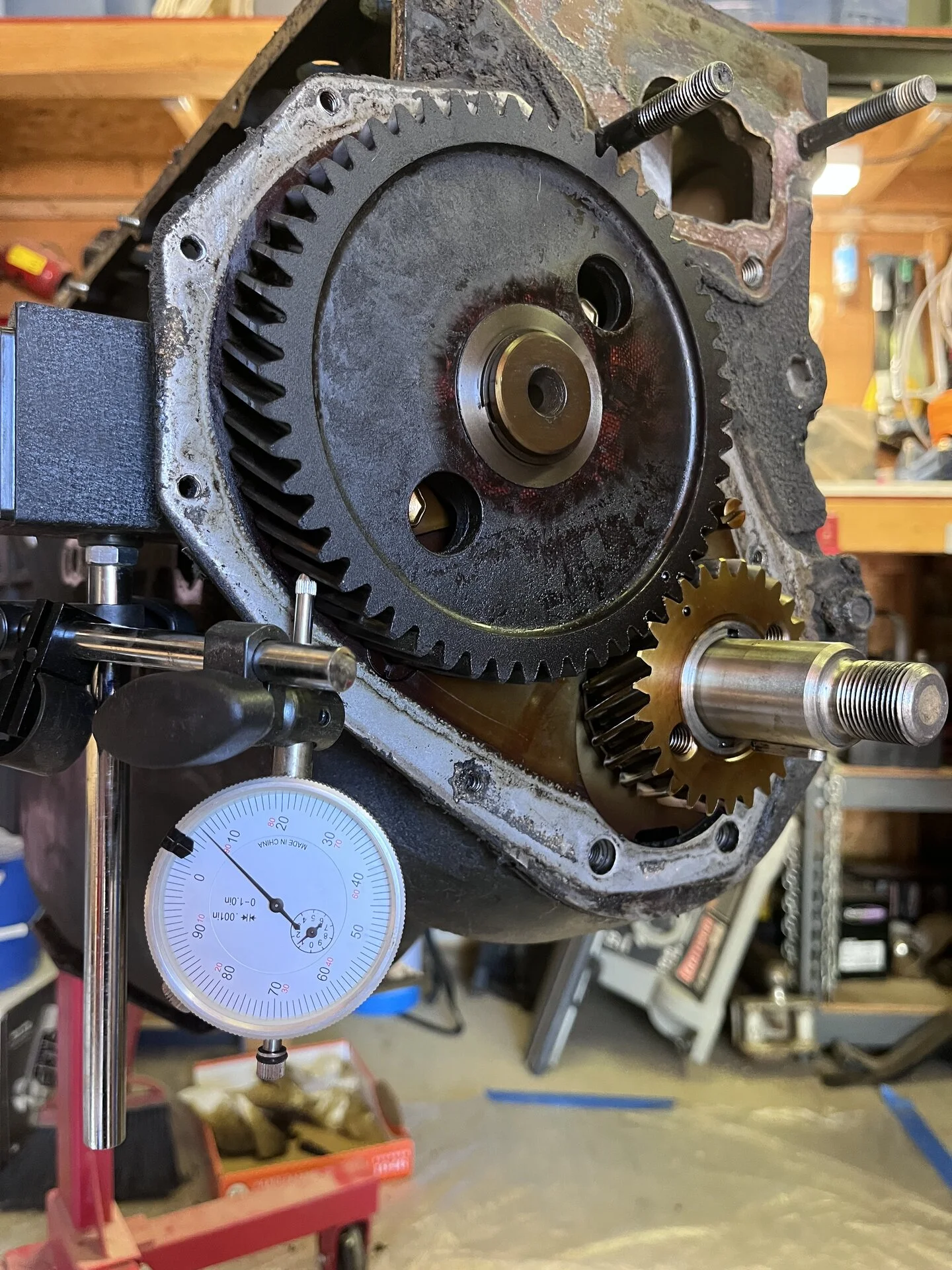

Finished the block tear down in preparation for the machine shop. Visually everything looks amazing, I’m having trouble believing this engine has 200k+ miles on it. The few measurements I’ve taken are well within “normal” service spec and nowhere near “max” wear.
