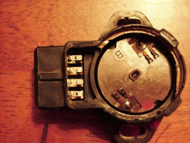

I pulled my TPS to check according to the specs in the FSM and found that the last 3 resistance values fail (see below).
I have been hunting problems on this install for a while. It seems like everything I investigate reveals repairs that need to be made.
So how hearty are these throttle position sensors?
Has anyone pulled them apart and cleaned contacts? If so, how long did that repair work for?

Answer to your first question is yes they fail and normally its the spring and I have one if you need it .

It still has spring in its function, it is just the resistance values that do not pass.

I just tested my TPS last week per the FSM and my values for the bottom three were off as well. (I was investigating a high idle) Following a tip from the #3E forum I loosened the screws on top and bottom of the TPS (bottom one is crazy hard to get at) an ever so gently rotated the sensor about its center while reading the ohm meter. I was able to get the values to fall with in spec pretty quickly. then I just tightned the screws back up and upon startup my idle ran perfectly at 650 instead of the regular 1100. Hope this helps narrow some of it down.
By the way. The 3FE write up I was working off of said if this doesn't work you'd better order a new TPS soon.
