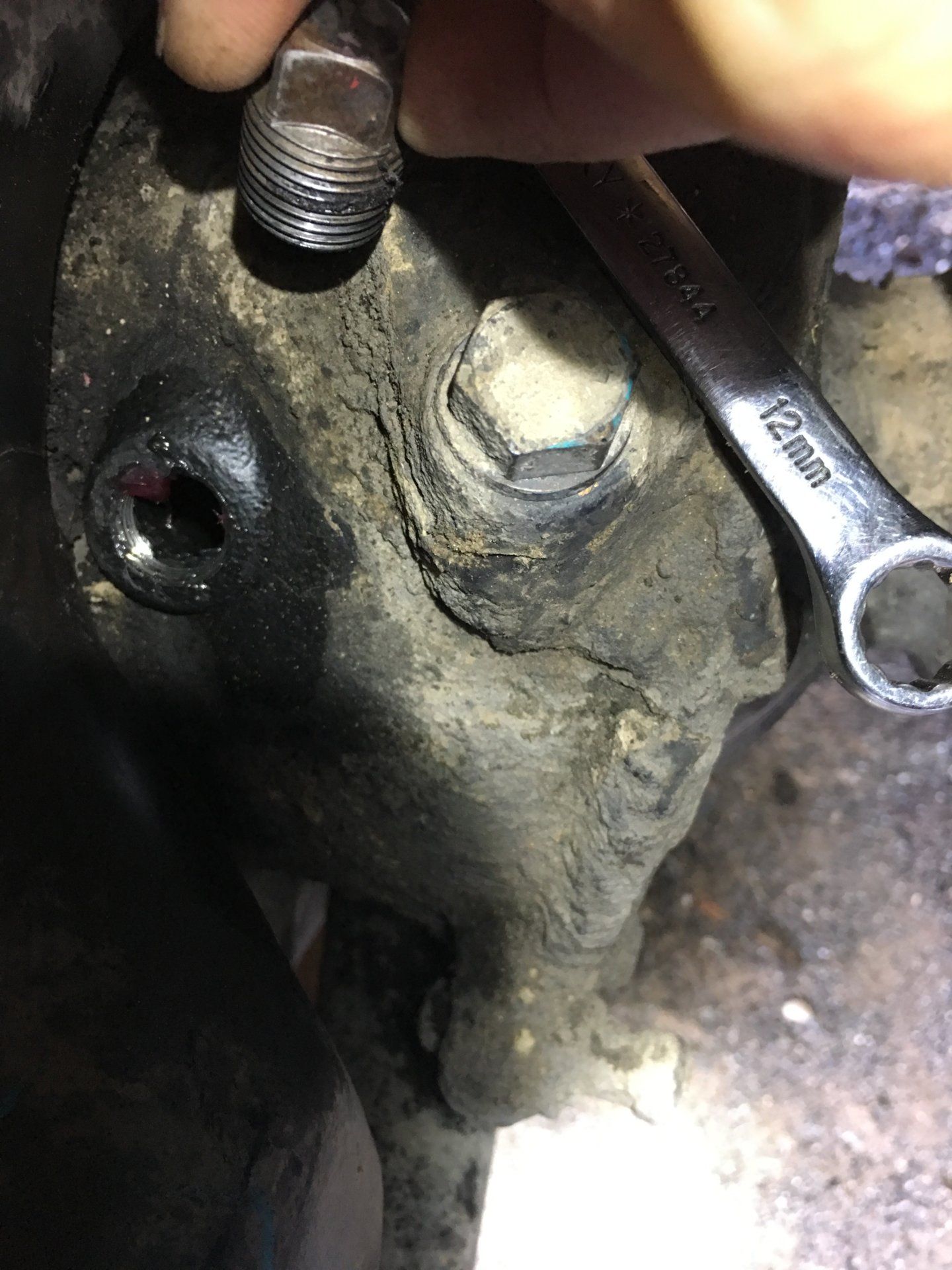

Just a reminder to all new owners that your steering knuckles need greased about every 75k (Haynes).
I didn’t get the memo or didn’t read the right forums, but mine just went 40k and the birfs started clicking. Just topped them off and it only took a half an hour.
1. Locate and clean plug so nothing drops in. It’s right above knuckle with a square head
2. Remove plug, poke in a zip tie or the like to see what’s in there. Inspect for gear oil, should not be runny or smooth.
3. Top off with NLGI #2: this part is under huge debate. I used 18 pumps DS, 30 pumps PS based on my assessed level. Will check again next week. normal top off Is about 6-10 pumps I think. Overfilling is not a major problem, it weeps out at the balls.
Inspect the knuckles for leaky grease/gear oil mixture too every oil change.
