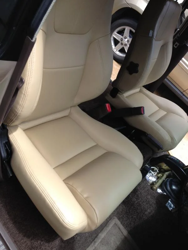

Full interior removal and over 150sf of Dynamat... painful but worth it... repalced door interiors with 95' leather door cards. Front seat are ProCar elite with Lumbar support ( they almost fit perfectly on the factory rails btw... no need for the adapter brackets if you're willing to hit the hardware store) Recovered rear seats and removed the jumpers. New wood trim and matching shifter boot and parking brake boot and full carpet kit...

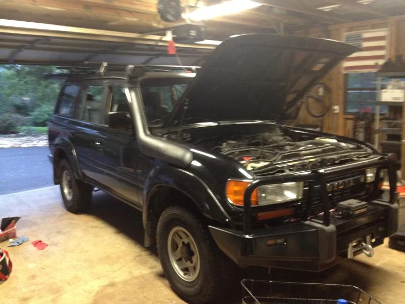

Have owned an 03 and 06 LC. After a year or so with a sports car, I decided to purchase a project LC for my sons and I to restore. So I bit the bullet today and picked up a 92 LC, 260K miles and plenty of wear on the interior. LC seems very solid, with just a few mods (snorkel, bull bar and winch). Immediate plan is to get it back to a very safe LC and use for the winter. Will begin rebuilding the interior, with any major work happening in the spring. Tranny shifts hard, kick down issue only I hope. Fluids will be replaced this week. Then go from there. Not much of a pic yet, will post better pics later on in the week. I look forward to surfing the forum and getting up to snuff on the 80 series.

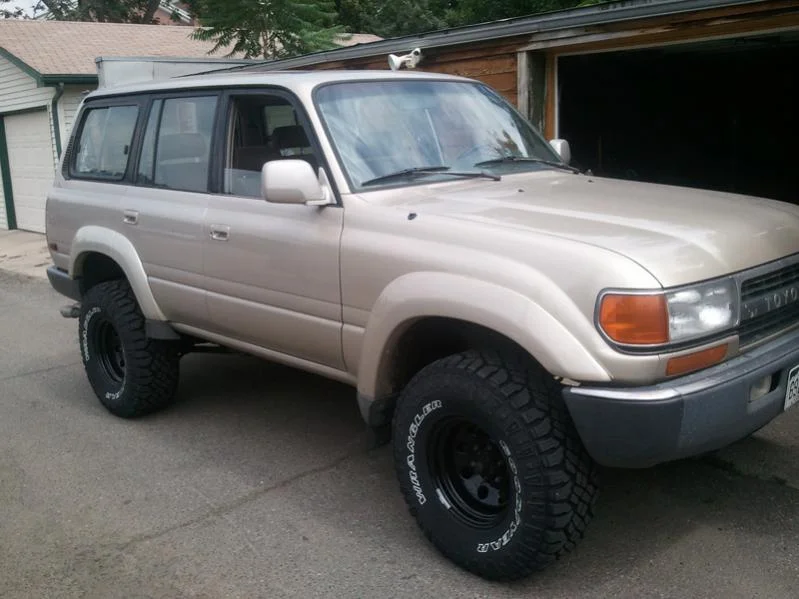

Immediately had to do a bunch of fixes which included:
U Joints
Trunion or Birf (Sounds like something from the mines of Mordor)
Tune up
Then was able to add:
3" OME
35x12.5x15 Duratracs (3.75" backspace)
I probably got 12-14mpg before the tires. Now I probably get 11-12mpg, but I don't give an eff because I look so damn kewl! :grinpimp:

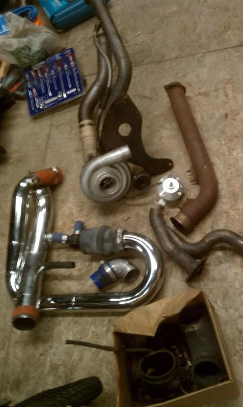

Going to start on my turbo build soon.
Got just about everything together... was looking to try and find some 3FE headers but came up short... oh well this will bolt to the stock manifolds..... then exhaust shop will do a new dual exhaust out the back
