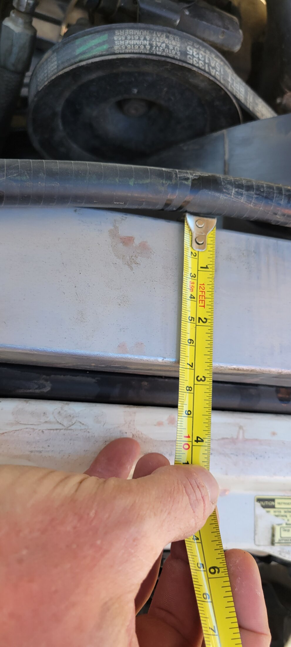

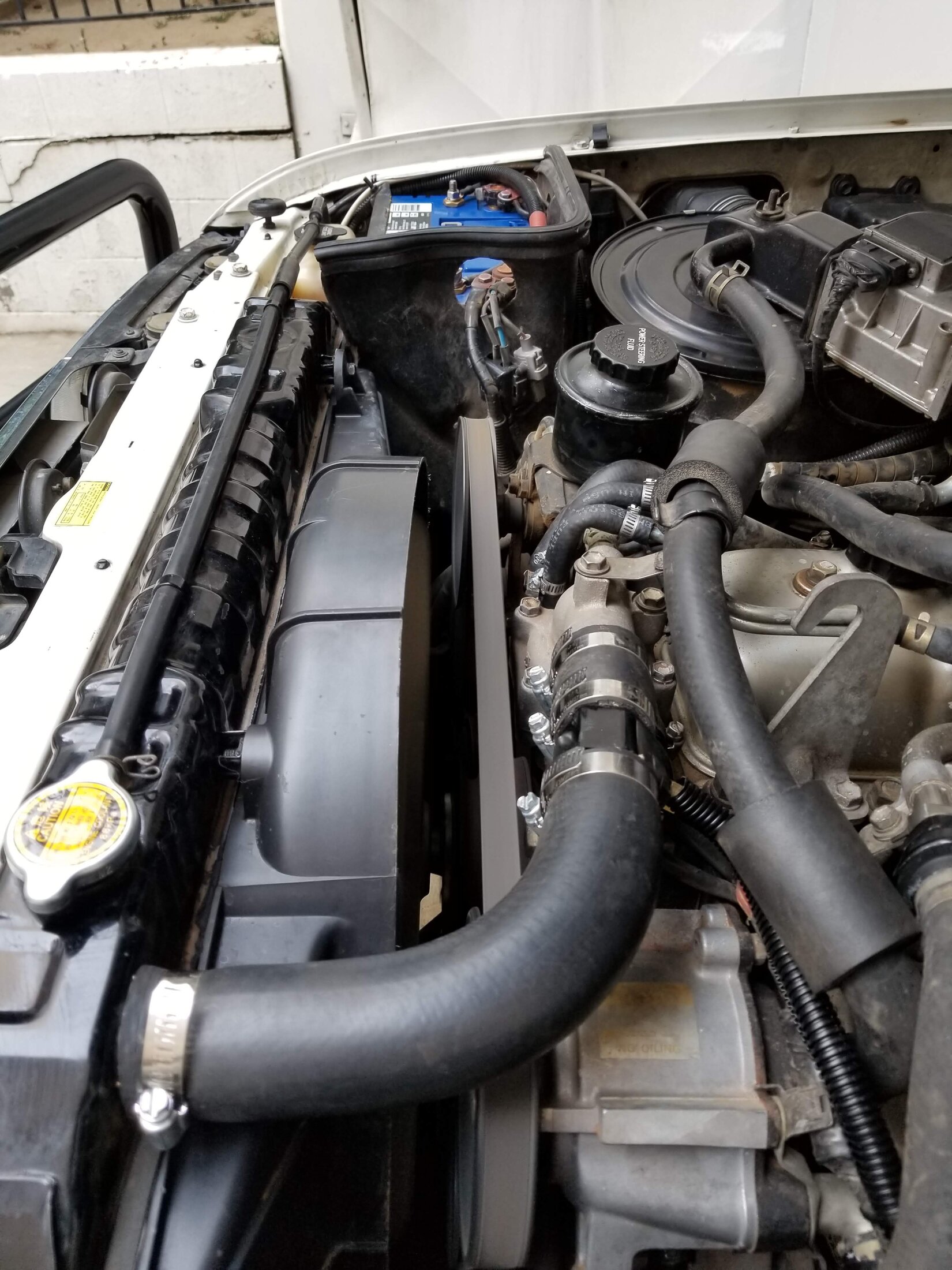

Can someone please help measure the thickness of the stock radiator? From core support to the back of the fan shroud?
I want to confirm if the aftermarket alum. radiator is thicker than factory unit.
My aftermarket alum. radiator is about 3 1/2" thick from back of core support to back of plastic fan shroud.
thanks,

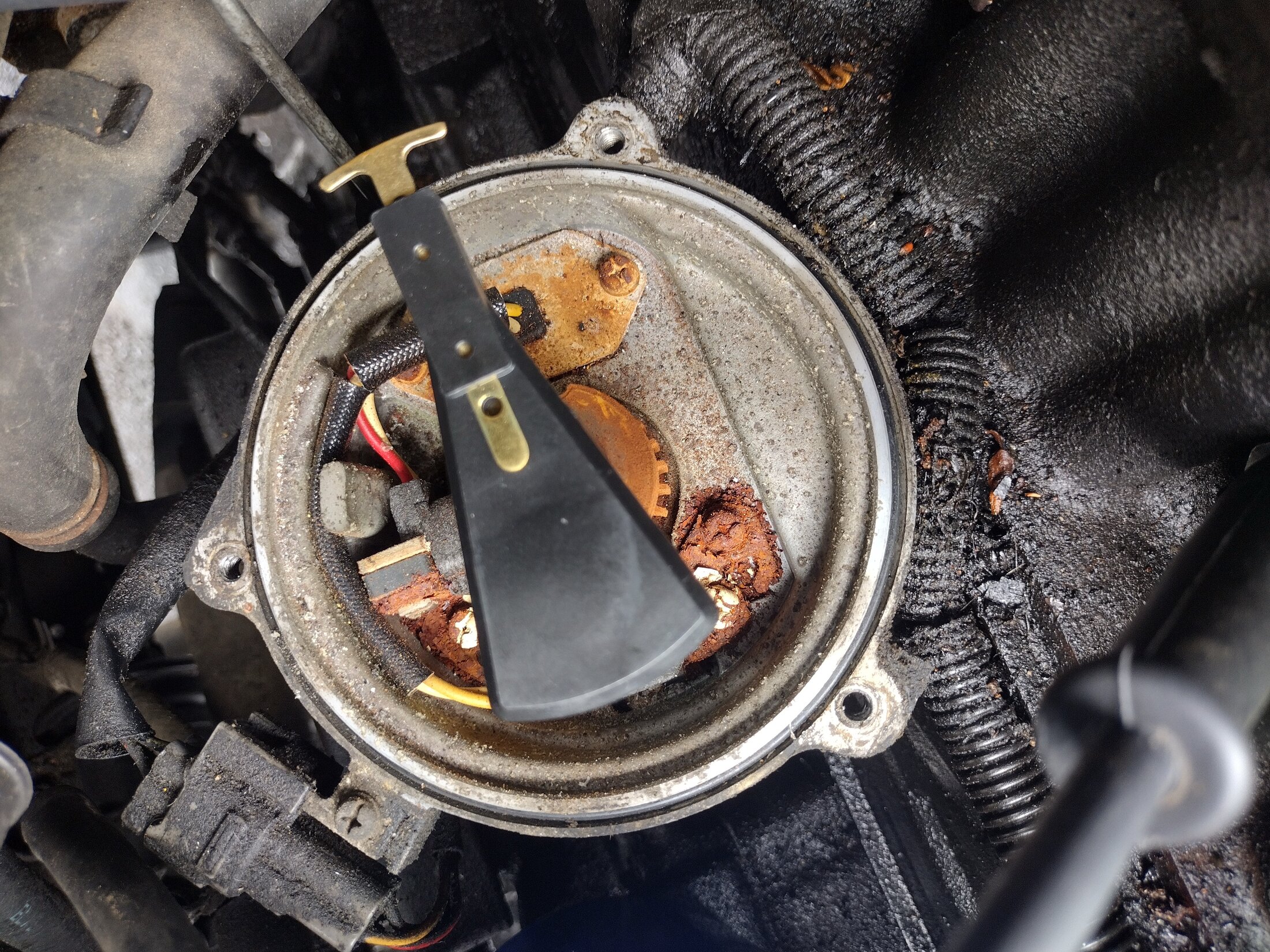

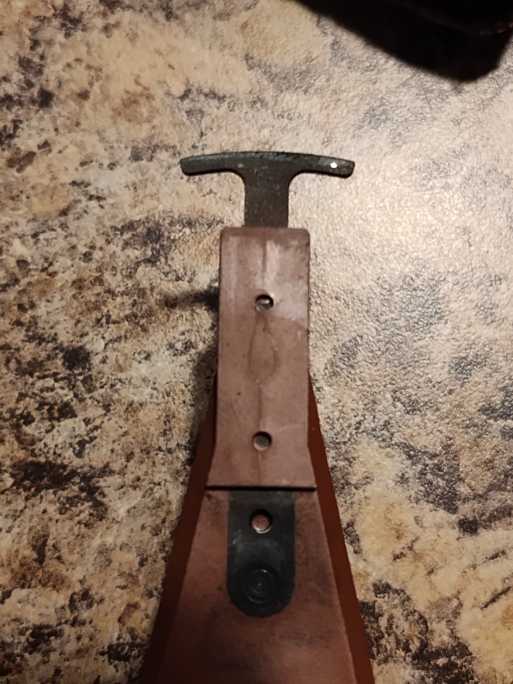

Changed plugs and wires. The plugs were burnt. Ran for a week then wouldn’t start. I had ordered a new distributor cap and rotor button. Weird thing is it would start up sometimes but not every time. So I just changed the cap and rotor. It was corroded. My distributor it’s self has some rust inside it look at the pics.
thanks,
View attachment 3678802View attachment 3678805
Hey Nobody!??????
1.7" thick core seems to be a bit thinner than most alum. radiators i would assume? But my measurement is from the top tank, so naturally that would suggest a bit thicker on top...
thanks,
@Marco Lau: My radiator measures 3-3/8" to the outermost lip of the radiator. Pic is a bit hard to read...
Let me know if I can get some other measurements.
Cheers!

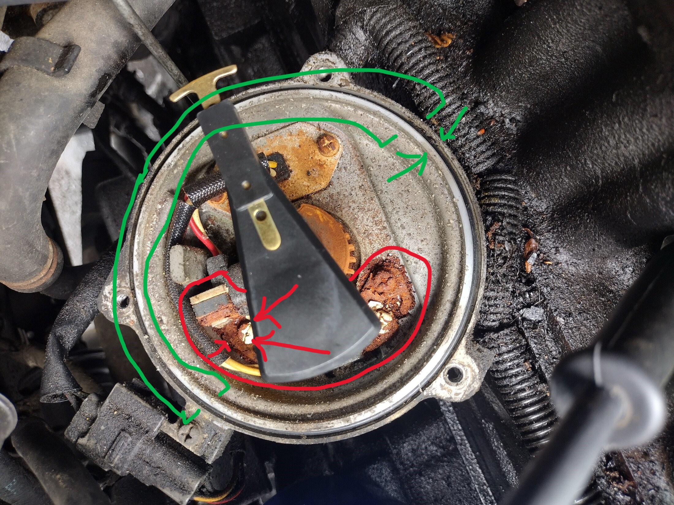

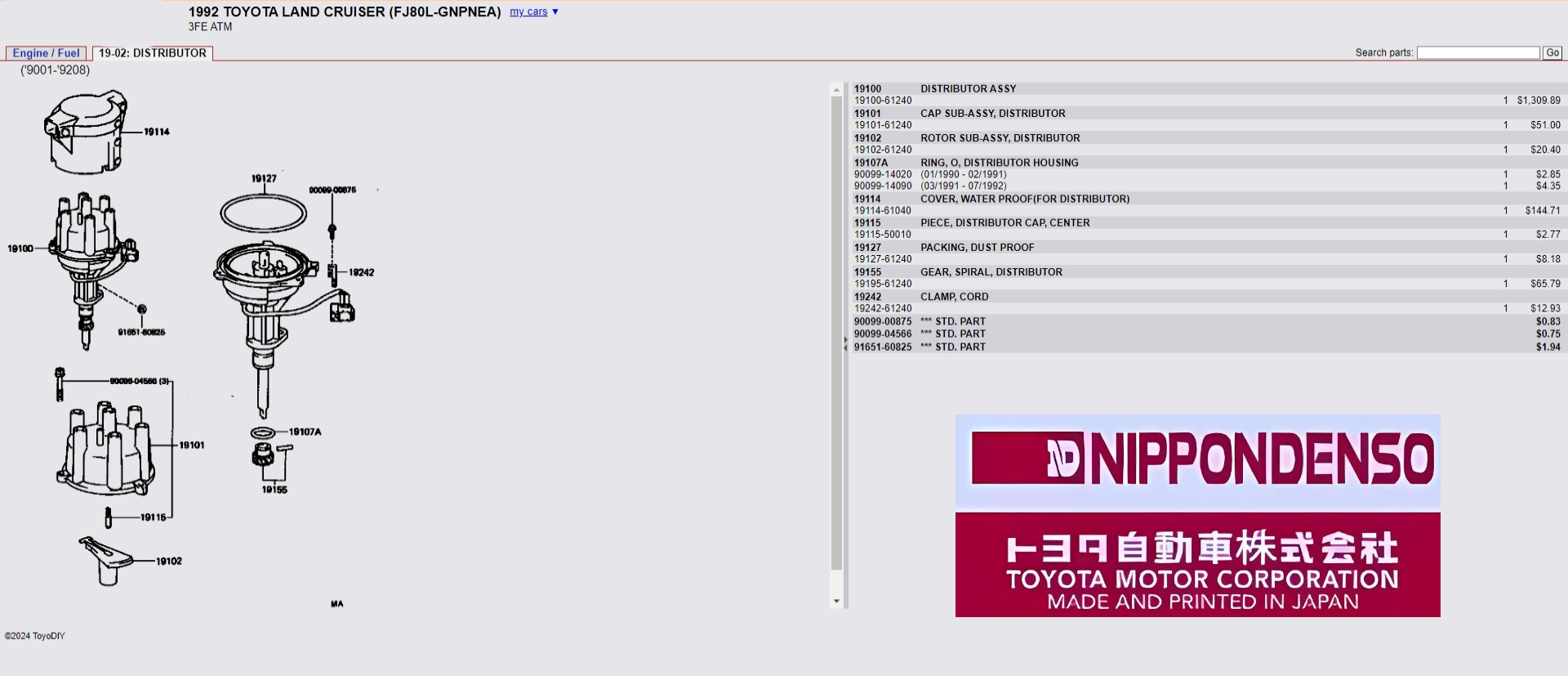

Your ignition issues are Not simply isolated to a Major Tune Up & its common parts here ....
all 3F-E Distributors have a ANTI-Moisture set-up via the 2 different size 7mm & 9mm one-way air flow vacuum hoses
in your specific case , your
Green INK ( Packing Seal ) or Tiny Spaghetti O-Ring is simply 1/2 gone , this allowed water and rain and general moisture to migrate inside and hang out for a while and do the damage of Corrasion i outline in red Ink
also , that cap and rotor are Not Genuine NipponDenso OEM parts , any ones local TOYOTA dealer parts dept. can order up all the correct stuff , ....
- one exception : i do think one of the 3F-E ignition wire sets is now NLA , i cant recall if it;s the early set or later set , the ONLY difference is the Coil to Cap wire , all 6 main cap to plug wires are same .....
ill post some current up-to date parts related info. and diagrams below .
that tiny
packing seal O-Ring is the best #1 thing to change out any time your Cap and Rotor get replaced as well ......
also making DAM sure the 1-way flow air system is ll hooked up proper and working too !
ZERO moisture = Long
19101-61240 Life !

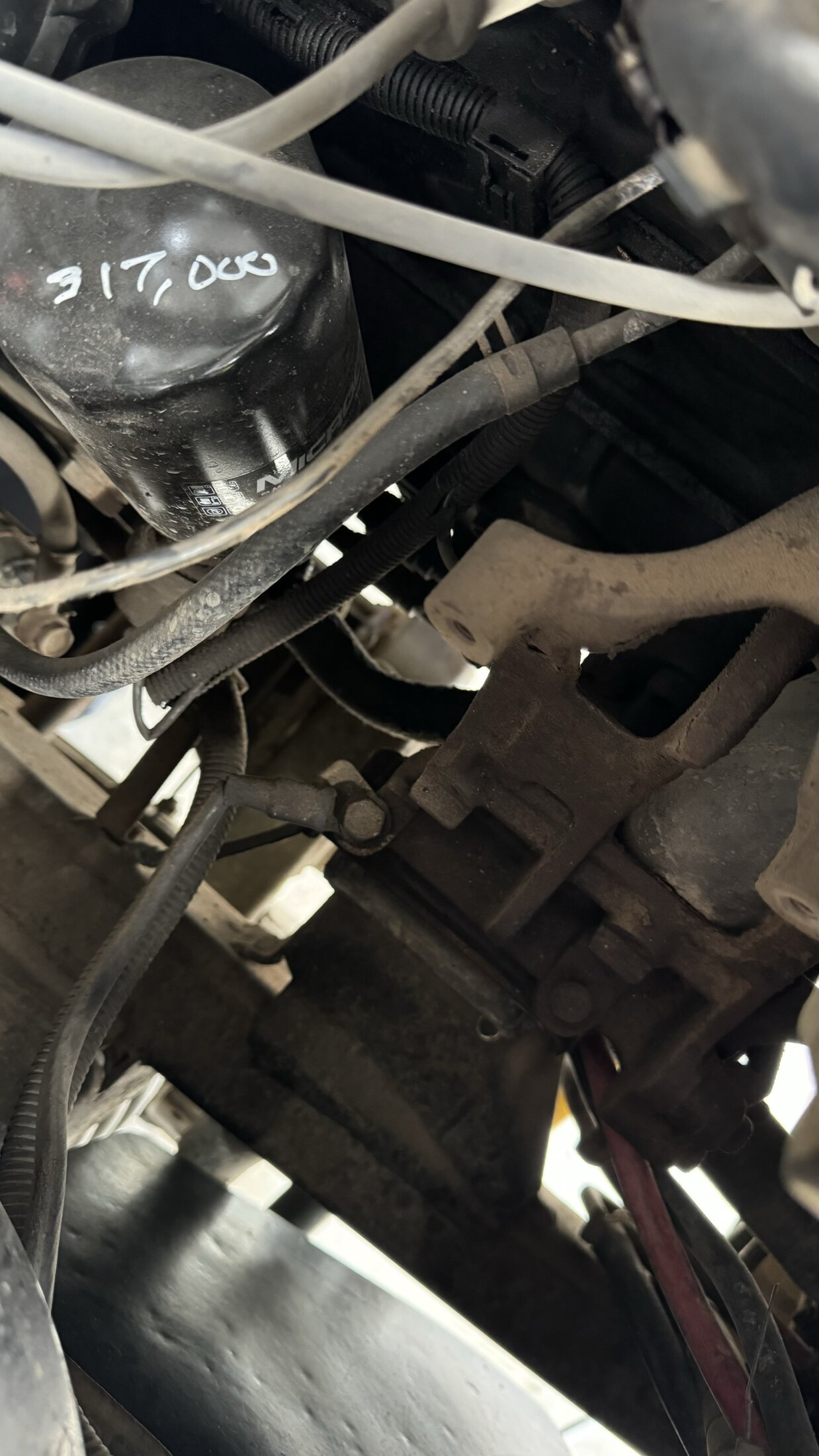

Good morning, I pulled everything apart over a month ago, now I don’t remember where the negative cable that goes to the battery gets grounded to.
Would someone point me in the right direction, please?
Edit:
Does it get screwed down with the other ground at the AC compressor bracket?
Good morning, I pulled everything apart over a month ago, now I don’t remember where the negative cable gets grounded to.
Edit:
Here’s where mine is, my a/c was deleted by the po but it is on that bracket
