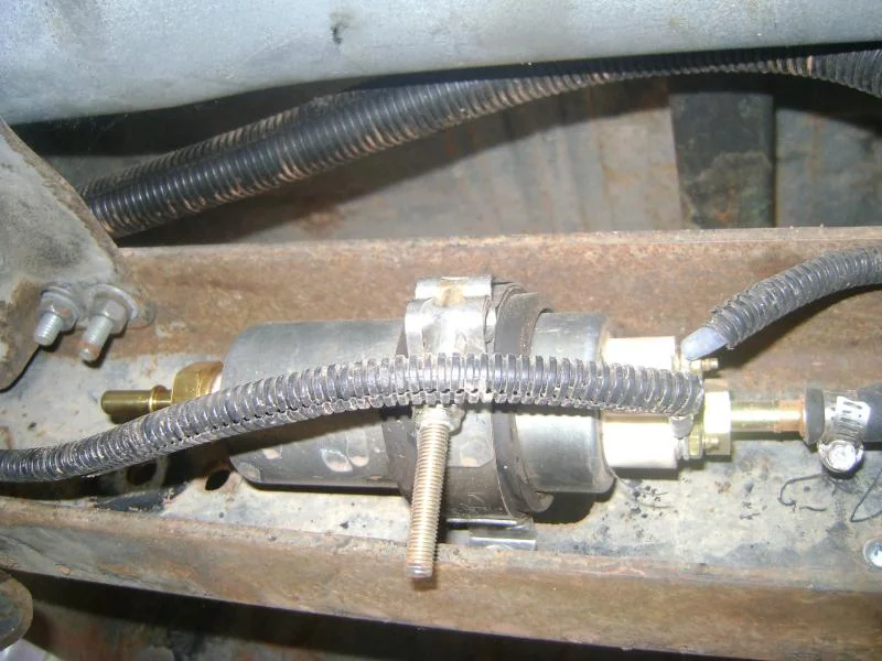

To answer the original post question, I am running the external pump found on the early EFI F-250.
I do not have current p/n or application.

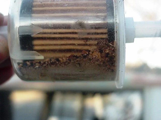

I pre-filter the pump (you should see why! I'll post pics) and run a high press filter in the engine compartment from a Vortec. It has threaded connections, and is cheaper than the 3FE filter.
Do you have any pictures of your pump and plumbing?
Where is this picture from?

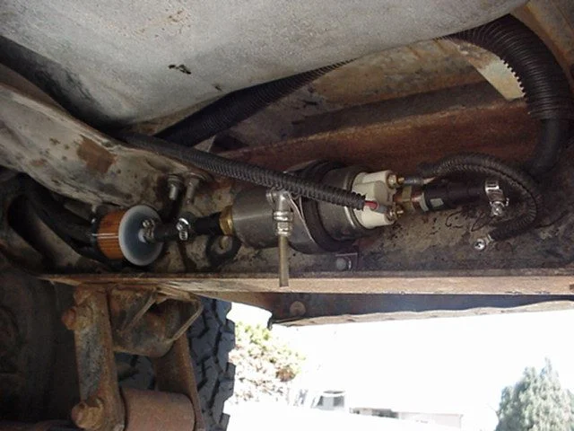

Greg - I have a inline filter...between the tank and the pump. It was a old ford mustang pump. Iam now using a MSD with one fuel filter between the tank and pump. My tank is new, so I decided to just go with one filter.
Here is a very old picture of what the PO of the truck had installed. The Red line was the line to the engine.
attachment.php
This is my pump, obviously showing incomplete plumbing.
Picture is from the underside of my Pig - passenger side frame rail back by the tank.
It was the only picture I had on my computer at work. I'll grab pics of plumbing - complete with pre-filter and grab p/n's for pre and post filters.
