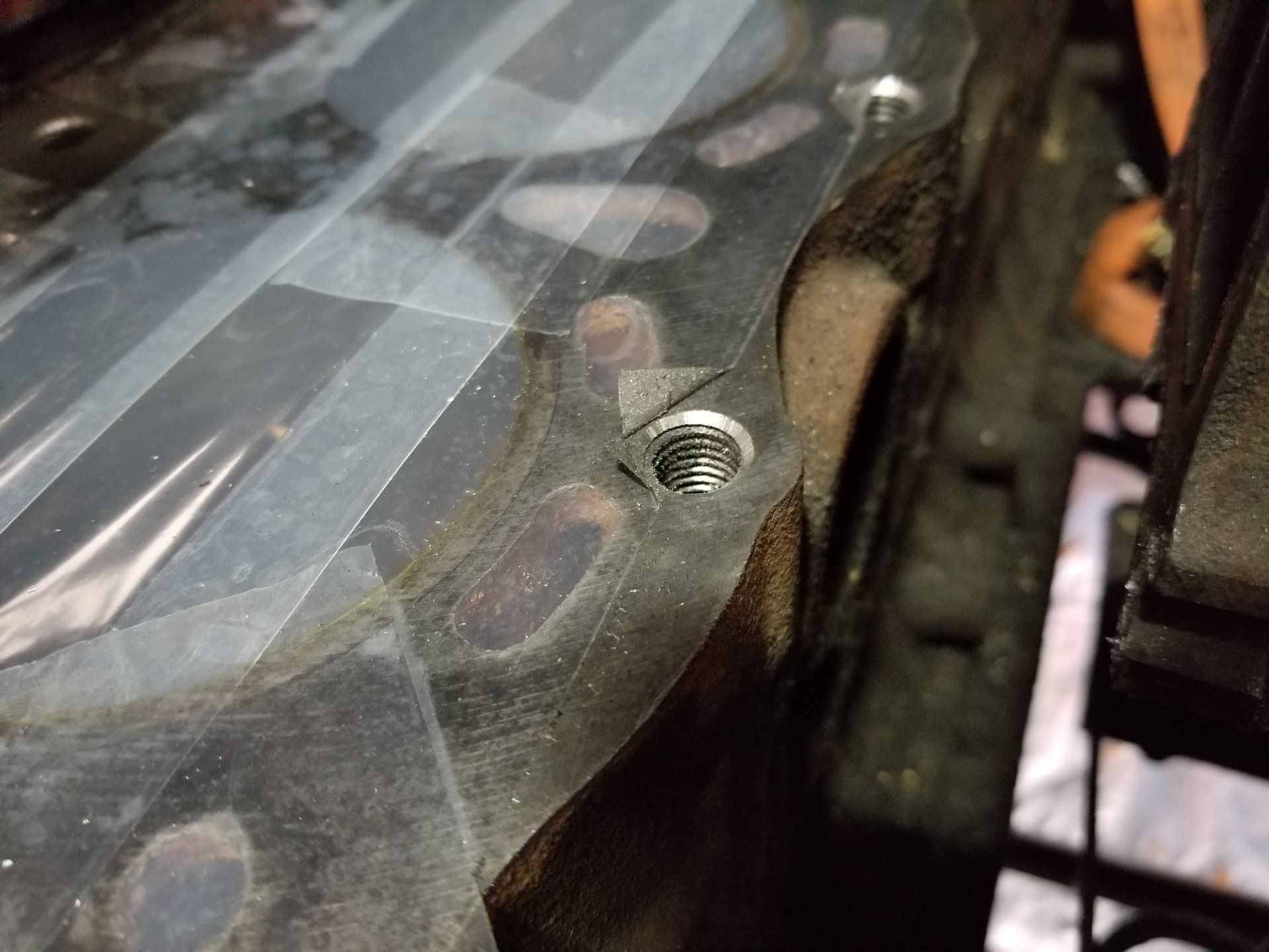

Why did you chamfer the bolt holes in the block unless you had the block decked (which you didn't)?
Fair question.
In short, because Jim said so in How not to build the 2F.
But also because 1. this motor already had HG sealing issues and 2. the countersink bit was $10 and 3. it took maybe 15 minutes to do.
No harm in cutting them, especially since there was zero chamfering done prior and this will be at least the third time a head will be torqued down on this block. I didn't want to chance having the top layer bubble up like in the above thread.
Fair question.
