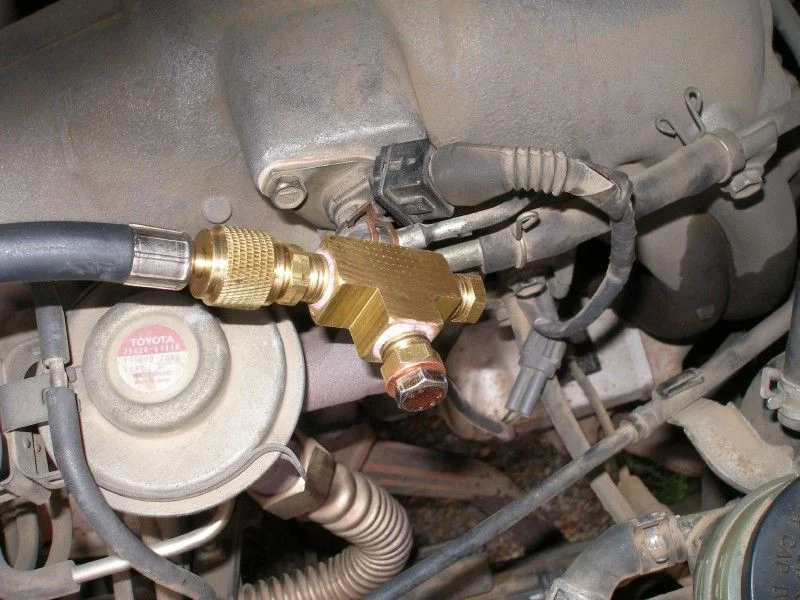

I think this is somewhat of what you are looking for. I guess you could call it a double banjo fitting. I made the long banjo bolt on my lathe and the other parts were fabricated from brass plumbing parts. About $10 for the hardware and another 40 for the pressure gauge.
This is exactly how a factory hookup to the cold start injector is made. I didn't buy one because it cost too much. Just that center bolt is about 90 dollars, if you had to purchase it. It is possible to drill out the center of a bolt but you need a lathe to do it.
I used a cheap fuel pressure gauge and adapted it to my hardware.
Tony

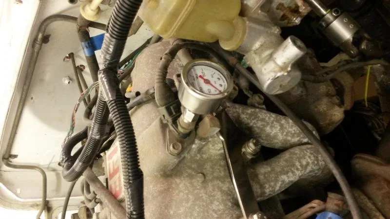

Should be a replacement yes.. ... I need to look at my application to see if it being turned towards the front would be beneficial.. they have a "kit" or you can supply your own pressure gauge. the kit comes with a 90 to turn it towards the front of the vehicle.

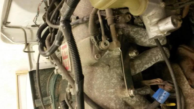

It fits wish I could figure out why phone turns pics
