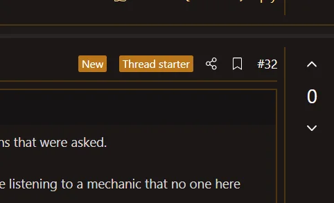

Hey man,
I’ve tried to ask what questions in particular you need answered and I tried answering to the best of my knowledge, when you put all those post #’s I don’t understand what you’re asking, I’m brand new to this forum and website, which isn’t an excuse but I don’t know how to respond when you asked for post #’s haha. But you’re right I need to run diagnostic and let you guys know what I find
Post number is right there on the right top of each post. This is common with most forums. E.g. below is an example - the post you just made above this one is #32.
