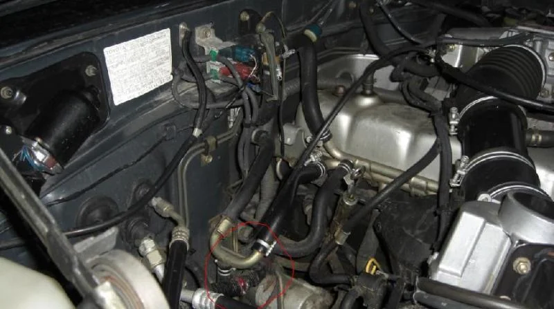

I didn't get a whole lot done this weekend.
I drilled out my flywheel holes earlier in the week.
It mounted up fine.
I installed the clutch, new water pump, and started playing with the smog stuff under the hood.
It didn't quite fit and then I had a forehead slapper moment, this stuff is from an 80. I will install the engine next week then install this stuff to ensure it lines up with the hoses, etc... I will need to bend the bracket tabs a bit and drill some holes in the fender but nothing too difficult at all.
Next weekend the powertrain will be back in the truck. Then I can focus on the little stuff. I will get the exhaust installed next week too.
Frank

I was getting into the heater hoses, I believe I have figured them out. I need a T-fittling to "T" in the rear heater return to the return line.
I used this picture to get a feel for how it goes. I do not have the return line port on the engine piping so I need a T to make up for it. I'll take a pic when I'm done to help it make more sense.
https://forum.ih8mud.com/attachment.php?attachmentid=273561&d=1226370134
