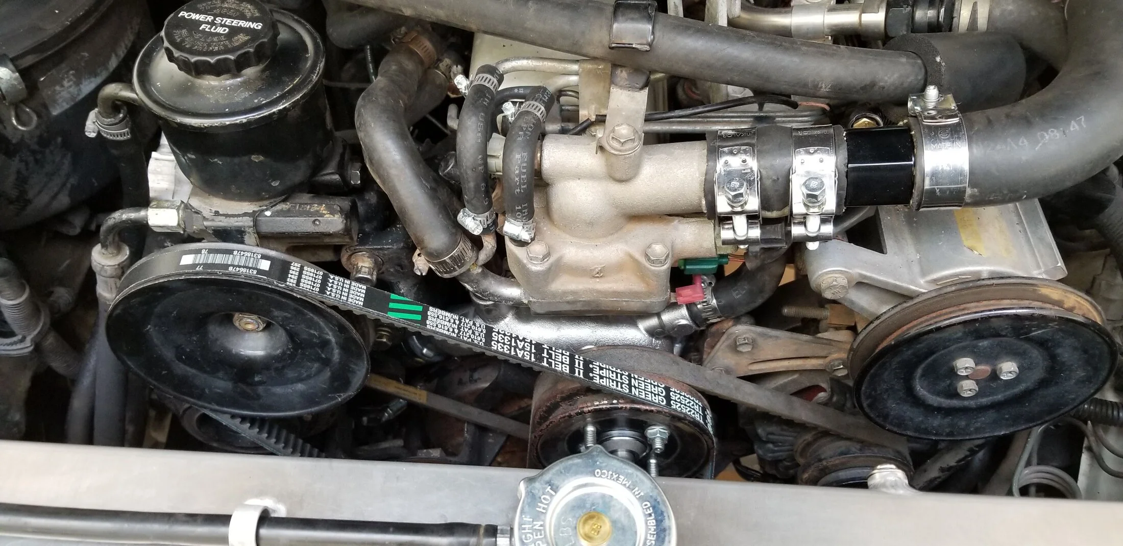

Here is pic of how the belts are routed .
You will have to replace the outer belt that goes around the PS and smog pump with a shorter belt to bypass the pump
Just bypass the smog pump with the correct belt.
The smog pump VSV is only active in very limited situations which I can't remember offhand.

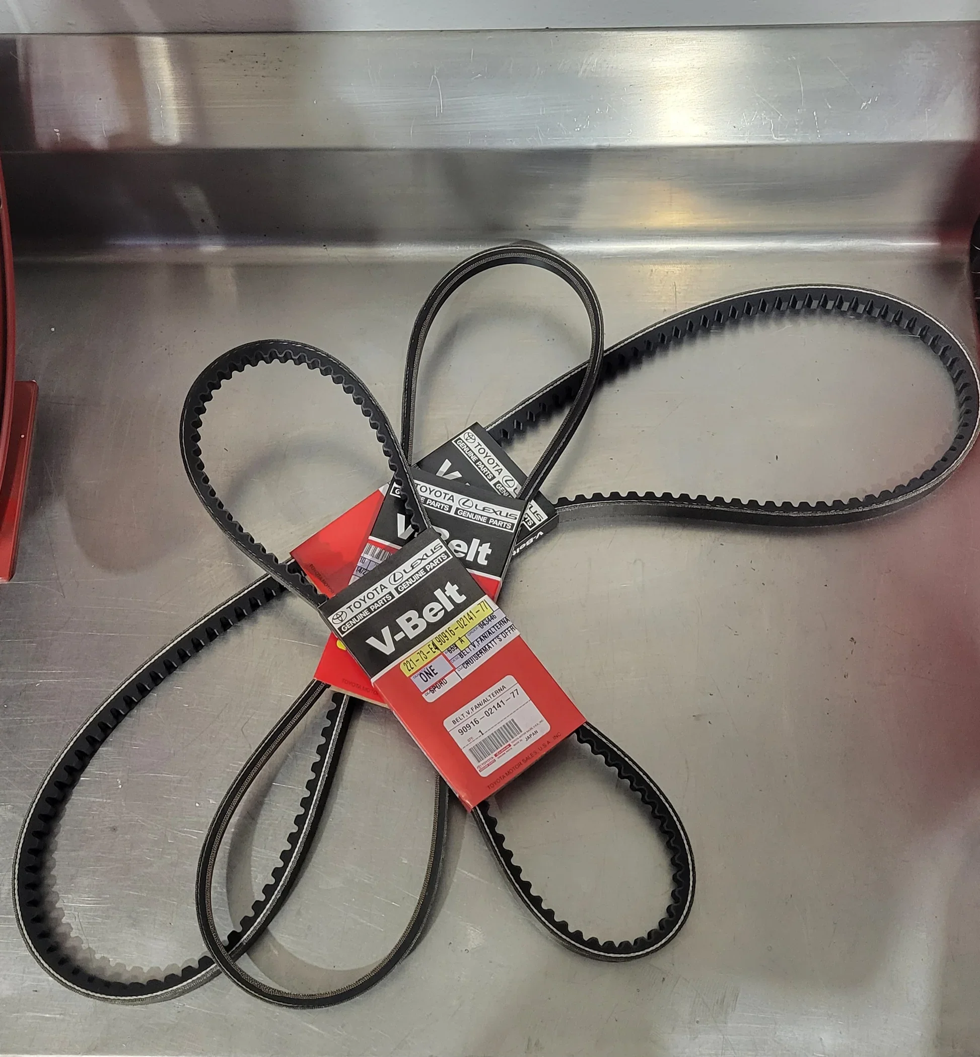

hi ,
your
really annoying high pitched whistle noise coming from the engine you have narrowed down to the air smog pump, your spraying WD40 on the pulley and the noise goes away for about 30 mins before returning. , You are also spraying that WD40 on that smog pump drive belt , its either a super OLD and crusty dry-rotted belt , or a Chairman MOE market region ghetto-grade belt that is incorrect or failing to say the least ........
Dayco brand drive belts fall under
Chairman MOE market region quality for dam sure ....
The link below is what you need and want , for you
r 3F-E , there made in JAPAN , correct COGGED size and the JIS Rubber Spec.s will provide a long-time service life without any WD-40
when your ready for the correct OEM TOYOTA Cogged De-Smog drive Belt , please PM me , i stock them ,
For now @cruisermatt Cruisermatt;s OFF ROAD has the correct 3pc factory drive belt set up you need and want ......
I only run OEM Toyota drive belts on ALL my personal family fleet and my
3F-E , i never have Chairman MOE Spec. Squeals .......
this is the way ........

Thank you! Was wondering if it may be the belt. It is pretty old, no clue what the PO used.
