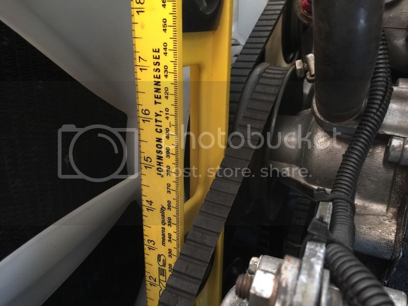

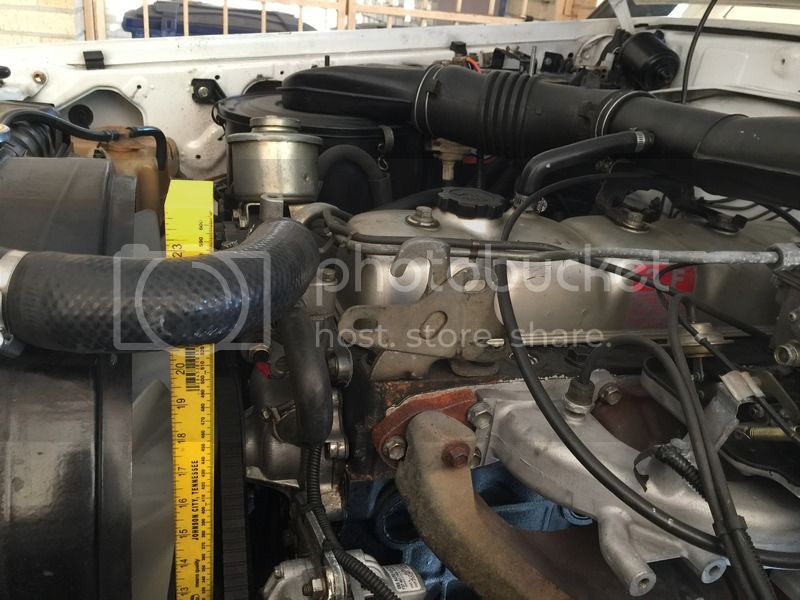

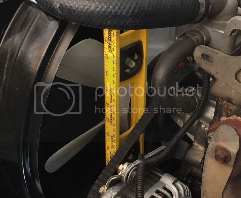

Well, I tried to take the measurements, but the fan shroud and hose is in the way. Hopefully I did it right.
I am going to try again with a tape measure when I get home from work. It is hard to do with all that engine bits and pieces in the way.

A = 13.5 inches & B = 8 inches. It was too hard to take a pic with all the engine junk in the bay.
Thankyou Texas, all good........you just made my day. Using the first photos I guestimated at 14 inches.
