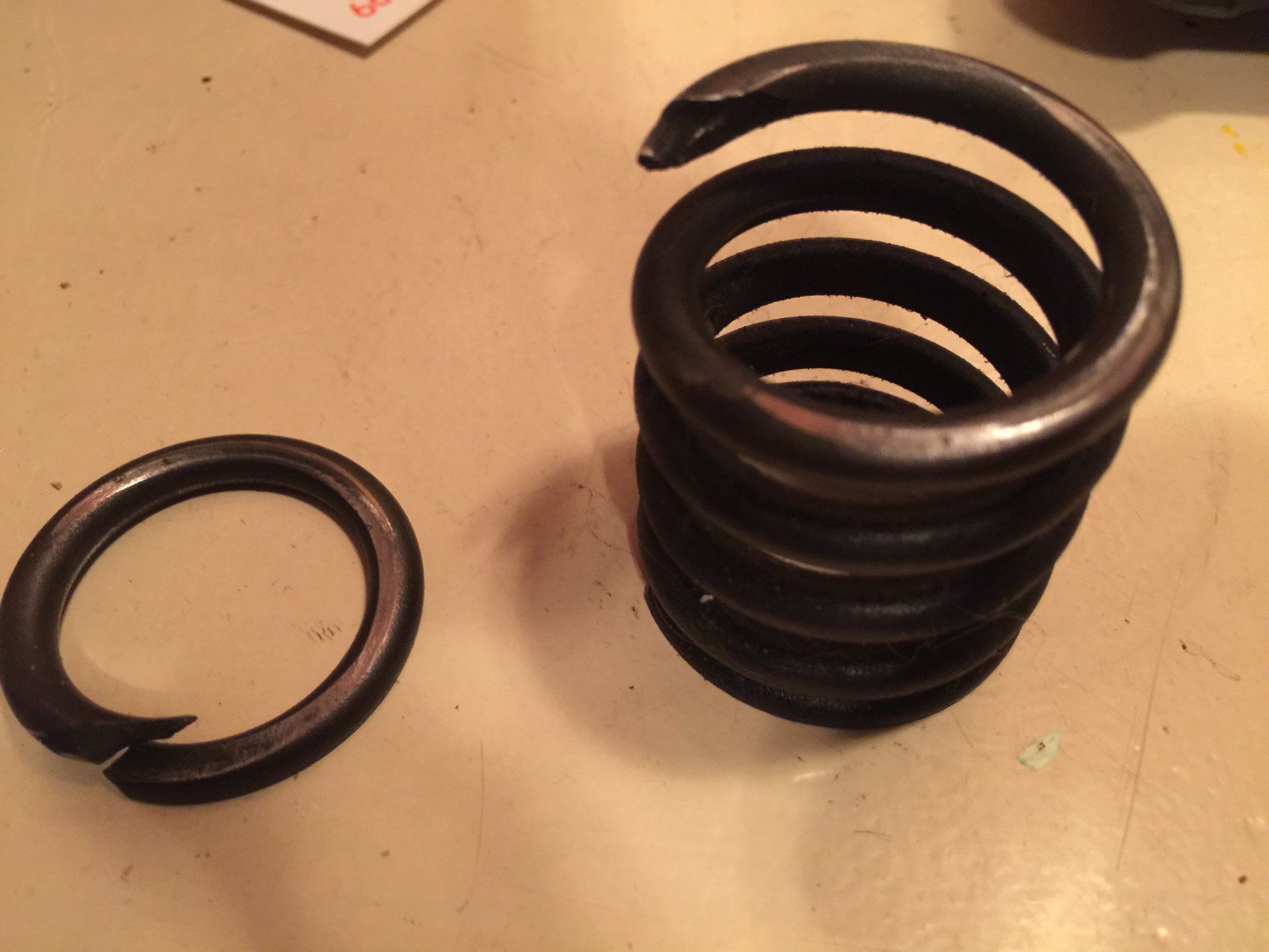

Similar story (no knocking) i had a rough running 3b with decent compression ran super rough at anything over an idle took the head off and found two valve springs broken but still holding the valve closed. Not likely your issue, start with the compression test.

Similar story (no knocking) i had a rough running 3b with decent compression ran super rough at anything over an idle took the head off and found two valve springs broken but still holding the valve closed. Not likely your issue, start with the compression test.View attachment 1588090
Ok thanks for that I'll see how I go removing the head and hopefully I get an answer.
