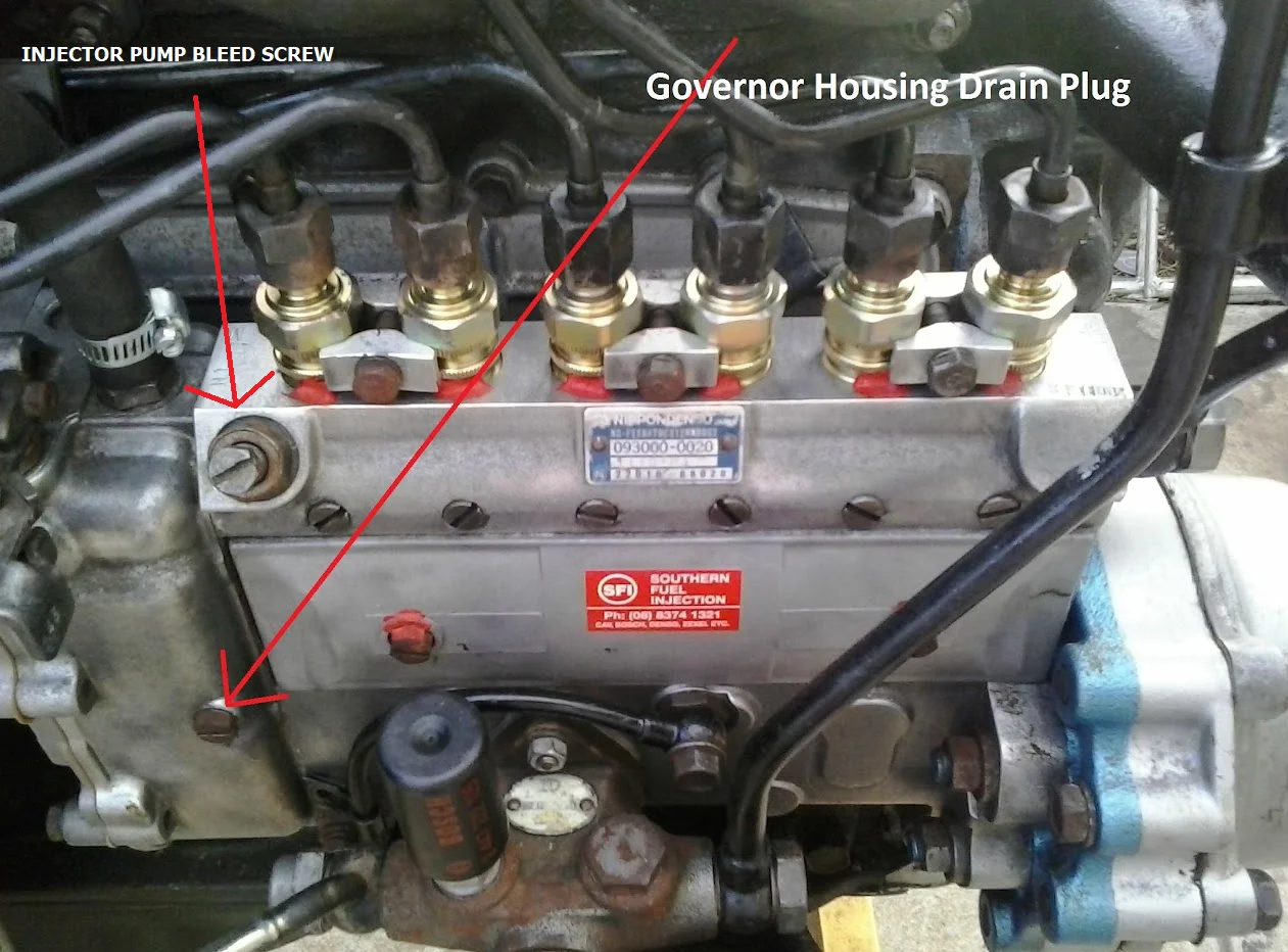

Filter and lines to the IP are filled with pressurized diesel from hand pump and free of air. I haven't found a fuel bleeder on the IP body, only the oil bleeder.
Here's the bleed screw on a 2H.. Has your 3B got one in this position?
Thanks for the above photo. I didn't know that was an injector pump bleed screw, I'll give that a shot first.
