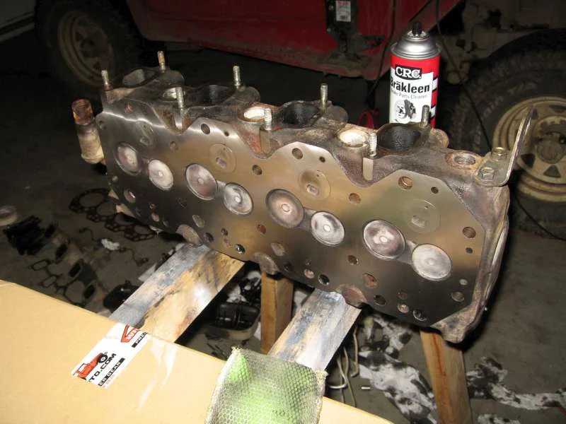

3b head gasket blown
new-fangled multilayer steel head gasket, and shiny resurfaced head!
both now installed but I'm still not up and running. The fittings for the heater hoses, one in the back of the head, and one in the waterpump, were made of s***ty metal and were heavily corroded. I was just ignoring it, but the head fitting disintegrated during the pressure test. Toyota should have replacements on Sat...
obviously this makes total sense, i just simply forgot - don't forget to reset valve clerances after you have your head surfaced! doh!
thankfully no damage, but i was wondering why there was some unusual shaking at idle and why the starter was able to turn the engine over so fast. valves were way too tight, not closing - its a wonder it ran at all.
so thats a tip.

looking at your gasket, looks like you had #1 and #4 combustion leaking which tells me your head was worped.
