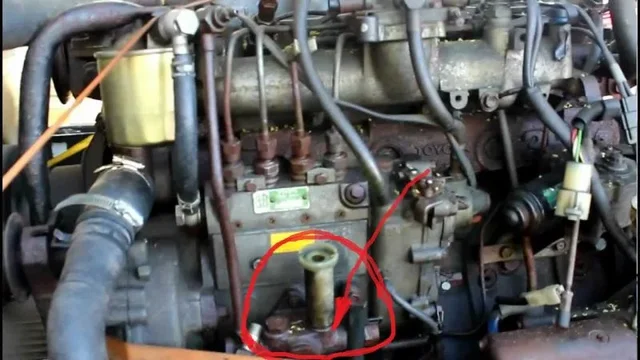

Here is a photo of the item we need. Looks like it is bolted to side of injection pump. One of you diesel guys can chime in and clarify IP or FP.
Thanks

Yes, that would be the low pressure "lift" pump that supplies fuel to the injection pump (the larger pump that the lift is bolted to). Try to find used one somewhere as the are very robust and the need to go new is probably not necessary.

Yes, the priming pump ( the cylindrical hand pump that screws into the lift pump body, which is bolted to the front of the injector pump) is a common diesel part (found on many engines), and easily replaced. While you have it out, look at the manual and check that the lift pump check valves are nice and clean on their matin faces. Anneal all copper ring gaskets, reassemble and run for another million miles.
That's the primer pump. Bosch primer pumps are relatively cheap (under $10 online) and easy to install. Here is one thread of many on this site dealing with these pumps - https://forum.ih8mud.com/diesel-tech-24-volts-systems/696890-leaking-priming-pump-3b.html.

I think you guys have misunderstood.
I think KJohnson's arrow points to the "fuel feed pump" (to use Mr Toyota's terminology) which what the primer pump screws into.

The fuel feed pump used on an 84/85 BJ60 is the same as that used in B, 2B and 3B engines used in Land Cruisers, Dynas, Coasters from 1977 to 1988. So if the old original B-engine is still lying around you can even use the fuel feed pump off that.

Thanks everyone for your comments. The photo came from Alex whom I am helping obtain the fuel system part he needs. I believe lostmarbles is correct in saying it is the lower part in the picture where the tip of the arrow is touching. I need to confirm this with Alex.
x2 the arrow is pointing to the primer and they all tend to leak over time just install the Bosch as mentioned.
The square thing in the back is the IP which is rebuildeble by any Denso certified diesel shop.
I have had to replace the fuel feed pump on my 84 3b, it was leaking diesel into the oil, wasn't sure what was causing this so I lucked out and bought a 3b with a h55. put the fuel feed pump on and my oil looks like oil now not blackened diesel. not sure what happened to it but replacing it fixed my problem
Thanks everyone, I have heard back from Alex as to exactly the parts he is looking for. He wants the priming pump and unit that it screws into which from what I gather is the lift pump. The primer pump sounds like it is available on ebay, is there some place I can order both for Alex?

At least we have it comfirmed that he want this entire assembly (circled in red):
(I don't think it matters which side the primer is mounted on)
And that part number is 22510-56040 PUMP ASSY, FUEL FEED for an 84/85 BJ60.
