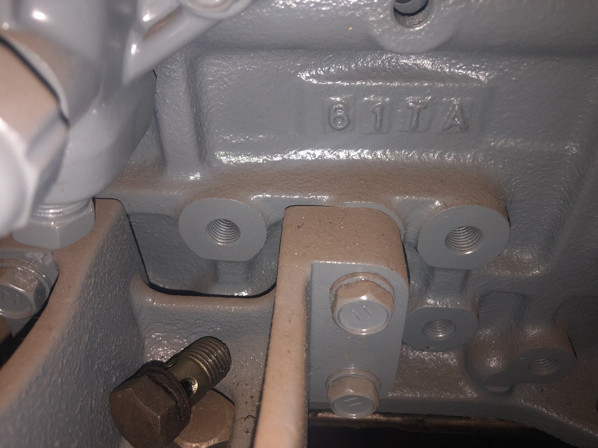

For year identification, I think there a date cast on the right side under oil pressure sender. In this 5 camshaft bearing version, late 84 and 85 have independent thread hole for engine mounts, 86 and 87 they are linked, like a block. (Hope it make sense)

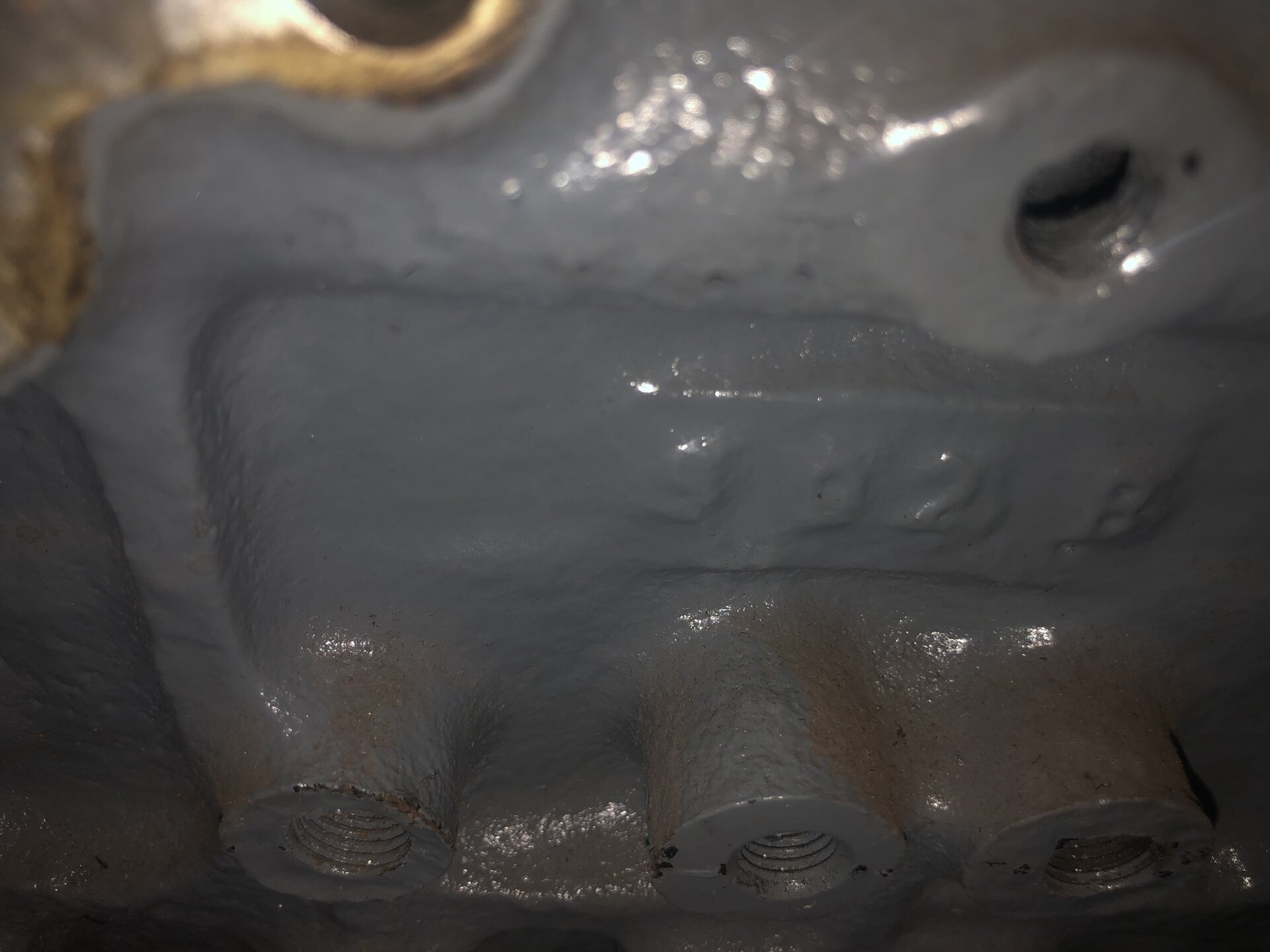

And …there is marks on the bloc, one beside each cylinder. I think that there use to have two size of liners (OEM). Only one available in aftermarket.
No mention of that in 1990 but marks still present until 3BII, again it is explained in the 1982 volume

That the serial number and I’m not sure you can find the date there.
Beno explaine that the date is on the right side of the bloc in his thread, post #132
Thank you, @lacalvett. Super helpful.
I found my casting date in that very spot, just under the oil pressure switch.
it reads 57 | B. That means July-2 1985, I guess.

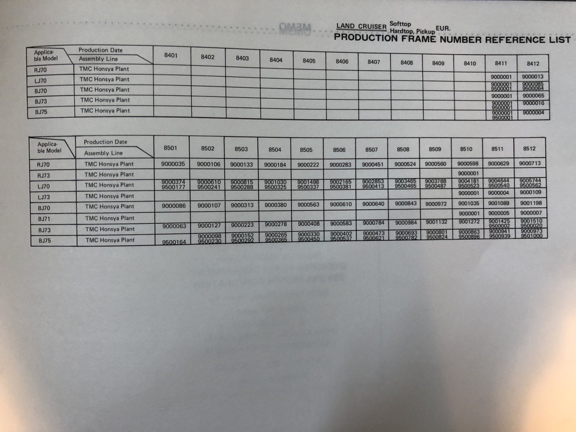

Beno recently posted this.
Accidentally my VIN is just a few items earlier than a VIN that is known to be item 1 from November 1st 1985. So it is safe to say my VIN was assigned October 31 1985.

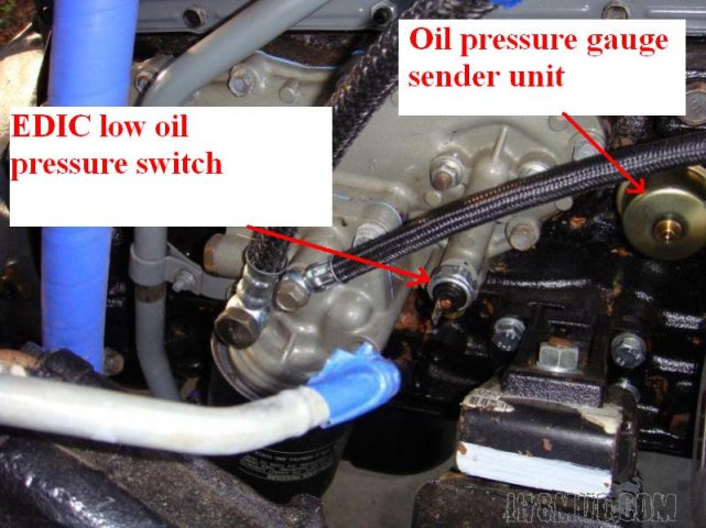

On your picture with date number, the oil sensor is the one for the EDIC. I don’t recall if mine came like this ( Europe spec don’t have an oil pressure gauge) but I think it is the oil pressure sensor for the cluster gauge location. The EDIC should be on the oil cooler. (Not saying that it need to be change, just looking for signs…)
