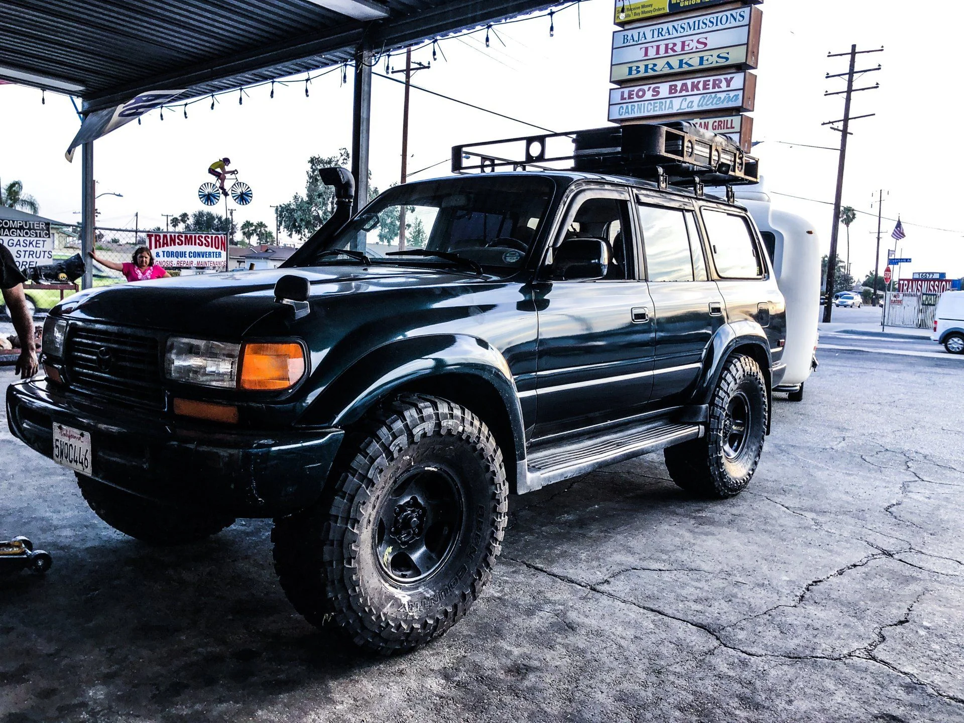

Here's mine with 2.5 OME and toyo open country 385 70 16, had to trim a little where it rubbed. Full lock it will hit the arms, hopefully 2" spacers will fix that.

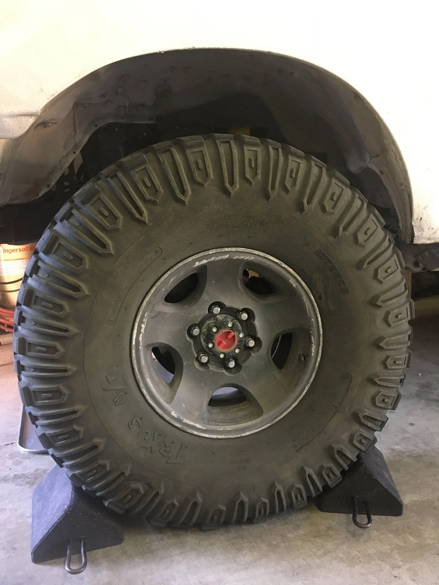

Have tried the TRXuS? I like them a lot. Better on the road than you might expect and awesome off road.
Not thread jack, more of a suggestion.
Mine all balanced with about 6-8 ounces of sticker weights. I tried 10 ounces of dynabeads in each tire in the beginning but that didn’t work out so well. I was surprised to learn that tire shop balanced them with less weight.
They are quieter and smoother at all speeds than any Mud tire I have ever had and grab everything including snow. They are a softer rubber compound though so expect them to wear faster. @Nay and @brosk have had them or currently run them.
