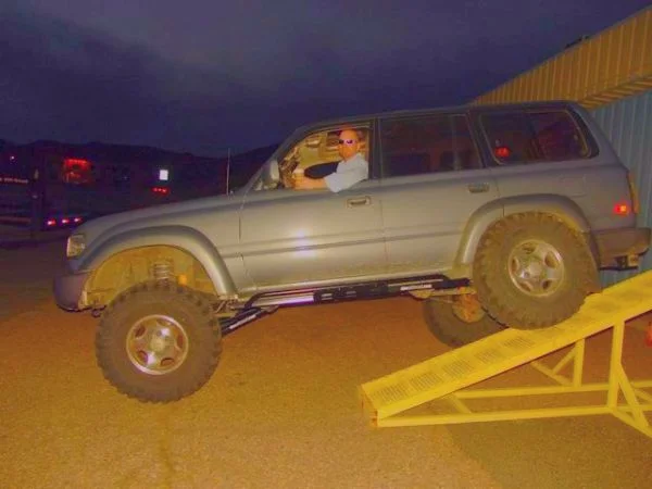

When I had my 80 at Slee's we ramped it, and decided to solve a few of the rubbing issues by adding the longer control arms he has, and then cutting the front bumperettes. Everything was bump stopped down adequately ..
Nothing crazy ass hardcore, but hey .. I'm a Starbuckian ffs :D
attachment.php
Link to the Slee buildup thread .. mucho pics, writeup, and discussion.
:beer: :beer:

So in that pic, no wheel spacers ?
I'm about to pick up a set of those same arms from Clownmidget very soon
I think I may the spacers on in that pic. But honestly I have been trying to remember for a few days. I DO know I took the spacers to the tire shop for an install BEFORE I went to Slee's and the guys came back and said NO GO. There was no way I could drive around with my previous OME lift without mucho rubbing. So I had them take them back off .. I would imagine I took them to Slee's for install after the lift, which would mean this shot includes them.
